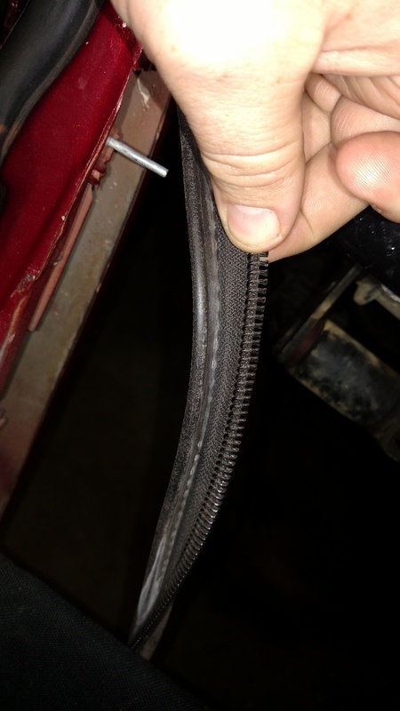

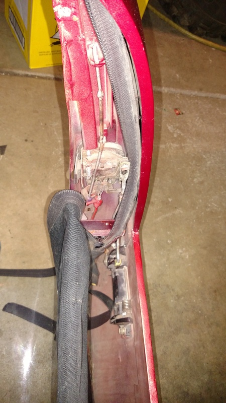

Here is a shot showing the part of the zipper that is captured when the interior panel is installed. Its hard to tell but the compartment door is open, you are looking at it strait on, it is part of the frame and not the interior panel. It also shows the conduit that runs through the bottom of the door and the interior door pop rope travels through that and you can see where it comes out..
Here is a shot of the "piping" (It may be called something else) that I sewed to the zipper so I would have something to capture the zipper by. I just feed/pull the zipper through the window frame channel I made and then capture the rest of it with the interior panel.

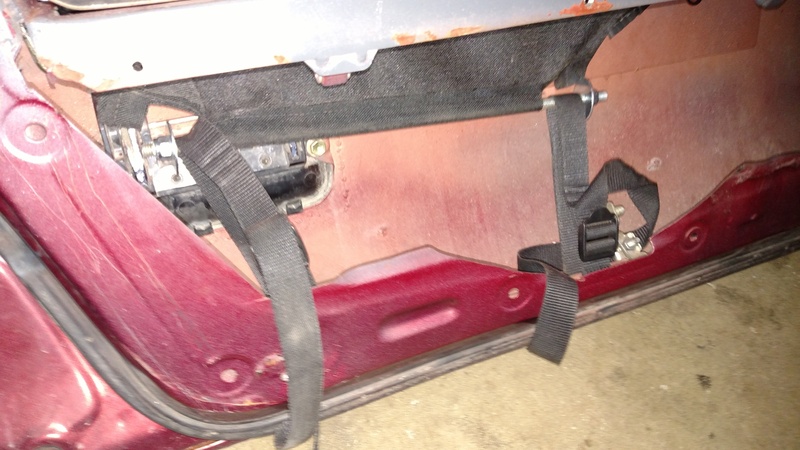

Here is a shot of a couple straps I use to keep/adjust tension on the soft door. I simply tighten these down a little bit, and when I close the compartment door it applies the rest of the tension. I sewed a loop on the bottom, and slid threaded rod through it. Then a couple fender washers and nylocks. The straps wrap under the conduit.
This is a shot of the door linkage. Obviously everything was moved (locks and handles) so it was simply a matter of bending up some links and manipulating them until they were just right. (Im sorry to see I chose the door with ugly door lock/unlock pull link to photograph... The other door has a prettier one, but this works fine..:flipoff2
