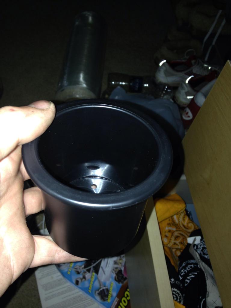

where are you guys getting the spare cup holders to fab em into the doors? my half doors are under construction now and i would like to add those in there.

I would assume they are using a chunk of exhaust pipe. That's what I figured I would use when I get around to making mine.

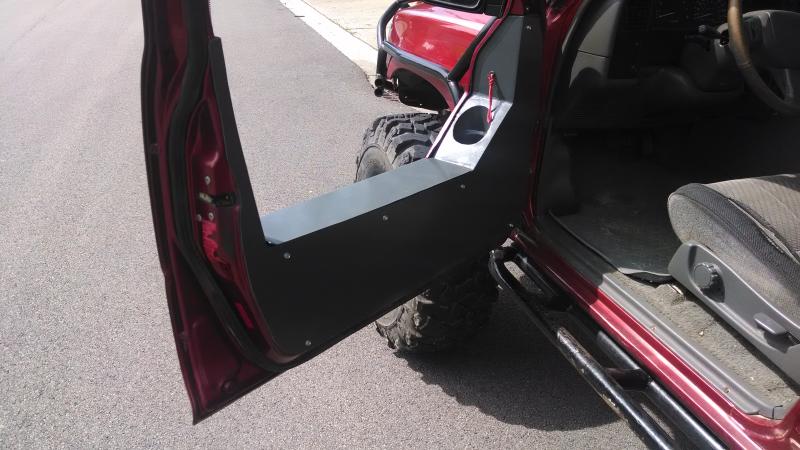

some i made for a friend
mine

Mine are boat cup holders..about $5 or so off ebay

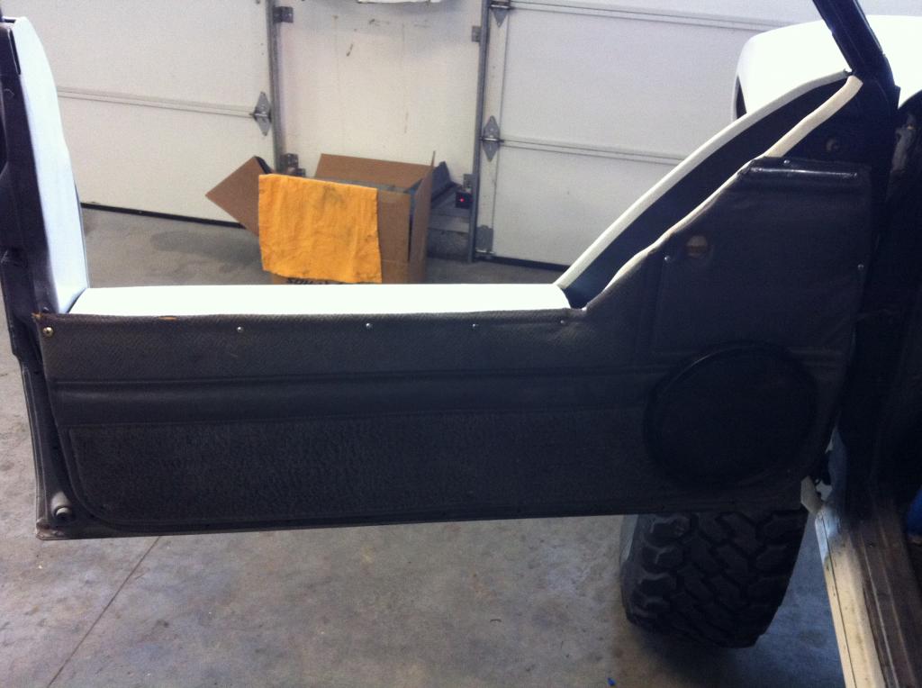

Door handles still work too!Name:  IMG_1145.jpg

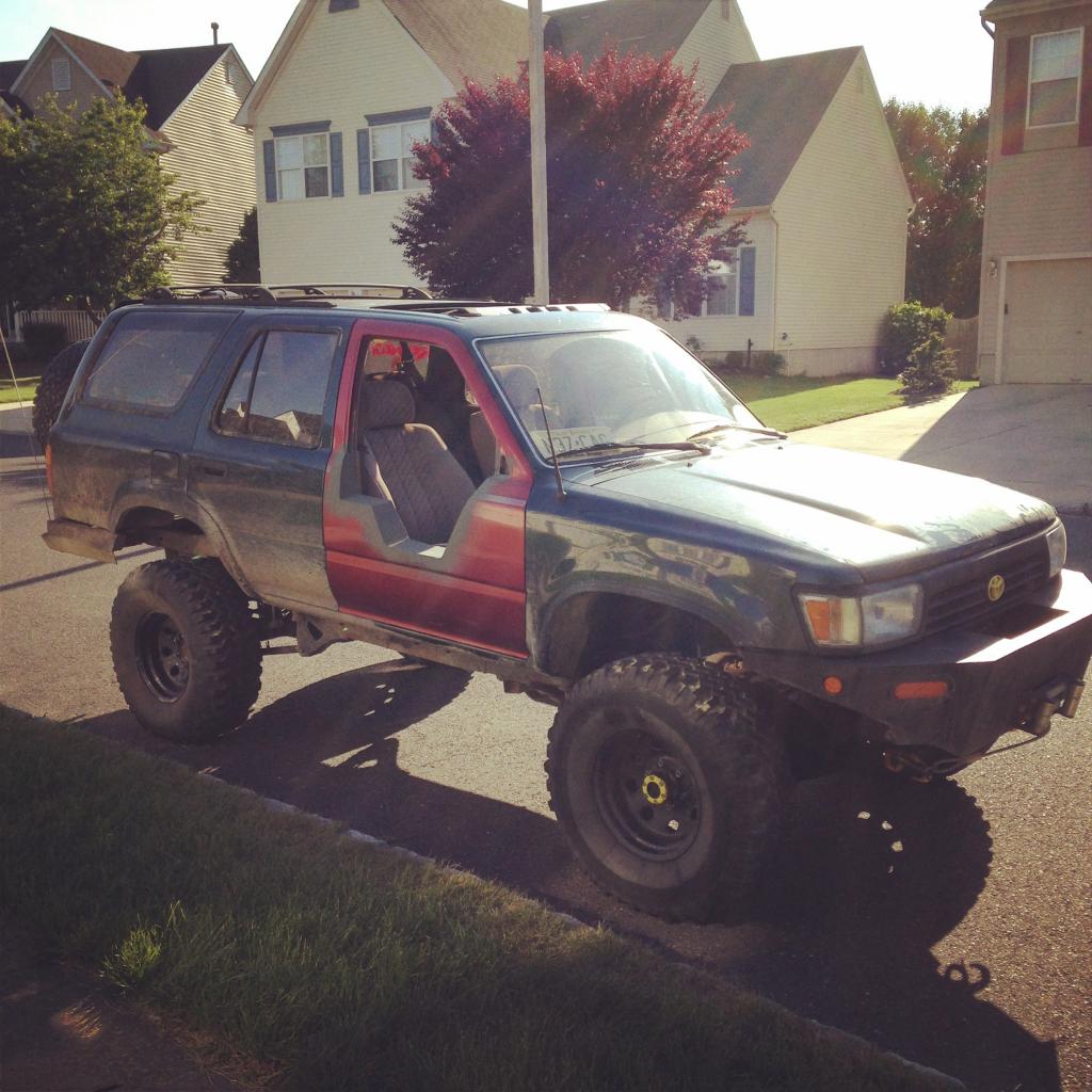

just another half door

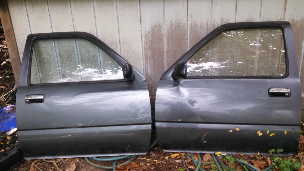

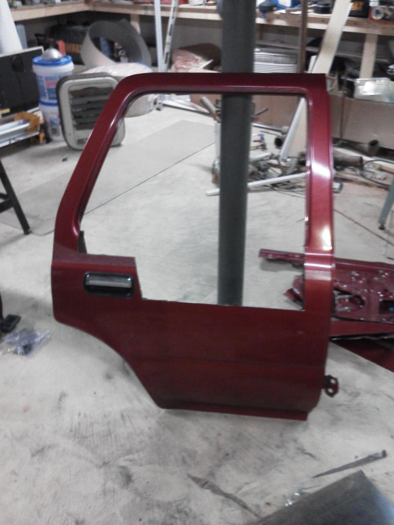

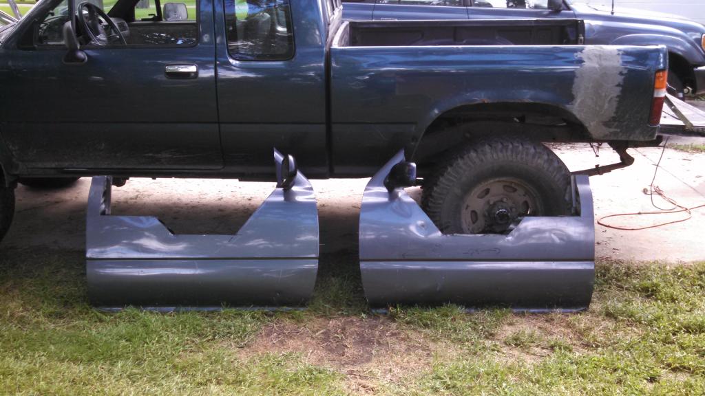

I just picked these up! 40 dollars for the pair!!!

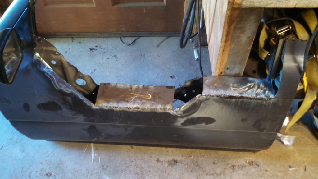

My question is this. How low are you cutting into the door? 8 inches 12 inches?? just looking for a starting point

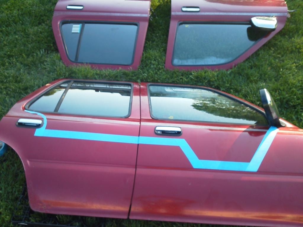

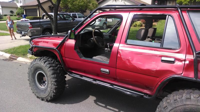

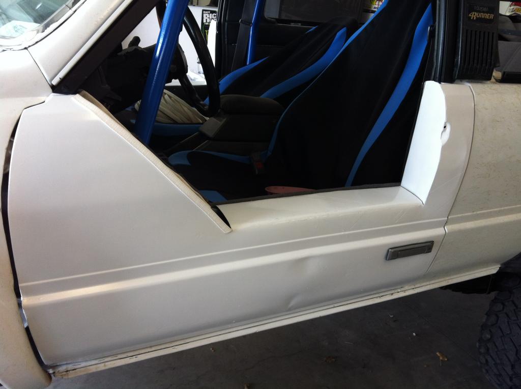

I first make the doors with painters tape to get a general idea of how much I was going to be removing. Then once you have your doors cut you can start to think about things like the latch, mock that up and get the door to work properly then close it all up.

Here is what I have so far:

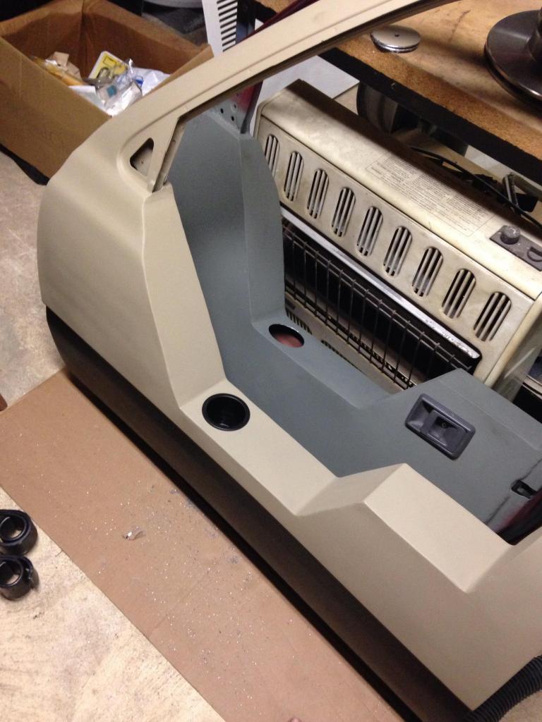

picked these up at a local marine shop today
pretty excited to have these doors done... still a long way off but slowly making head way. I'm about to start on the rears

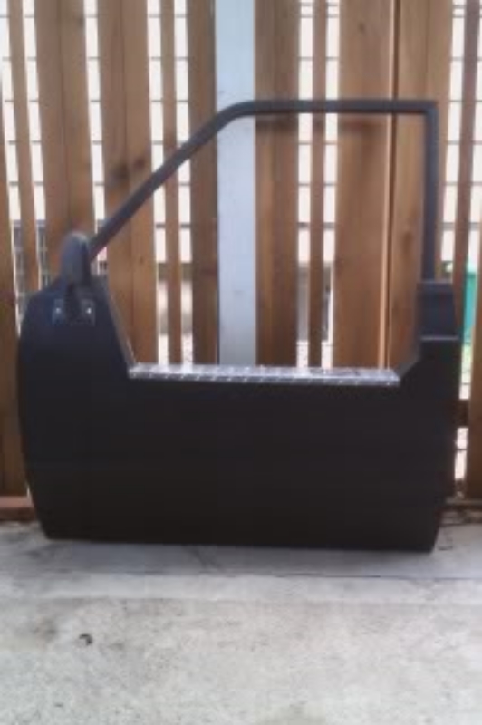

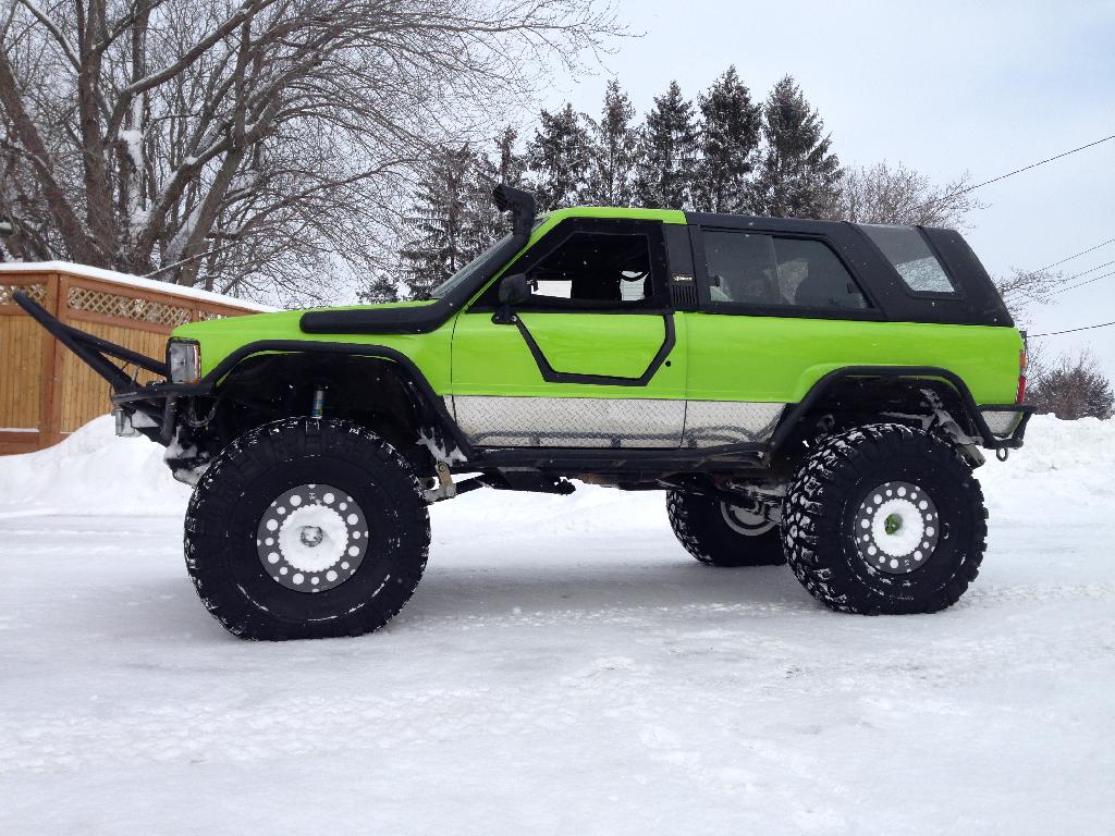

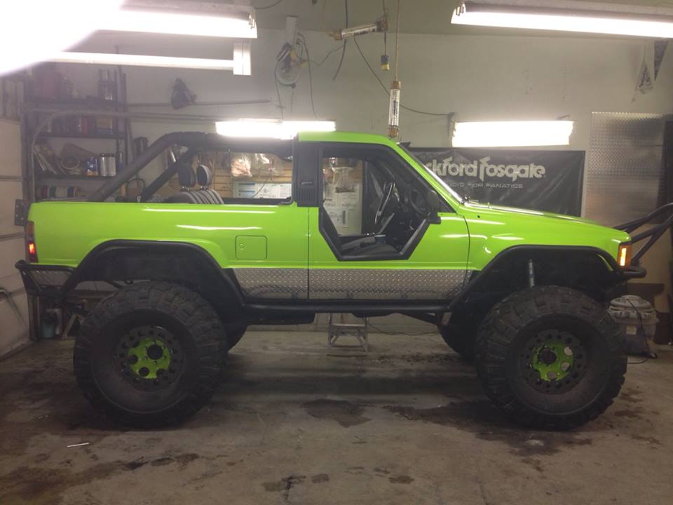

My 1/2 doors
I used the metal to make inserts like a jeep has
I even have windows

Originally Posted by stereoguy
My 1/2 doors
I even have windows
Still one of my favorite 4Runners..
I think I need some rim inserts like yours

Thanks ! The rims are Trailworthy Fab recentered H1's. They are a little heavy but no more loseing abead at any pressure! I usually run 3 lbs and no flats!

[QUOTE=stereoguy;52221132]My 1/2 doors
That's a really good idea, I've seen people make fabric uppers that snap on, but re-using the metal that you cut out of the door to make the inserts, that's genius!

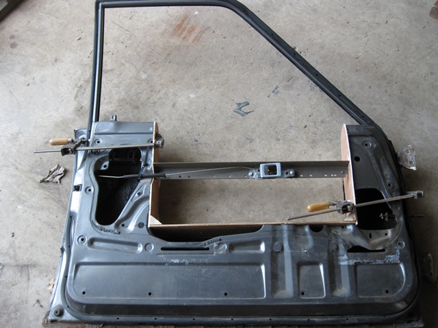

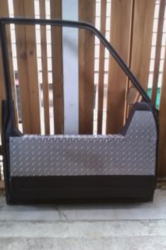

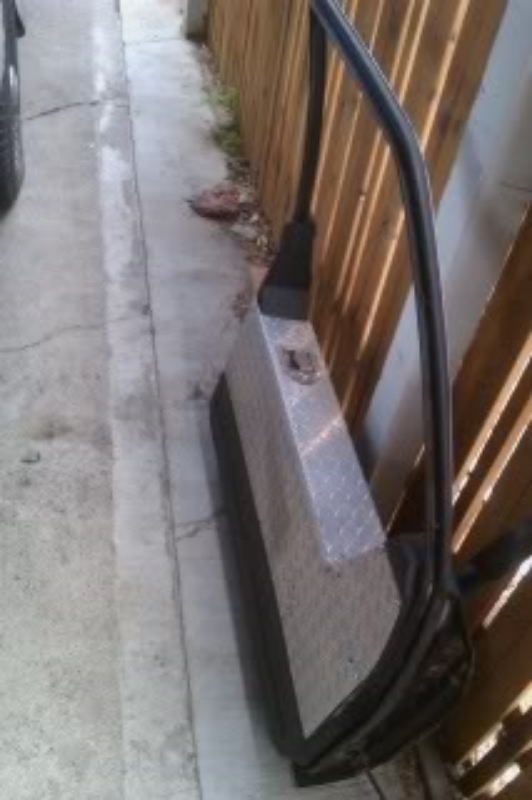

I found some old pics on photobucket of some 1/2 doors I did on my old 1st gen a few years back.
^^^used aluminum diamond plate from an old toolbox for the inner door panels and armrest. The toolbox latches opened the doors. Now I need to get some built for my 4runner before next summer!

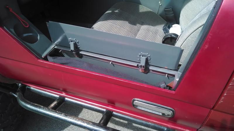

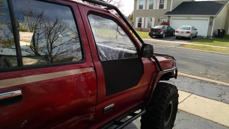

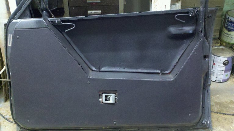

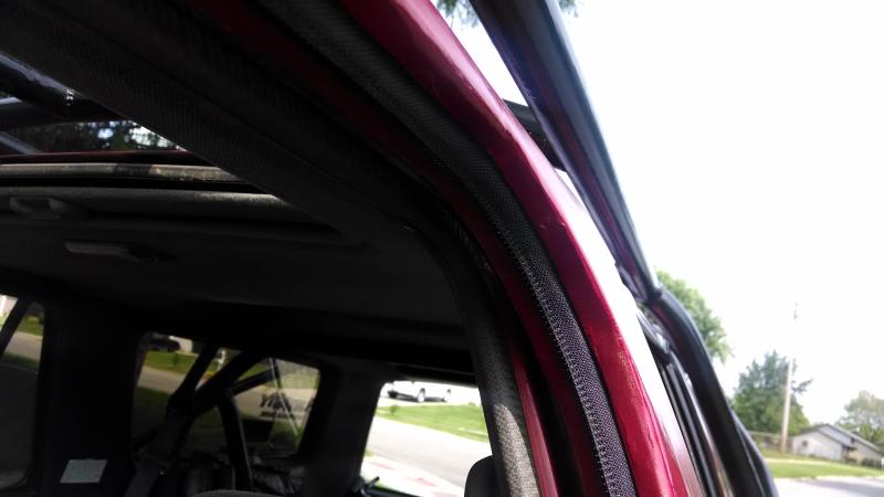

Hi guys, I was asked about these in my build thread, I figured I should post them here...
I made these last spring.
My goal was to retain the functions of the original doors. Locking/unlocking/opening from inside and out. I also wanted a soft door and wanted to do something different from the buttons. So I used a #10 coil zipper and sewed a piece if piping to one side and made a channel around the door for it to ride in. then used 30 ga. clear vinyl and cordura for the door.
Ive never sewn a stitch in my life and after I got a quote for $600 and 8 to 10 weeks from a local canvas shop, I found a 1942 singer 201 for 60$ on CL, and figured it out.
The soft door rolls down and stores inside the door under a hinged door.
They don't rattle and surprisingly, they don't flap at highway speed.
