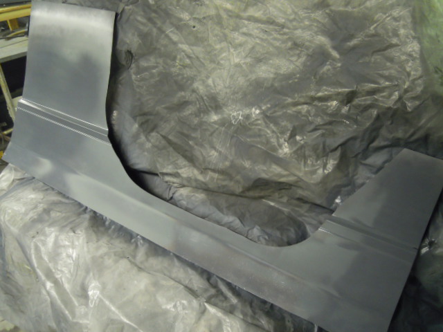

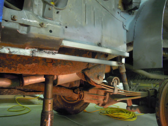

I removed all the rust I could without tearing apart the body mount just in front of the rear wheel well and then strengthened it with some 3/4'' square tubing.
I had previously taken a fitted piece of straight sheet metal to my friend at our local sheet metal shop along with an example piece of the truck body so that he could match the ridges that go along the length of the body. It cost me $60 for the 4x8 sheet and $40 for him to make the bends. They matched perfectly. This is what it looked like...

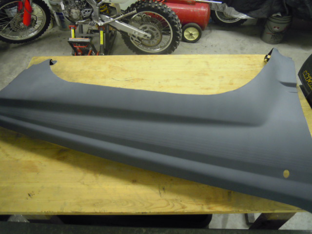

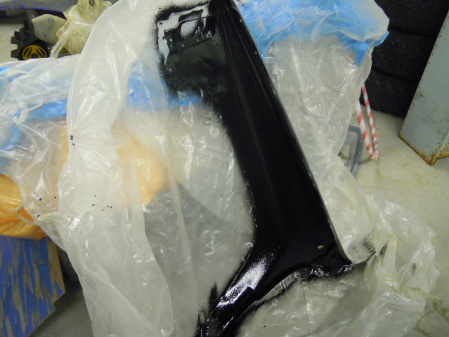

I got my front fenders bondo'd and primed, also coated the entire back side with spray on bed liner...
