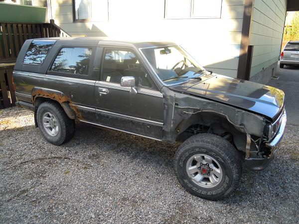

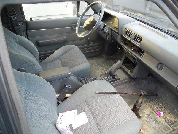

Hi everybody, Im a new member and a first time poster. I just picked up my third 1st Gen 4Runner for $1700. (The other two are long gone). Its a 1987 with 200.000kms, and im the third owner. This thing is bone stock, just like I wanted. The first owner was absolutely anal about this truck, I have every piece of maintenance paperwork from the dealer he bought it from in Calgary since his first oil change. This truck starts up one turn every time and purrrs like a healthy 22R-E should.

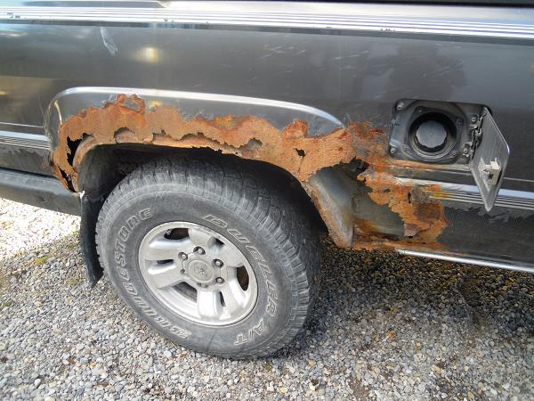

The interior is in amazing condition, the back window works perfectly as does every switch and light, and the canopy has only been removed once in its 26 years of life. Unfortunately the body and under carriage of this beast are covered in rust, it looks bad, but after a close inspection I noticed that its all just scaling and there are actually no holes or soft spots anywhere on the frame or on any vital components.
This truck will be a trail driving truck foremost and sometimes my daily driver, I mostly wheel on tight technical trails and dont spend much time out in the mud or doing serious rock crawling. Because of the extent of the rust, I dont want to invest too much into this truck, so every mod will be done the most cost effective and 'redneck' way possible.

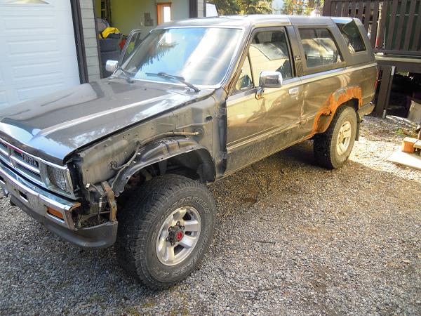

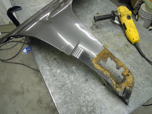

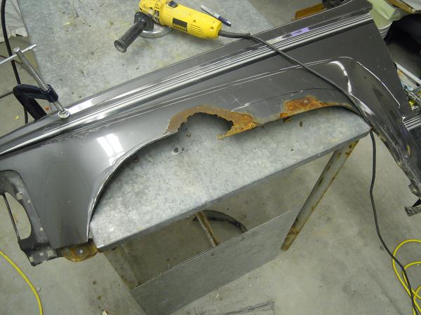

Sawsall + Truck = FUN
Attached Thumbnails Fried onion's 1987 4Runner Rust Bucket Build-Up-4runner-010.jpg   Fried onion's 1987 4Runner Rust Bucket Build-Up-4runner-014.jpg   Fried onion's 1987 4Runner Rust Bucket Build-Up-4runner-016.jpg

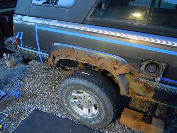

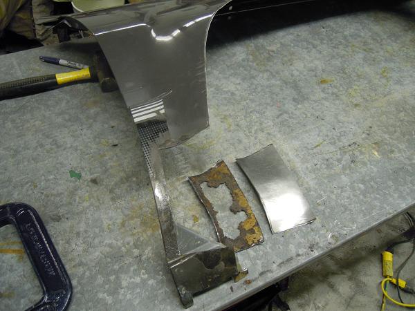

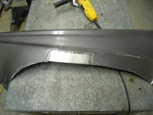

I bought a welder just for this truck and tried my hand at flux core tacking...
Attached Thumbnails Fried onion's 1987 4Runner Rust Bucket Build-Up-4runner-001.jpg   Fried onion's 1987 4Runner Rust Bucket Build-Up-4runner-003.jpg   Fried onion's 1987 4Runner Rust Bucket Build-Up-4runner-004.jpg

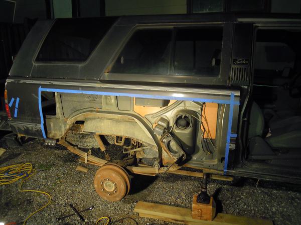

From: Canmore, Alberta, Canada.
This side was alot harder to match the bends in the metal...
Attached Thumbnails Fried onion's 1987 4Runner Rust Bucket Build-Up-4runner-006.jpg   Fried onion's 1987 4Runner Rust Bucket Build-Up-4runner-007.jpg   Fried onion's 1987 4Runner Rust Bucket Build-Up-4runner-008.jpg

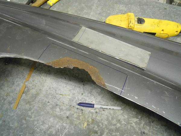

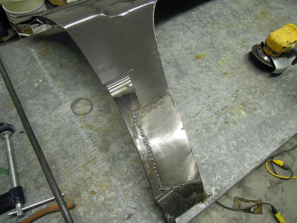

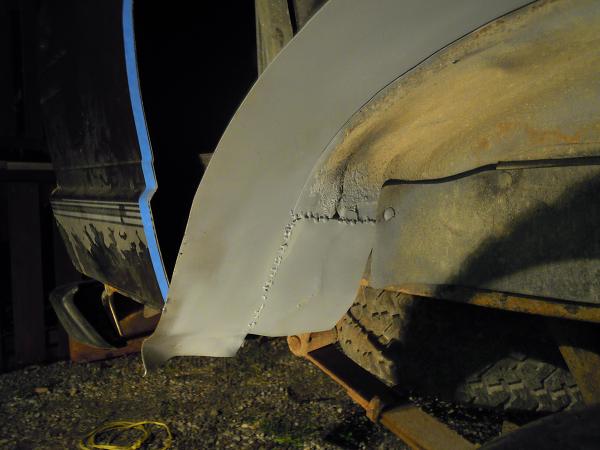

I decided not to bother with stencils since I was removing and replacing so much of the body. Im just going to cut my replacement panel a bit big, take it to my sheet metal guy and get him to make that zig zag bend that goes across the length of the truck, then line up the bend and start tacking.
...remember, im going for fast, not perfect.
Attached Thumbnails Fried onion's 1987 4Runner Rust Bucket Build-Up-4runner-012.jpg   Fried onion's 1987 4Runner Rust Bucket Build-Up-4runner-018.jpg   Fried onion's 1987 4Runner Rust Bucket Build-Up-4runner-031.jpg

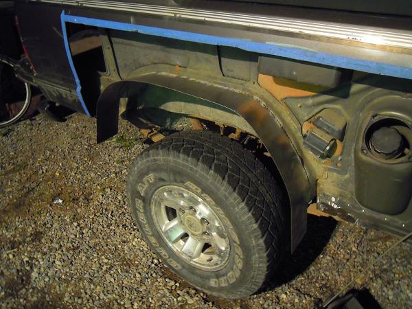

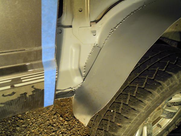

Here i have my new, deeper wheel well tacked in and primed.
Attached Thumbnails Fried onion's 1987 4Runner Rust Bucket Build-Up-4runner-041.jpg   Fried onion's 1987 4Runner Rust Bucket Build-Up-4runner-049.jpg   Fried onion's 1987 4Runner Rust Bucket Build-Up-4runner-052.jpg

From: Virginia
Wow. Nice work. Had you ever welded before? It looks good. Is it a 120v flux core welder or 240v?
Old Oct 26, 2013 | 08:57 PM
Fried Onion's Avatar
Joined: Oct 2013
Posts: 14
It's a Lincon 120V - 140amp, it does flux and mig... works great.
I've never welded before and I've never done body work before, I'm sure if a professional looked closely at my work they'd have a good laugh! I just need it to pass inspection for my insurance company... apparently they dont like to see basketball sized rust holes in the vehicles that they insure. If it lasts five years without falling apart, I'll be happy.
