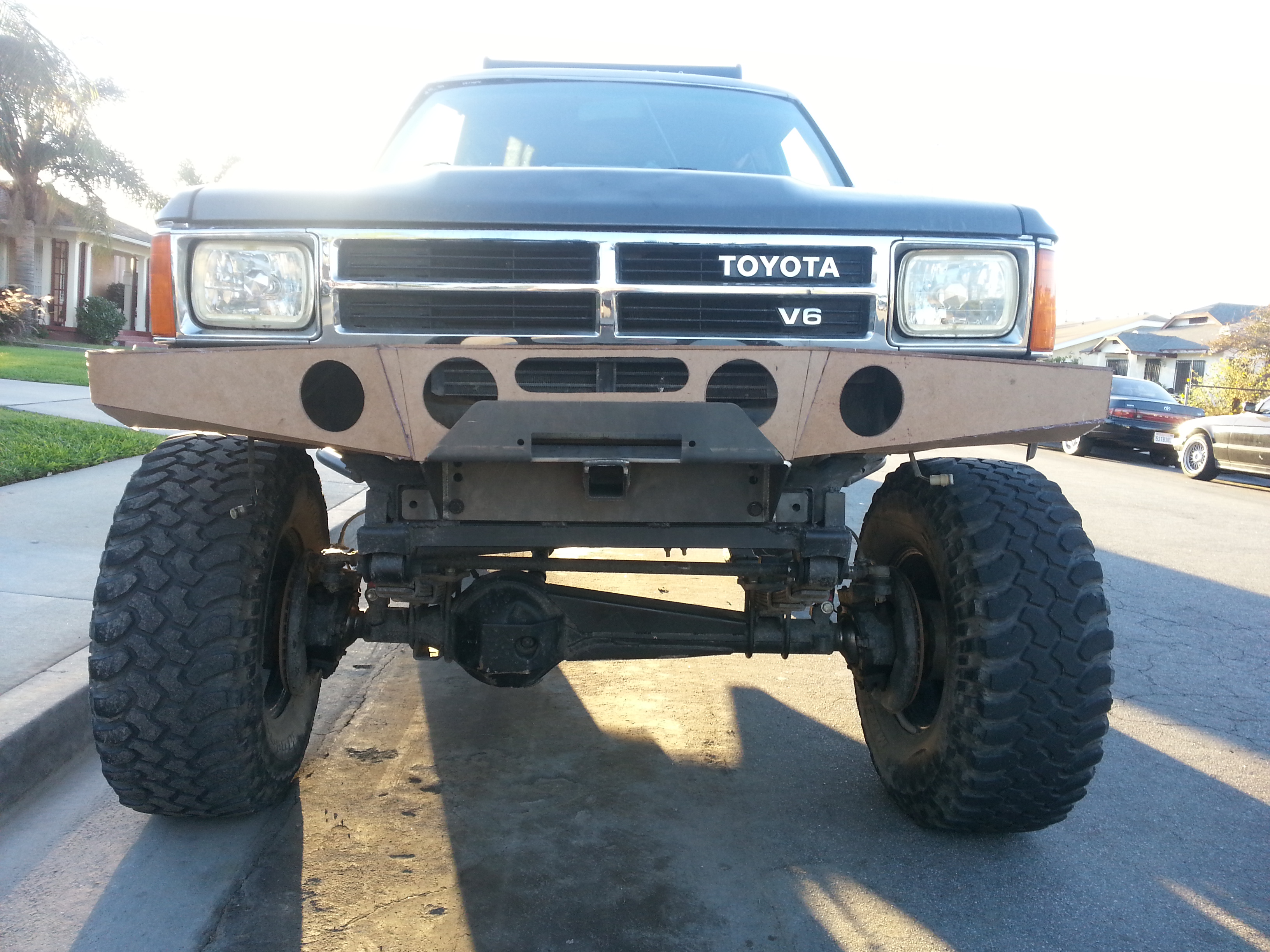

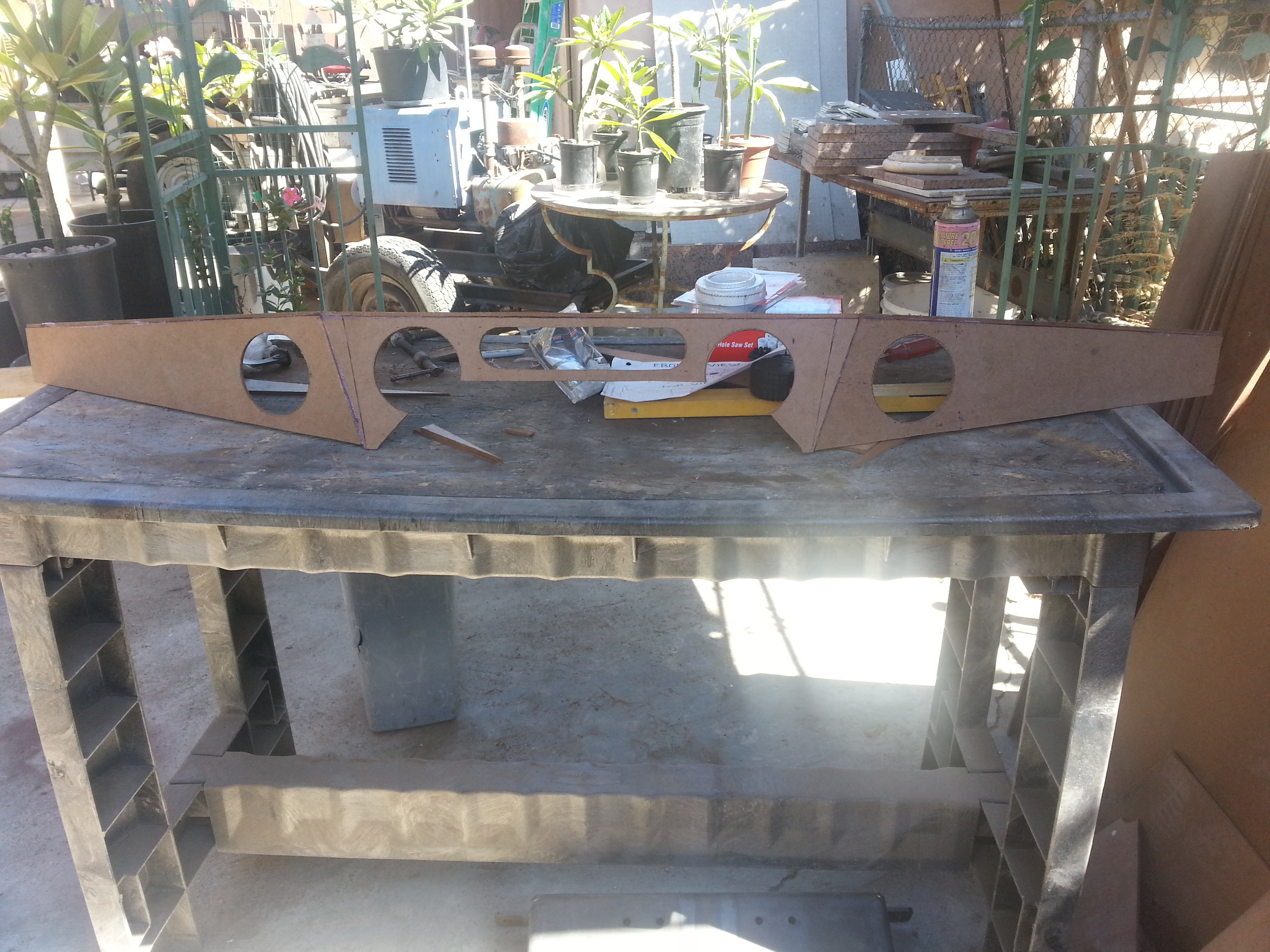

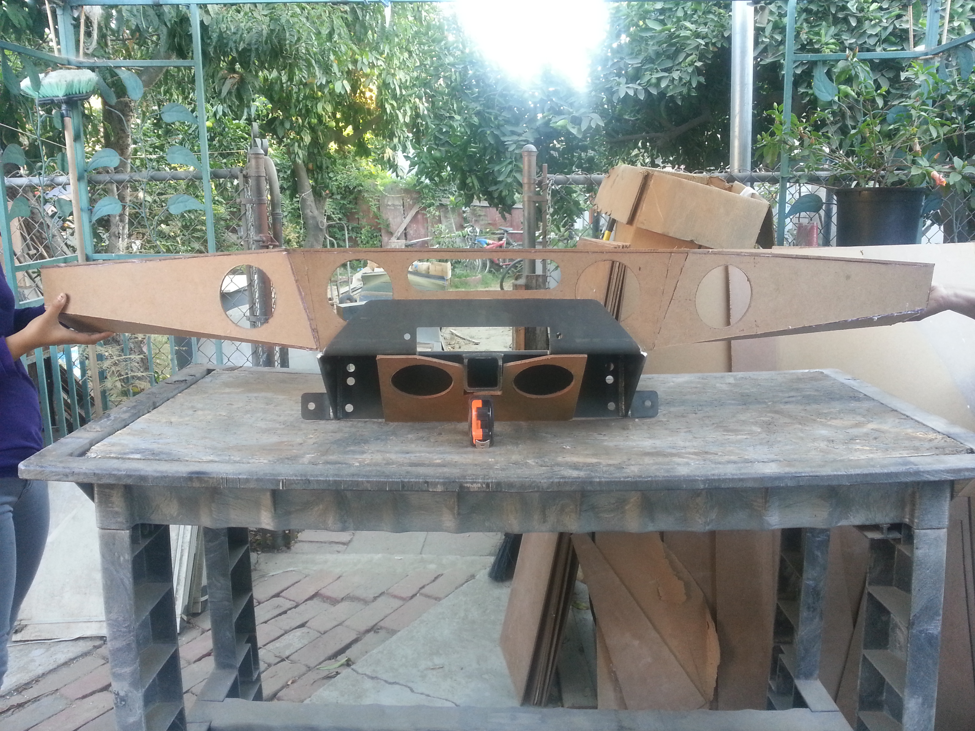

Yesterday morning after looking at my center bumper piece and measuring then looking back and forth
and i realized that i was off by 2 inches off the top side.
cant start off making problems so soon lol. all good i fixed the piece making it 22" at the bottom and changing the top from 24" to 26"

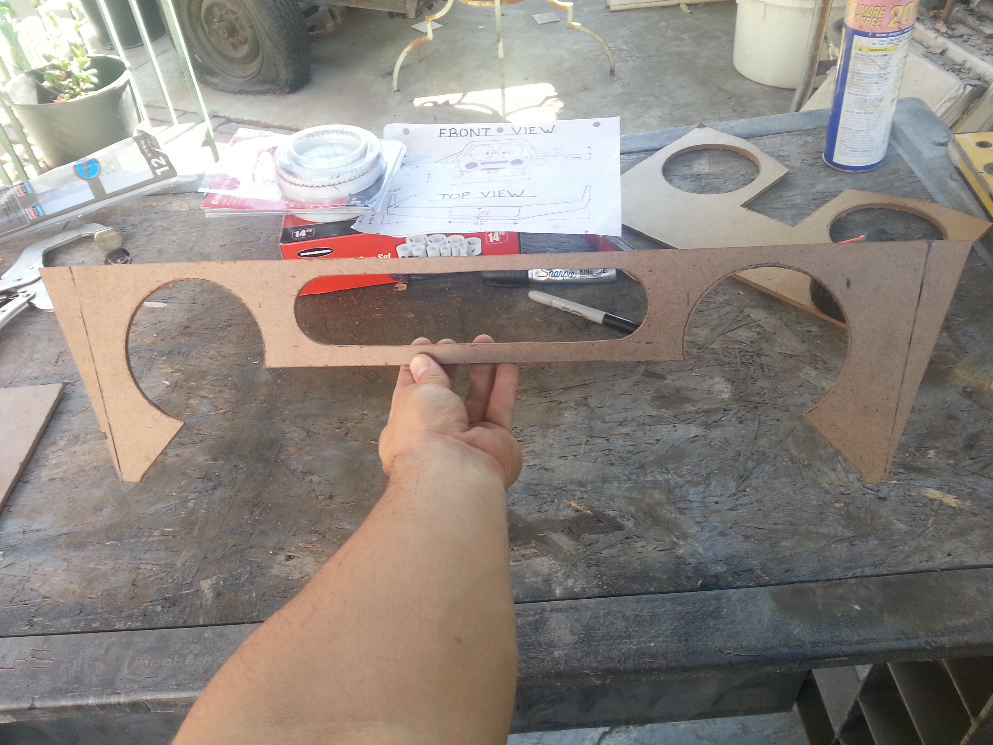

Outlining/centering the LED light holes.
Most of my pieces cut out already.
She be coming along nicely!

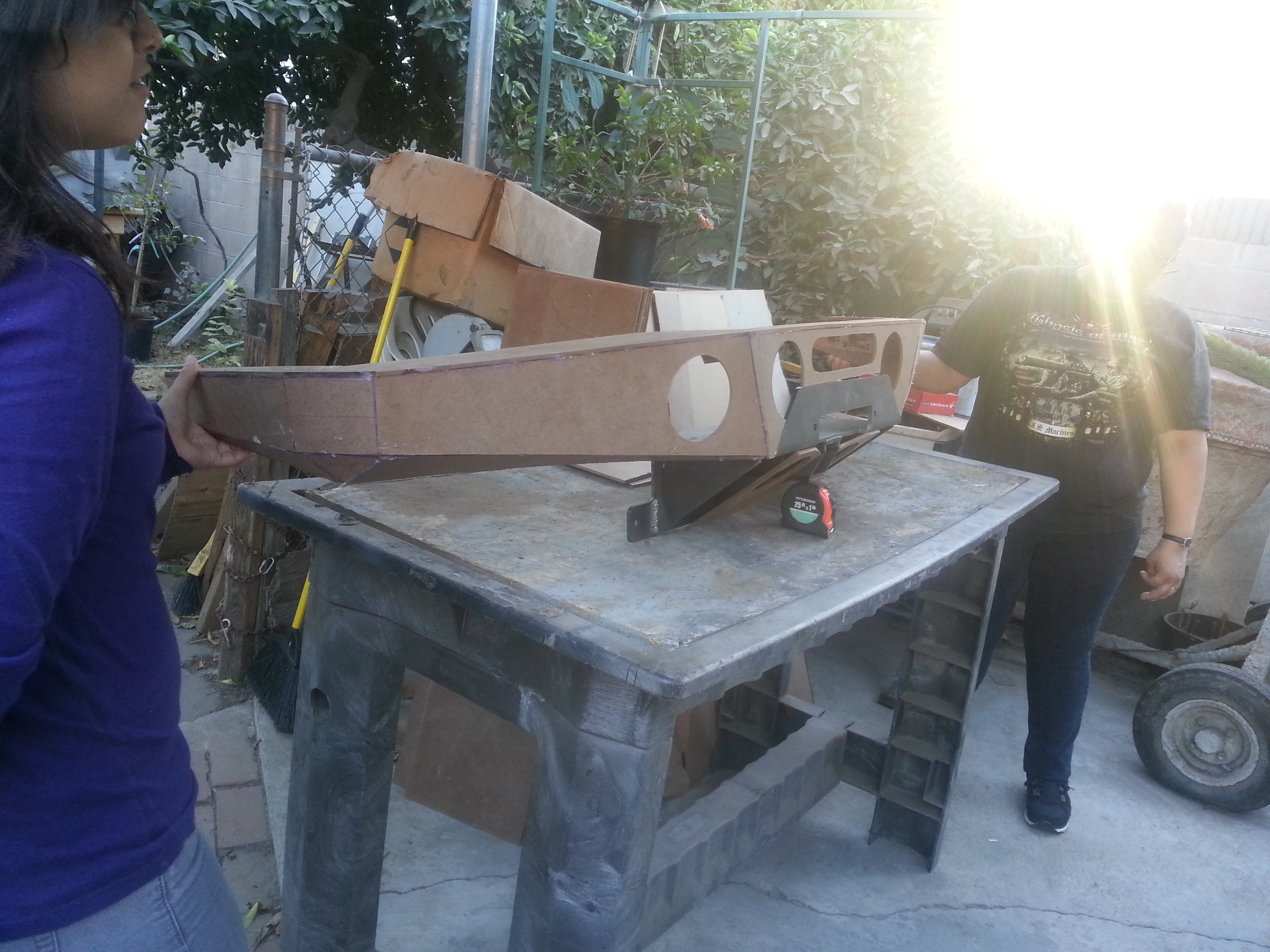

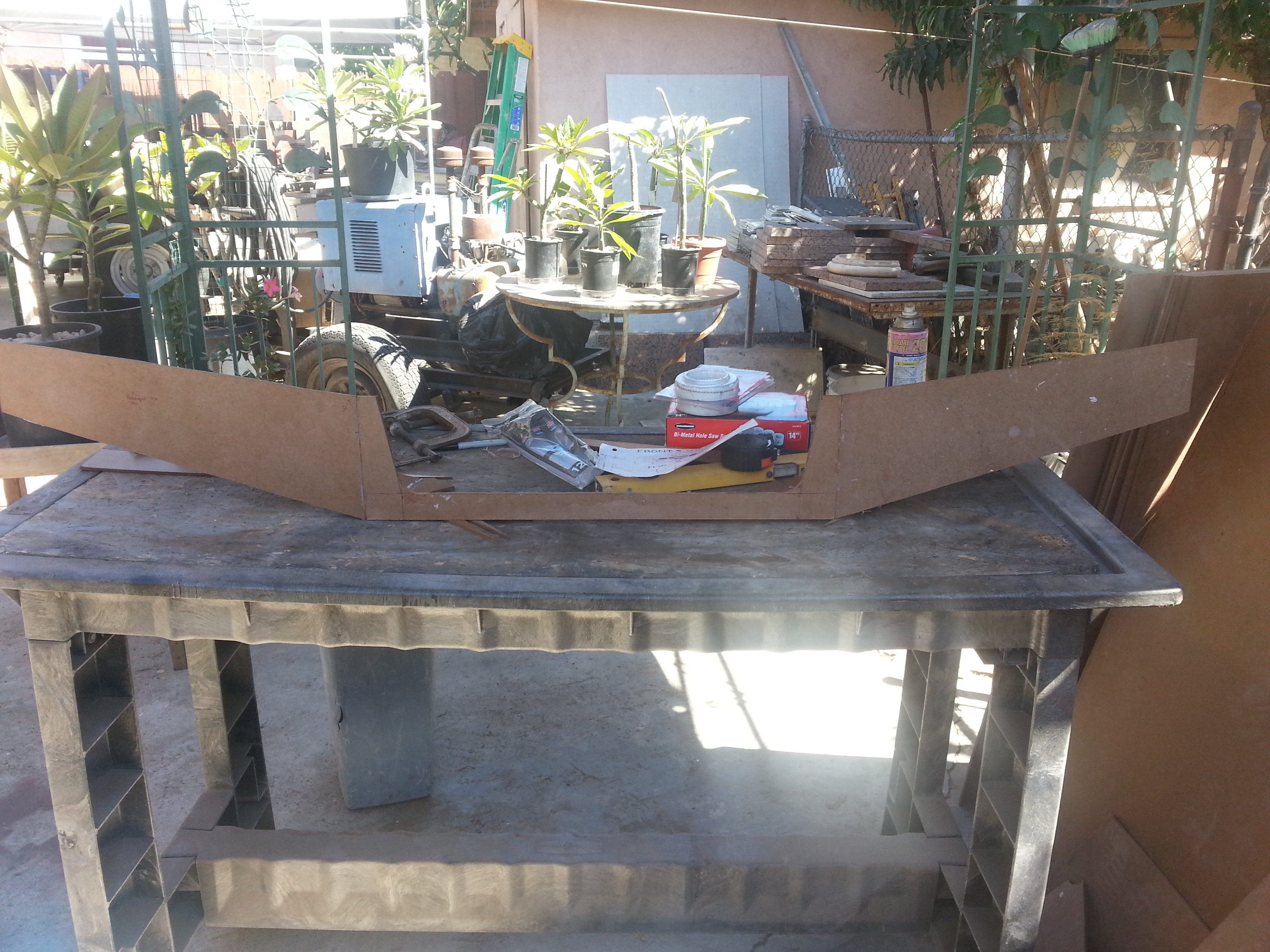

Side. I had to measure out the winch to make sure the center top piece cleared the sides. It did

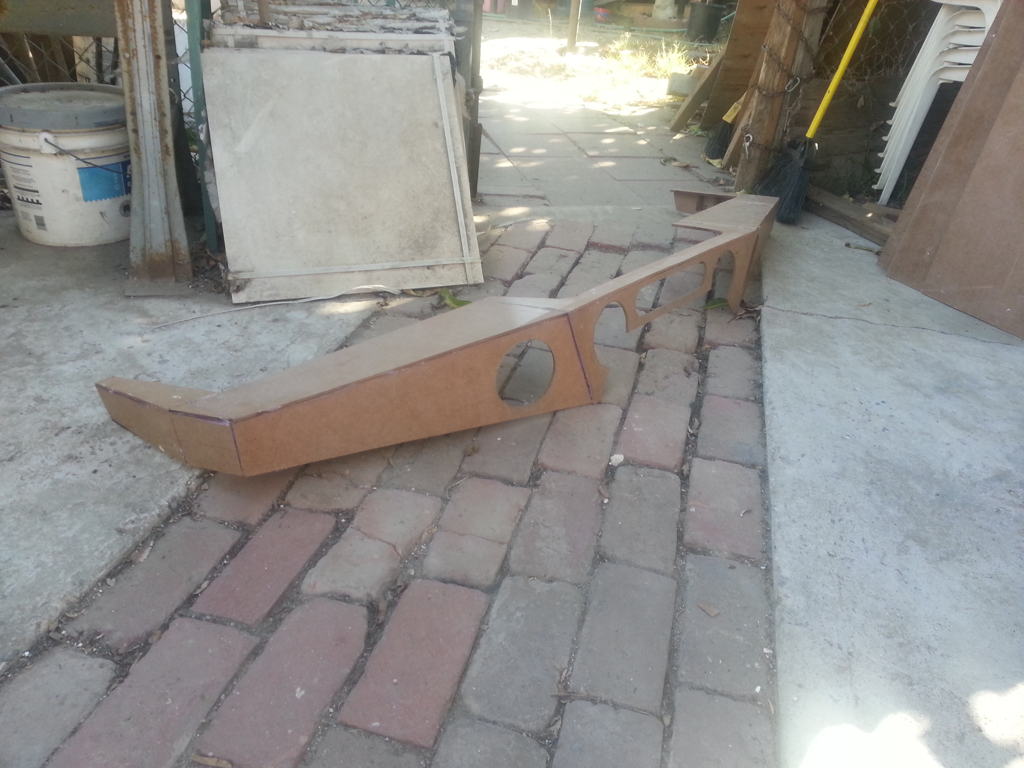

I added the corners that go all the way to the wheelwell.
top with the side pieces
Another for the hell of it.
In case you guys are wondering how im holding all this Masonite board together this is what im doing. Using a hot glue gun and a hole bunch of little angled gussets. if it weren't for those this whole thing would just wall apart. This isnt needed when i do the real thing though.
Inner part with the TG winch plate.
Dont know if you could tell here but i want to add a 7" x 6-3/4" squarish plate that weld on to the TG winch plate sides and on the underside of the top part of the bumper if that makes any sense. I had thought that this bumper will be needing the extra support so i want to add it for this reason. (I'll edit this picture on photobucket and add some arrows so you know where im talking about.
Finally added the bottom parts of the bumper. They just curve under the bumper slightly to give the bumper a nicer look. Kind of looks like a stealth jet to me

I have spent many hours changing the design in hopes i can take a good hit out on the wings without impact to body damage. I will be adding some light protection, with limb lifters, but that's later.
I'd look closely at how you can gusset the area you show above with the red arrows, a triangle welded to the TG plate behind the winch should help. Hopefully in my drawing you can see how I approached the issue. I am probably over building it, but I KNOW, the weakest point is out on the edge of the bumper at the corner lights...
here is the final version that was cut out, I'm using an x-ray view so you can see the construction better.

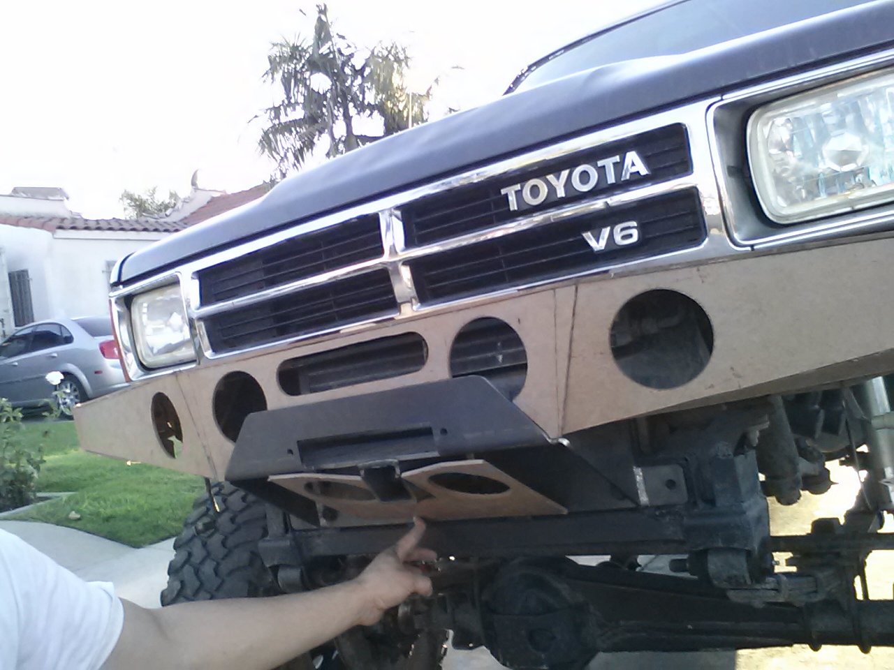

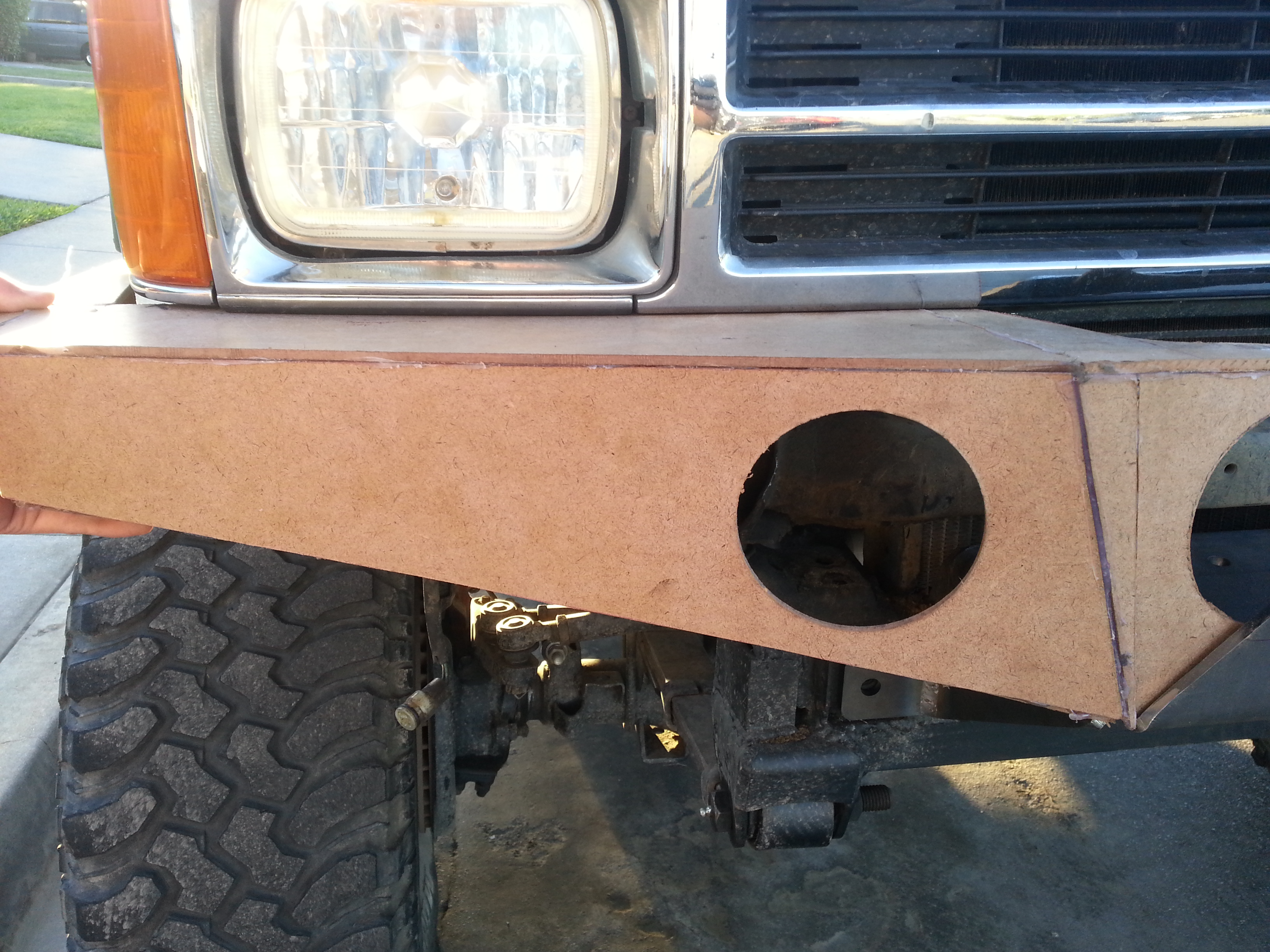

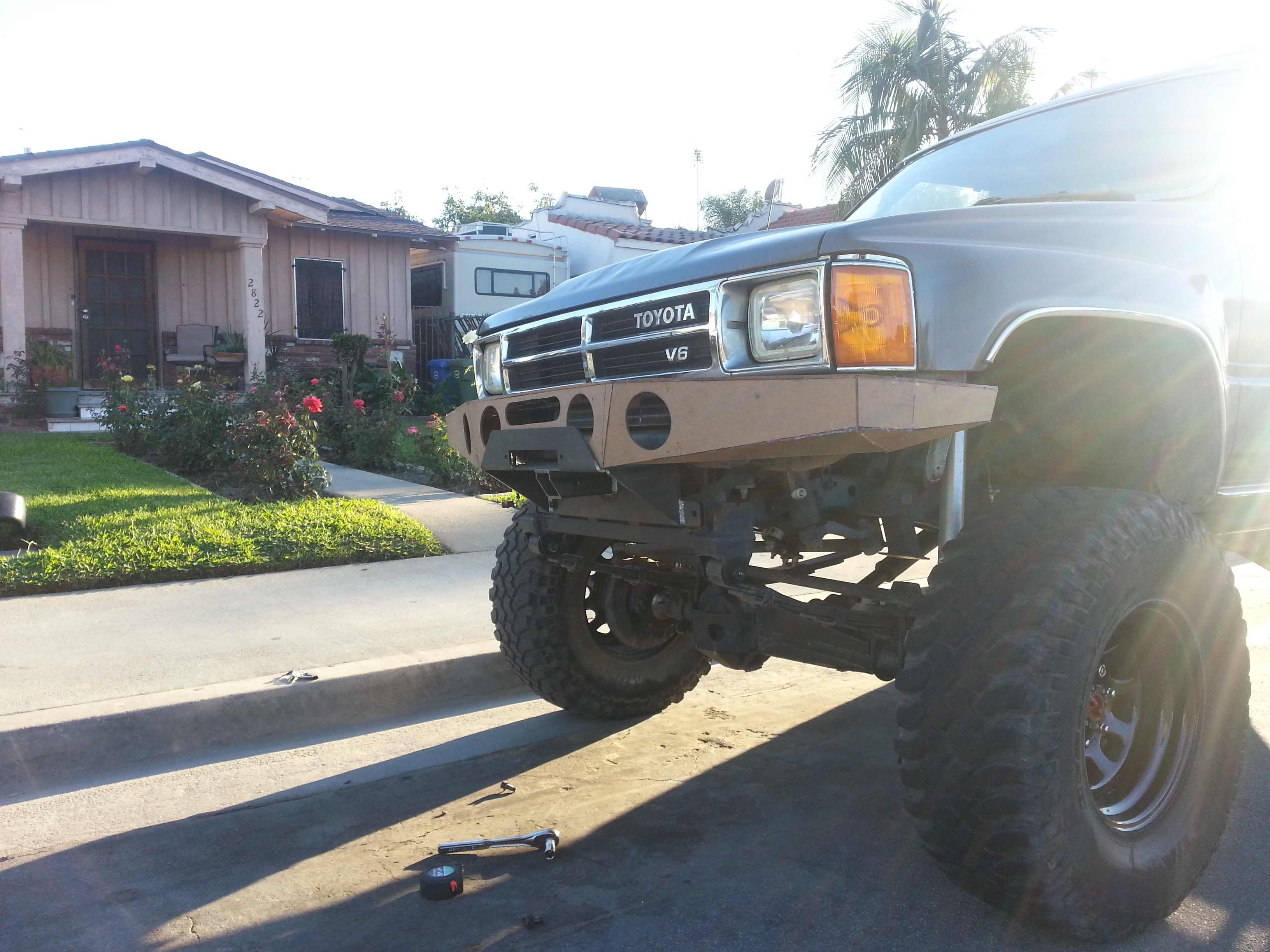

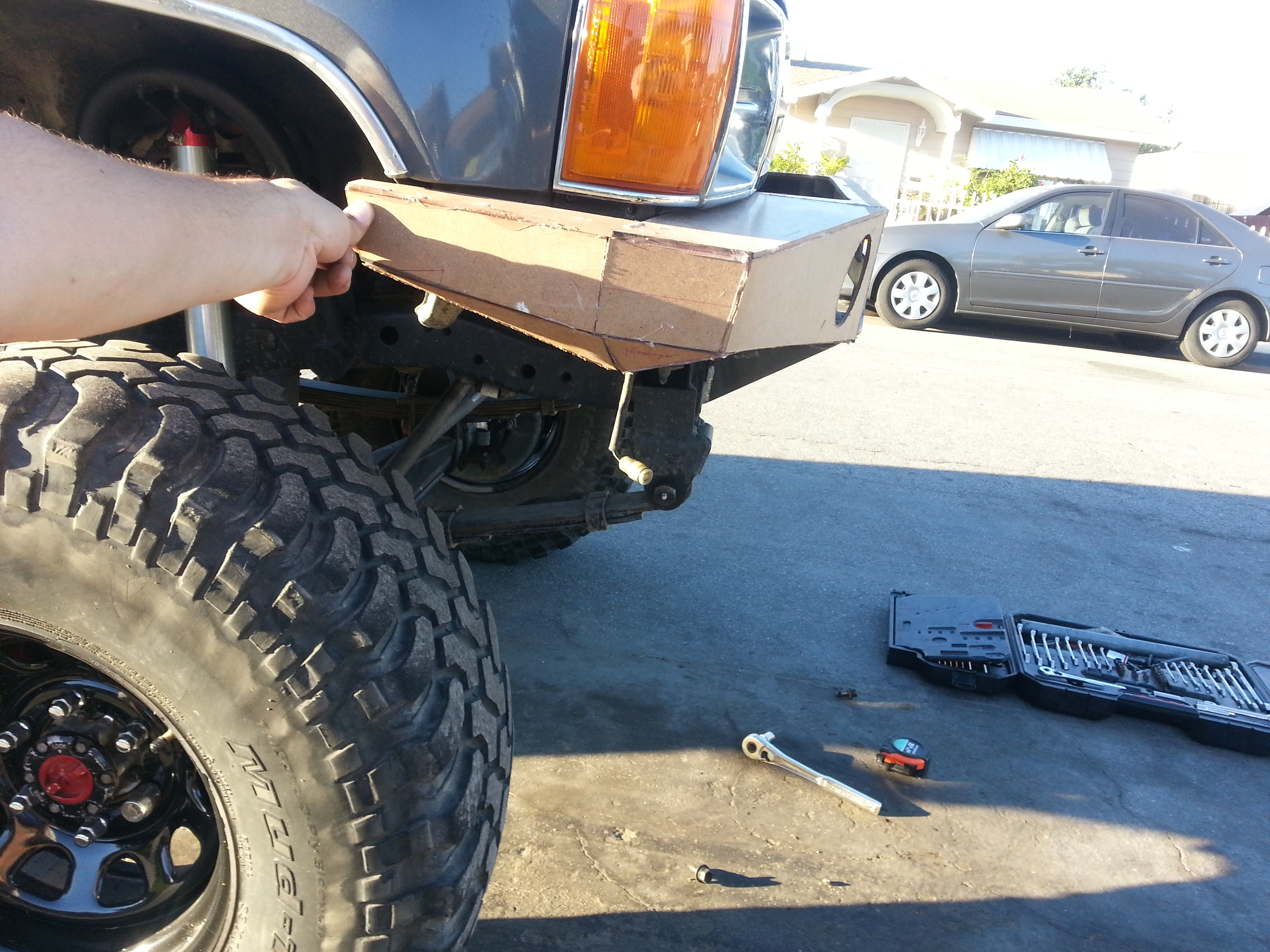

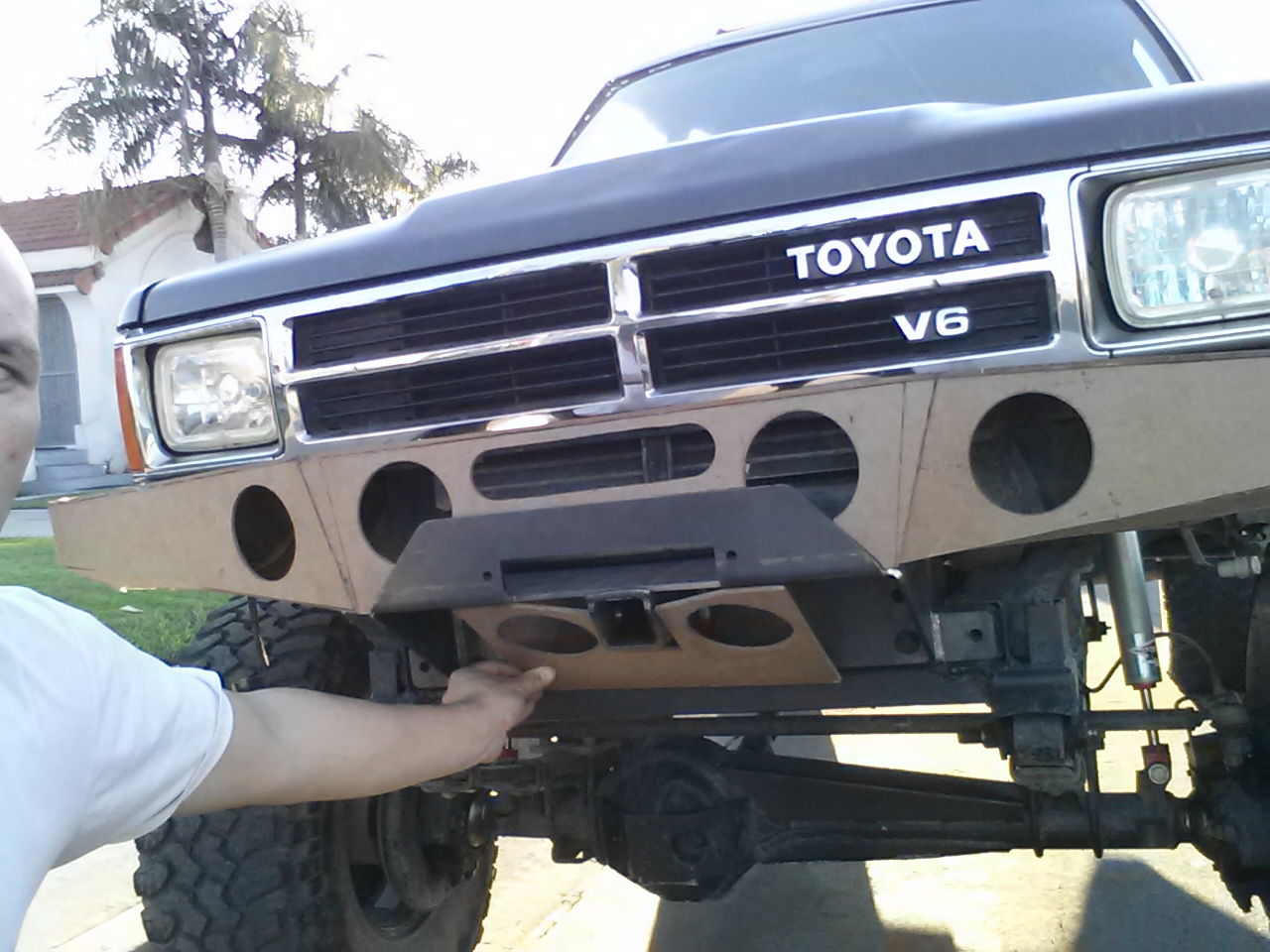

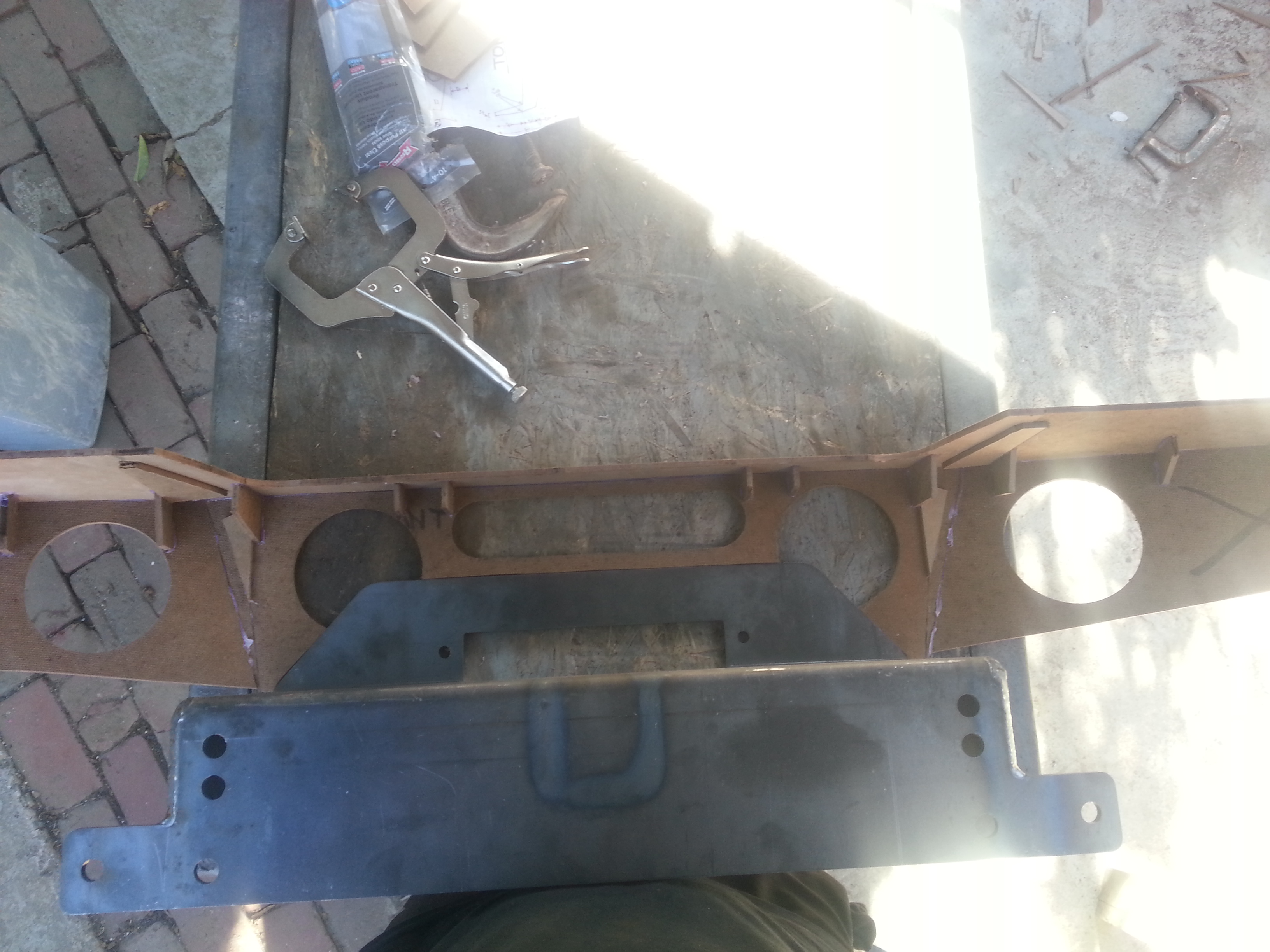

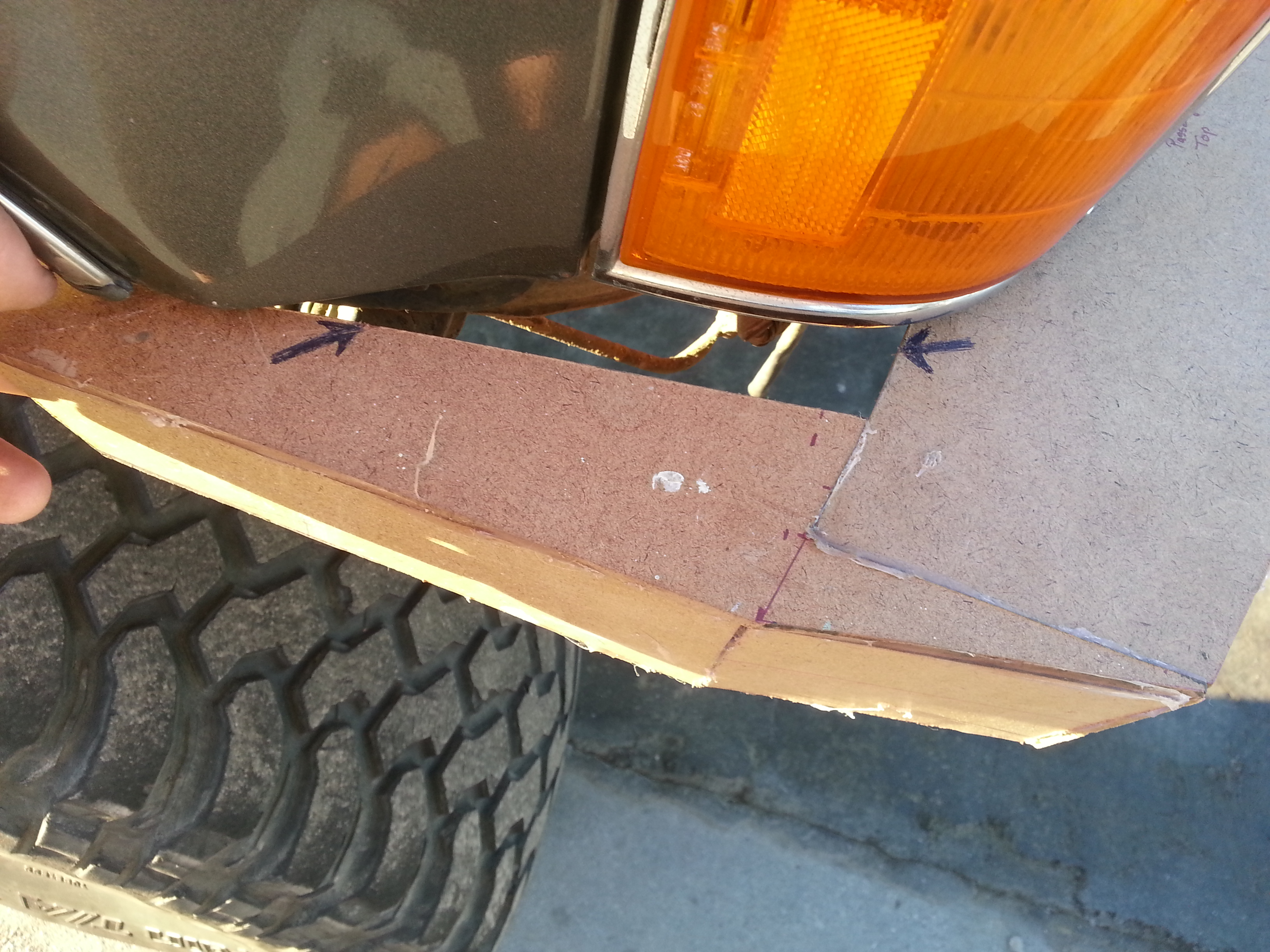

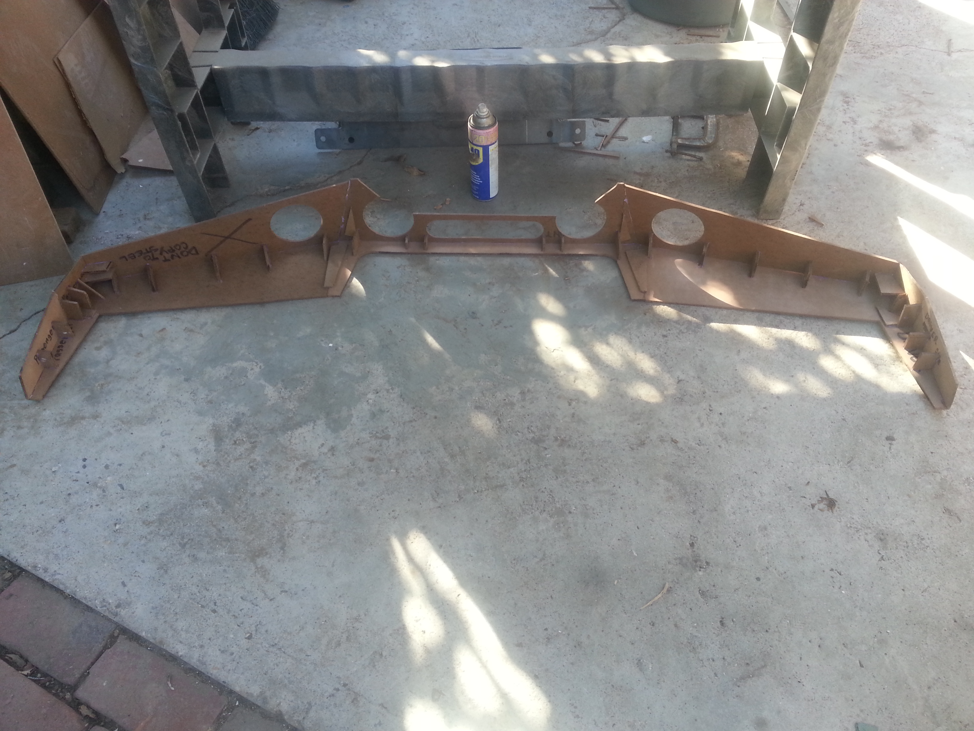

Alright guys I managed to get some type of progress in. Not a lot. but it was just fitting the prototype. Either way it was still fun.
My favorite shot.
I realized i have too much of a bump on the bottom side of those corners. It has a lot to do with how the bumper is curving like an arch. but even when straightened out you can still see a slight bump.I'm just going to need to make sure that when i do the real thing to tack weld those ends first before actually welding. Also the small square piece that connects the front face to the side is too square. i need to make it more at an angle; i think so at least. Maybe im just being too picky now. but I'll make sure to fix this when the real bumper comes around.
Dont mind the top curve. it isnt going to be like that once it is made of steel. It curves because the sides are to heavy for the center to hold up with just hot glue lol Also see the center holes. This should be plenty of ventilation for that radiator. they are pretty big size so even though the winch is there i'm sure it will get plenty of air.
Corner
Winch spot
Now here are the few problems i ran into:
The bumper needs to be shortened a total of 3/4" to be able to clear the screws and clips that hold the grill in place. So that will need to come down some. As you can see in the picture below that bumper is right up against the grill.
The whole overall width of the bumper needs to be shortened 1.5". I thought i had the measurements correct and i drew everything out according to all measurements the tape measure gave me and also based on the stock bumper dimensions, but when i had the stock bumper width at 66" from edge to edge(where the bumper ends go to the wheel wells) it just looks goofy. It's too wide and you can definitely tell. Will need to shorten about 1.5 maybe even 1&3/4 to be flush with the fenders.
The corner piece had a gap on both sides. i am going to need to bring in this piece about another inch toward the center. I put arrows to show from where to where.
Also going to need to shorten the side piece that goes to the wheel well(where my thumb is at). Drew a line where i'm going to need to cut. this will have to be shortened about 1" on both sides.
Fitting and troubleshooting. This is the main reason i don't start off working with steel. Always gotta make sure everything fits before i buy steel and begin to cut. Steel cost a lot of money and i would hate to have to buy steel twice!

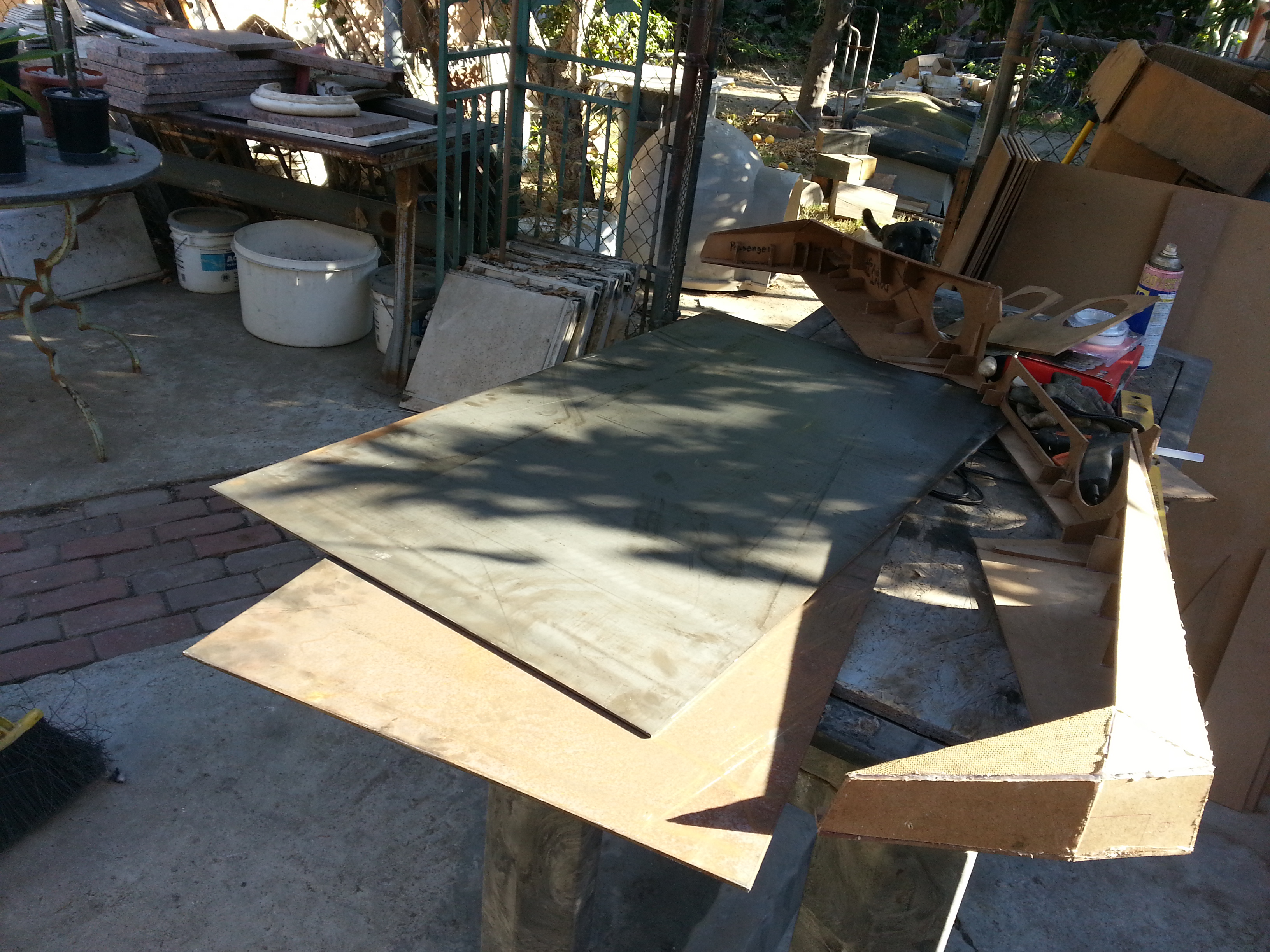

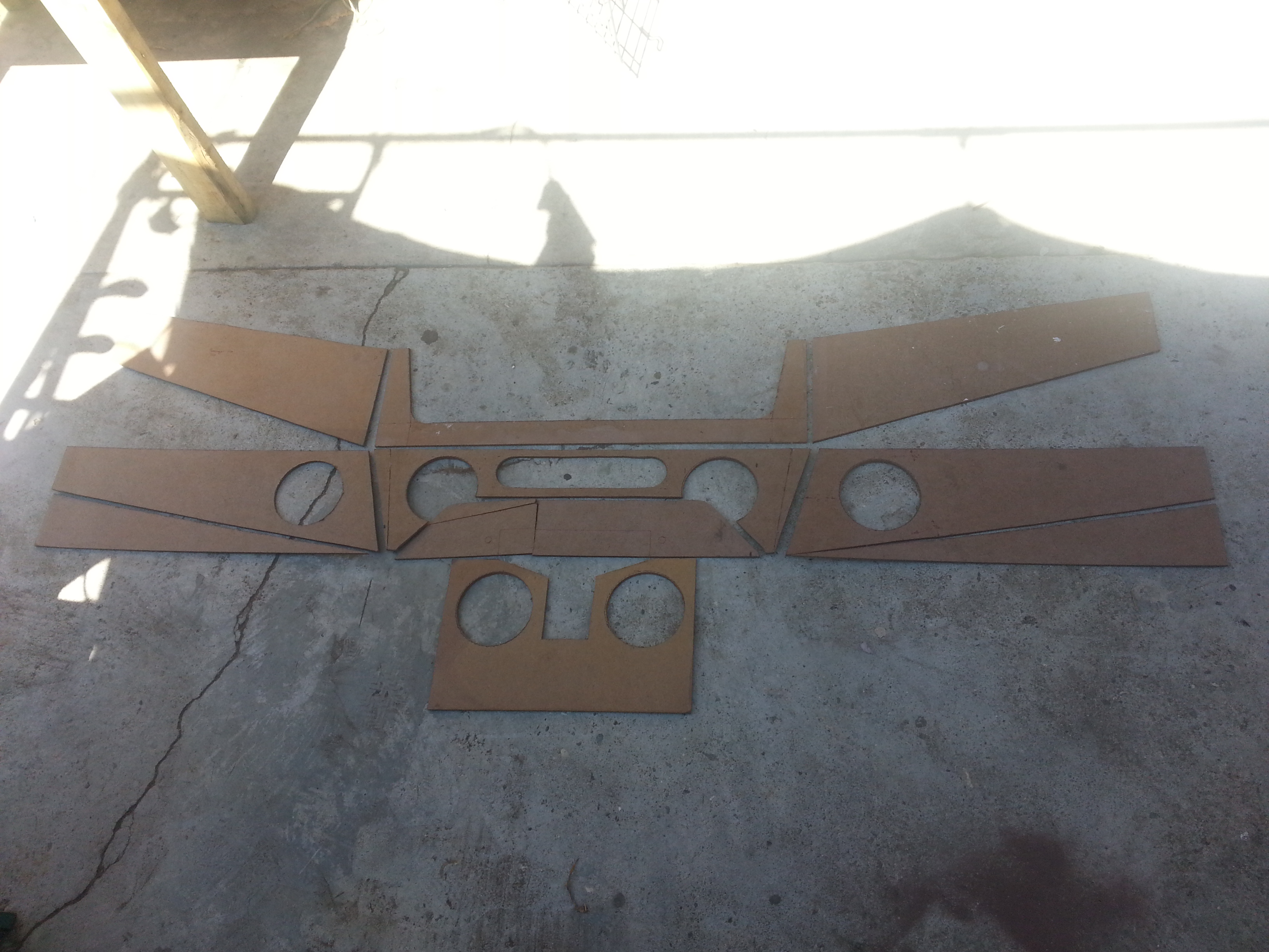

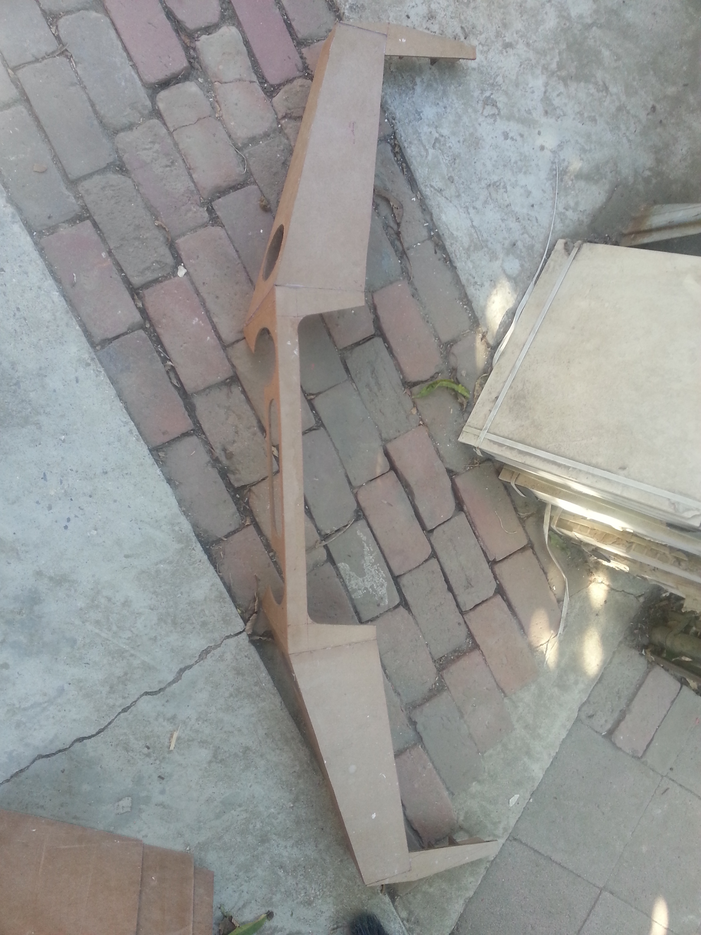

Hi Guys. i was able to get 2 pieces accomplished today.

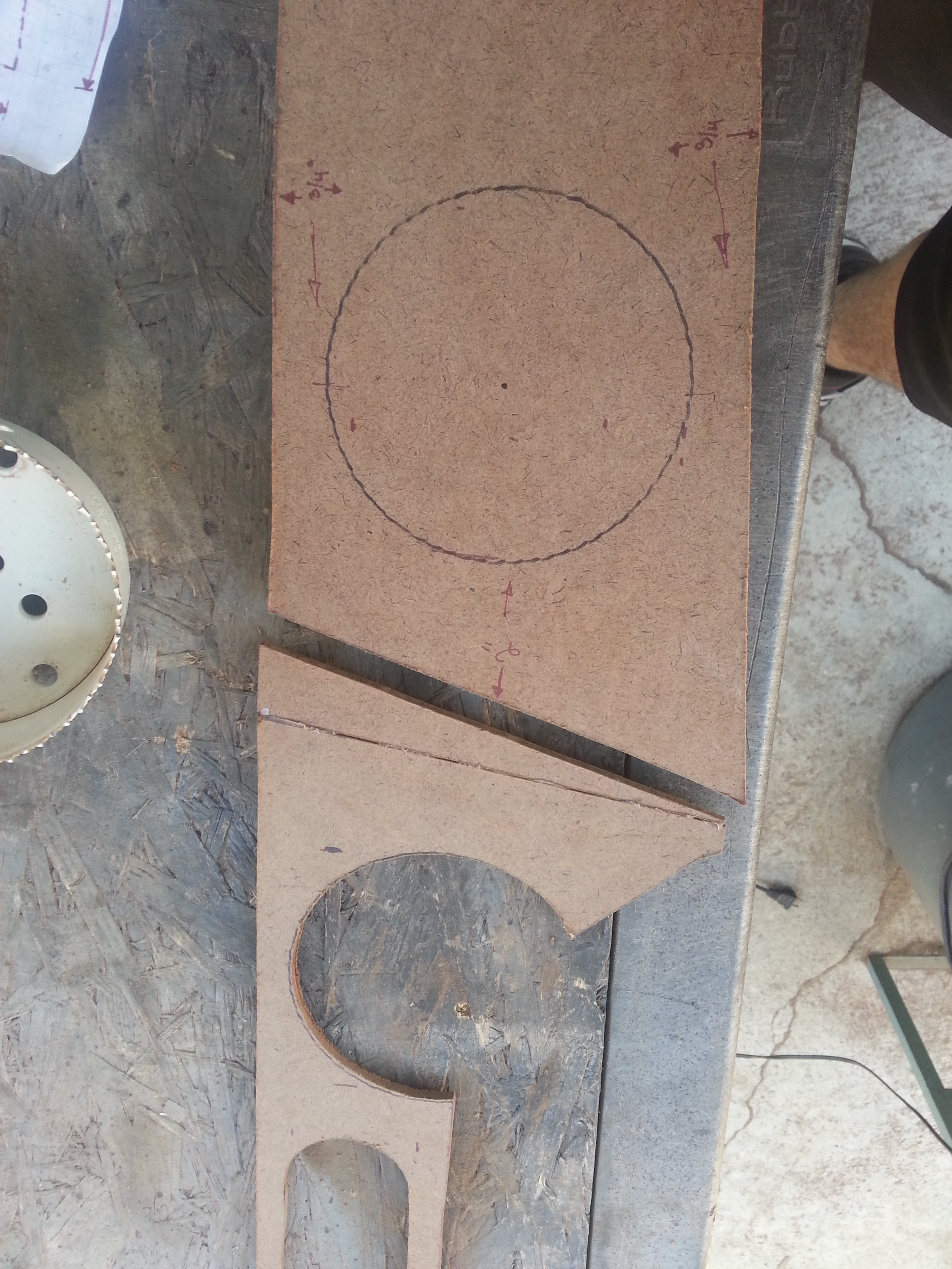

Started off by out lining the 2 center pieces of the bumper with my Masonite templates. We pulled out the acetylene torch to cut the pieces quick like last time but we kinda ran into some problems. We ran out of Acetylene before we could eve start lol So i went out to harbor freight and bought some metal tips for my jigsaw I didn't plan to use this but this is the only alternative i have right now.
These are the tips i bought
Here are my 2 cuts. top and center front bumper pieces. I cut these out first because I want to make sure the top piece will clear my winch if i ever had to take it out. Plus i need to make sure the depth from front to back will be fine when i start off. because i do know it did sit a bit too long when i fitted the bumper to the truck. So once i have these 2 pieces ground down to a smooth surface and tack welded ill have something to start working on building the rest up.
Not much accomplished. Spent too much time at Harbor freight just to buy these dang blades. I'll continue to cut some more tomorrow guys. or at least get that center piece welded together so i can fit that winch for clearance.

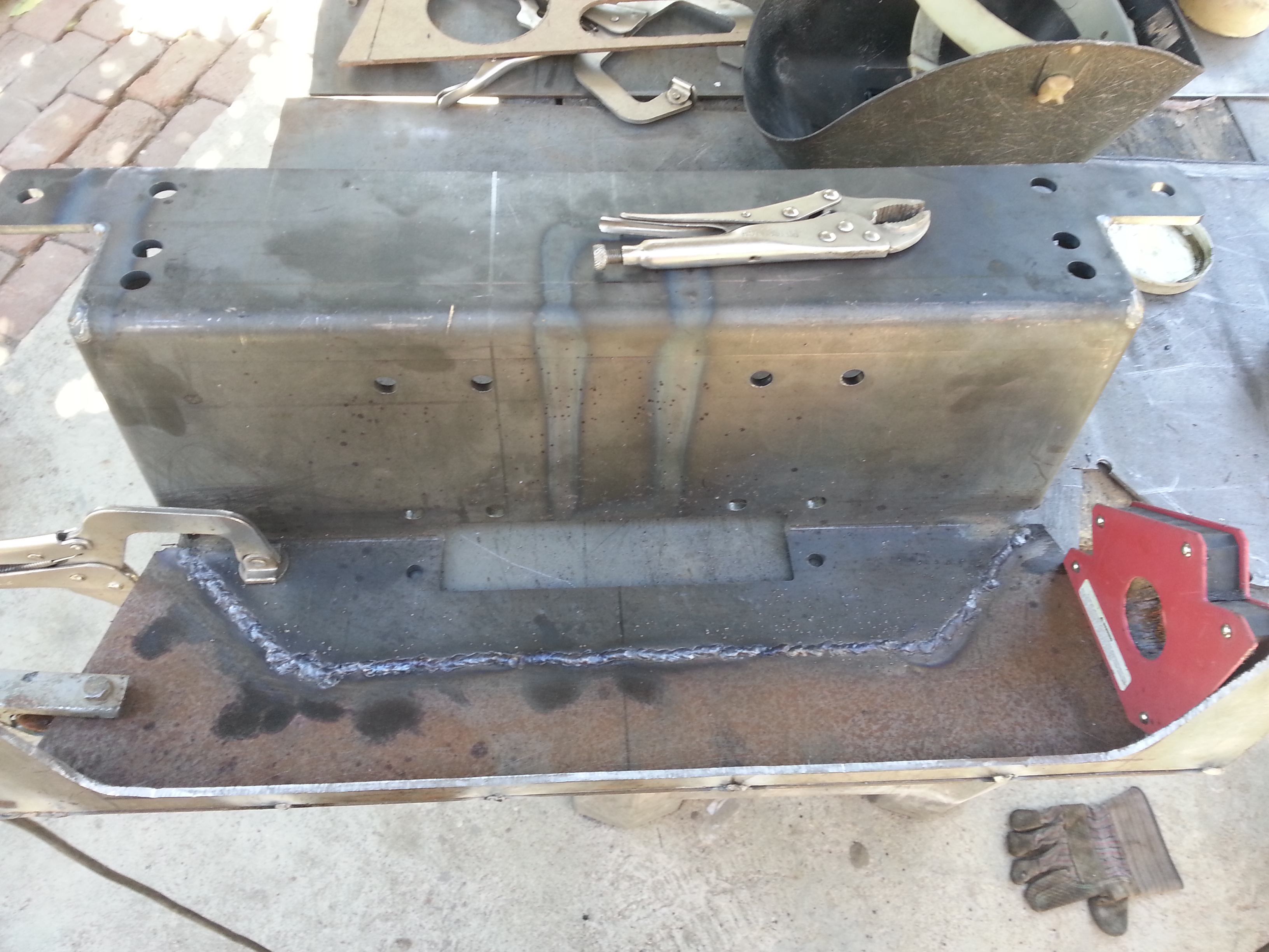

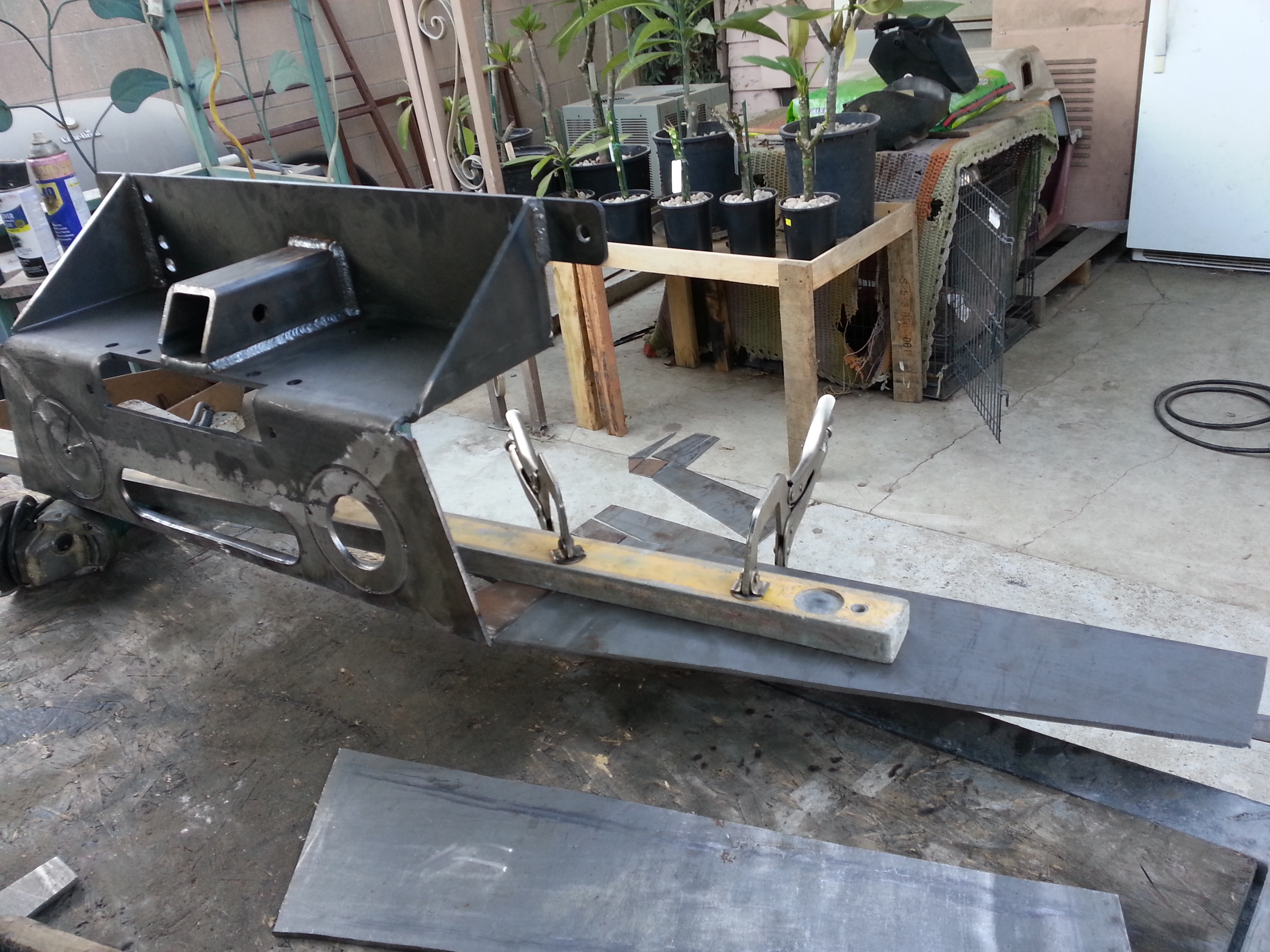

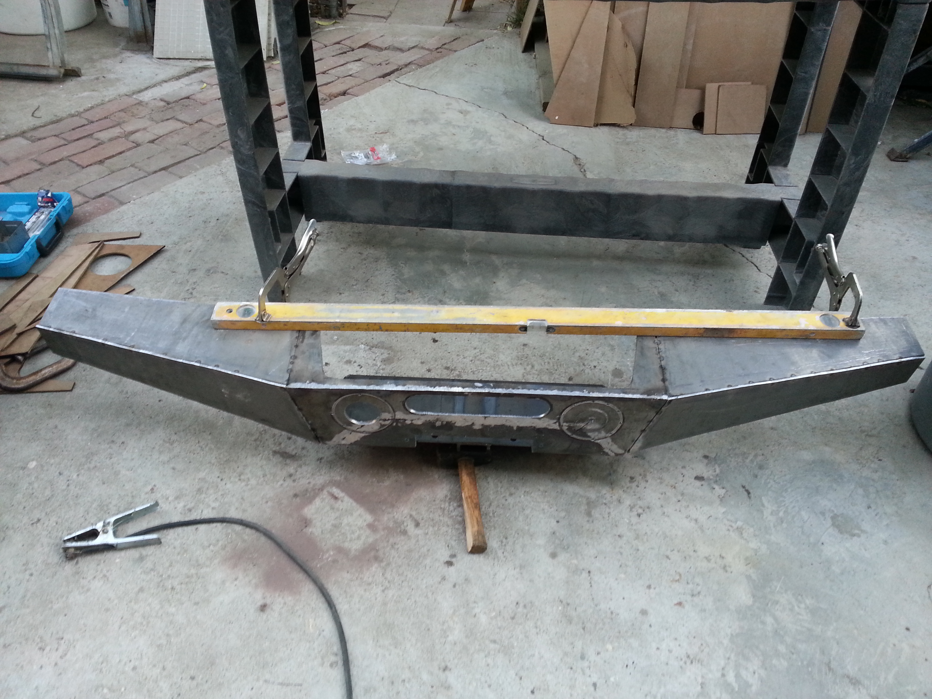

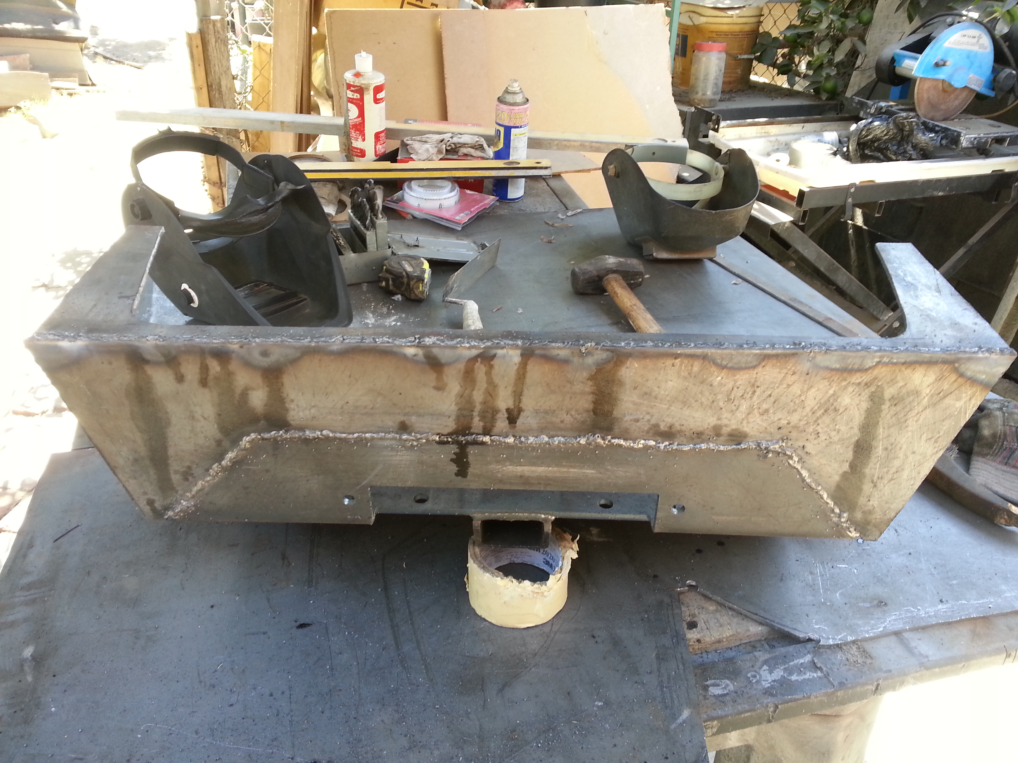

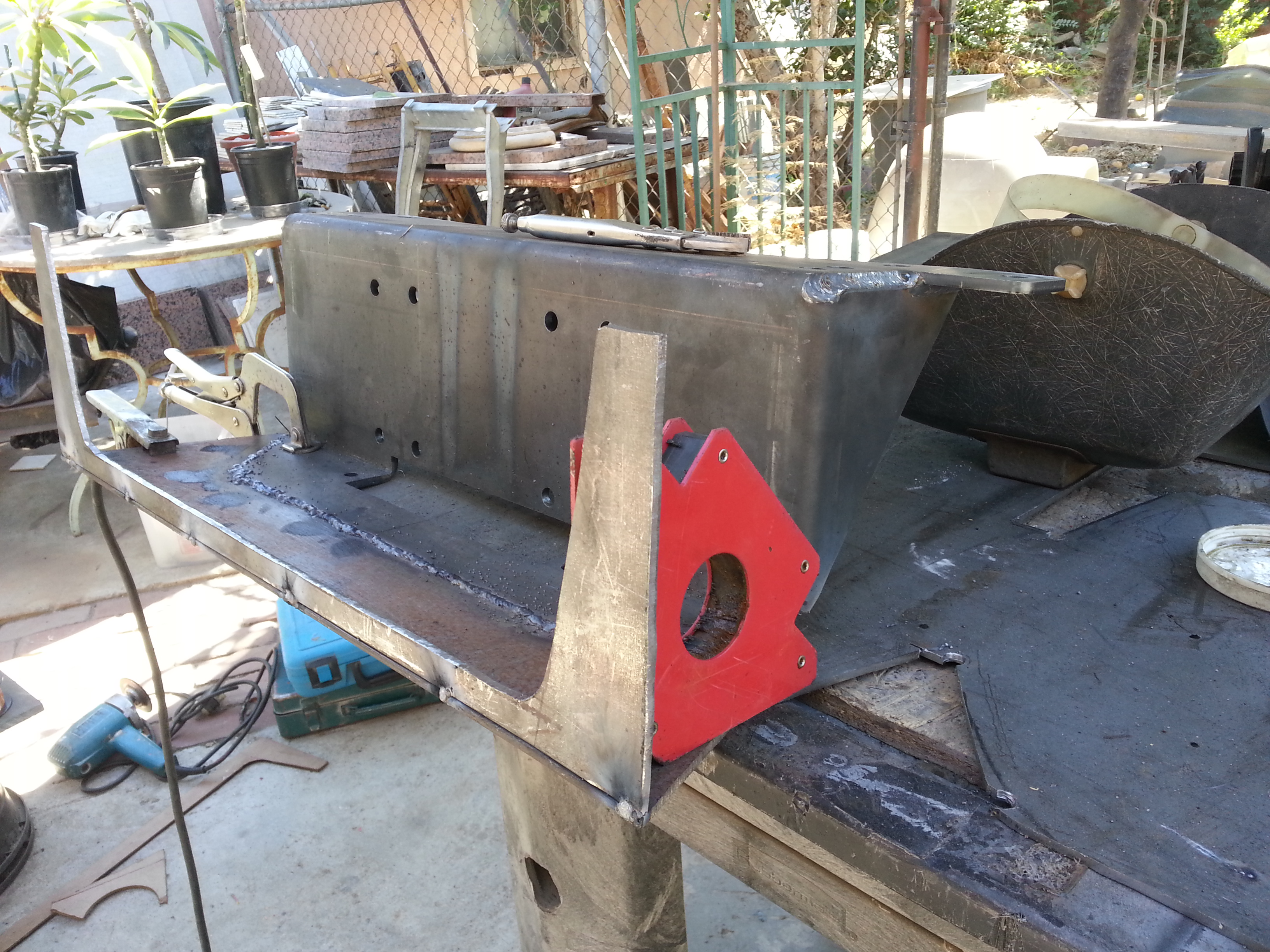

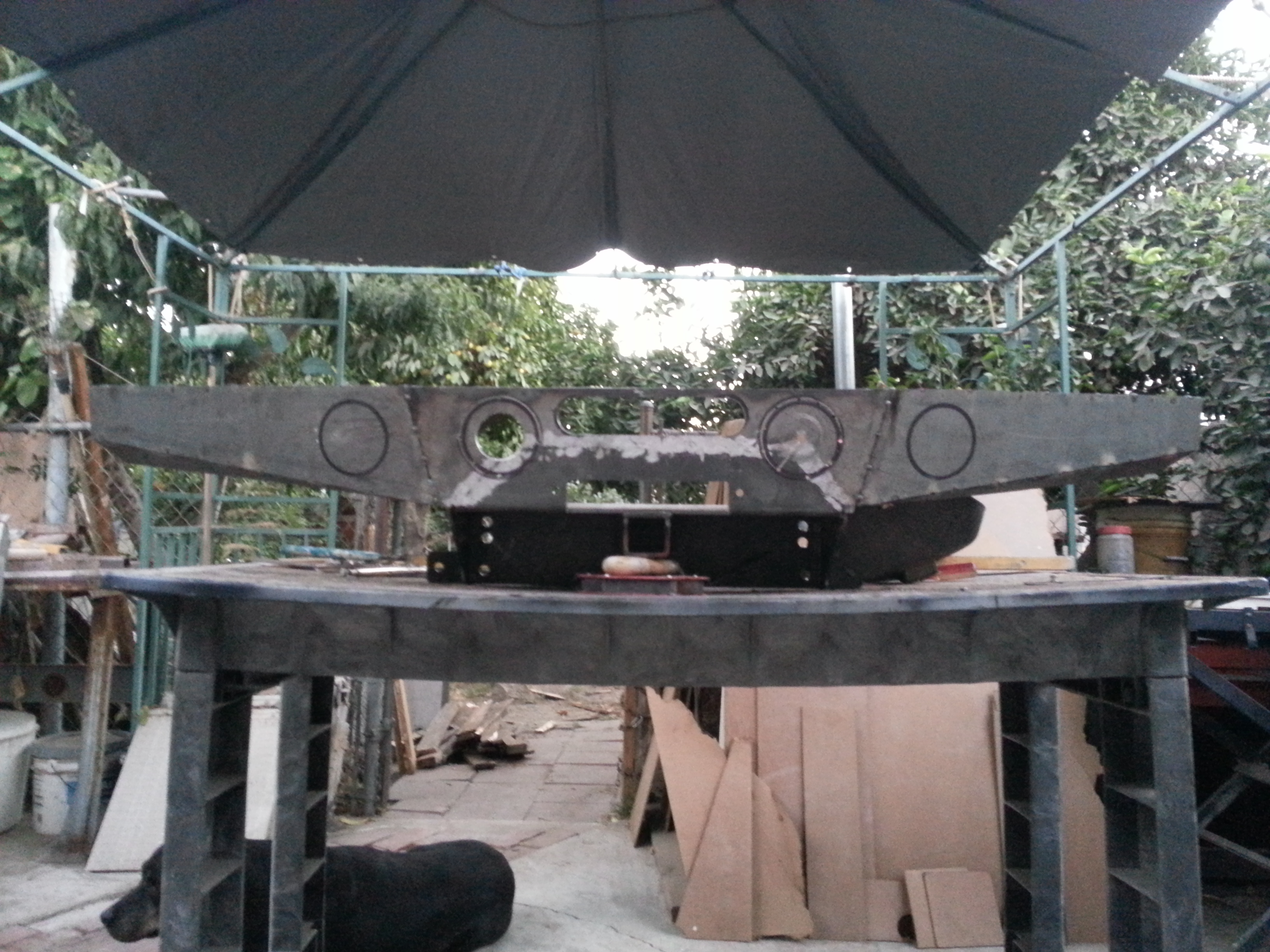

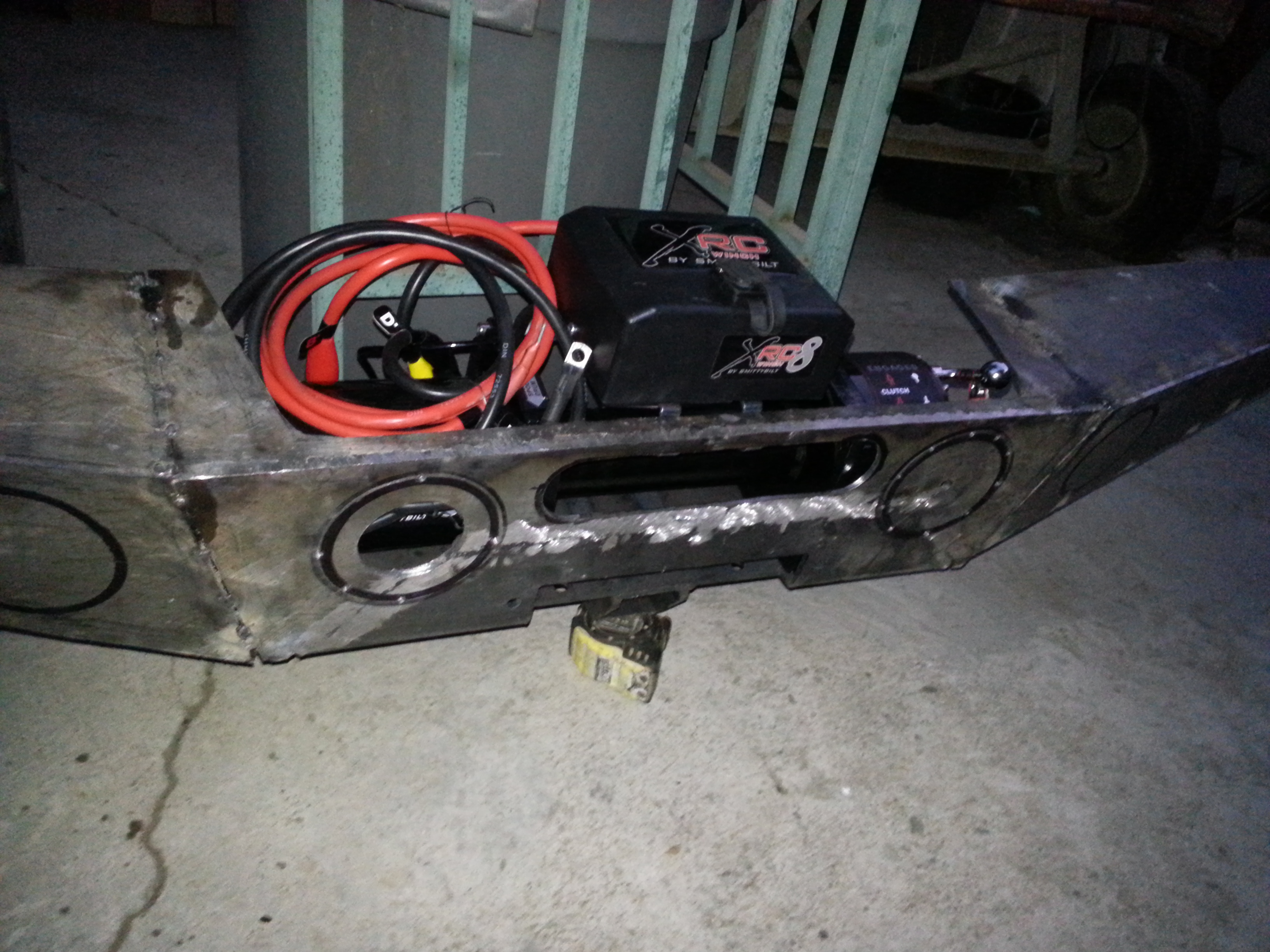

Got the parts tack welded together but i need to take it apart. the top side wouldnt allow the winch to drop in. Ill take pix tomorrow.im gonna have all day to work on this bumper.

Welding bumper together!
I got tons accomplished today. Started the day off at about 1:00pm.
I tack welded the 2 center pieces of the bumper where the winch plate is. After i tack welded i had my dad check up on my work and he didnt have very much to complain about. He just said my welds are getting better.
Dad touching up my tack welds:
Squaring stuff out to make sure it isn't all thrown off when i add the rest of the pieces.
Completed my welds for the center pieces. I know i know I'm not the greatest welder. I'm still learning getting the technique down. but i have full confidence that my welds will hold, they just look messy thats all lol
I cut up the rest of the pieces to the bumper with the jigsaw.
NOTE:
- Cutting with the acetylene torch like i did for the rear bumper will save your tons of time when cutting out the pieces BUT the down fall to that is that you will spend lots of time grinding the melted metal edges down.
- I found that when cutting with the jig saw, although it took much longer to make all the cuts, it was way cleaner. All the pieces i cut were ready to be welded together right after i cut. practically didnt even need to grind anything.
***That was just a thought. Just in case you didnt know which route to go.***
Adding the top side of the bumper:
I ran into some problems with the hole saw today. The smaller size worked fine. as you can see the oval shape in the center came out fine. But when i tried to get the 4&1/4" holes cut they just barely scratched the surface. This hole saw sucks! So i figured i would just cut a smaller hole in the center. then try to cut the circle with the jig saw. but the 1/4" metal on the winch plate is too thick and i wasted 2 jigsaw blades by trying to cut through it. So you will see in the following pictures that the holes didnt get finished. I am going to go fill my dad's Oxygen and Acetylene tanks at a local welding supplies store during the week. Then i'll be able to get those circle holes cut out just fine with no problem at all.
Tack welding it all together
Smittybilt XRC8 Winch fits perfectly!
As of right now i just left the bumper tack welded together because i still need to fit the bumper to the truck and i might have to make some alterations to the sides. So I'll just leave it as is to make sure it fits just right before i make the final welds. I still need to add some reinforcement behind the face of the bumper. So dont think it's gonna stay like this lol
Will continue to do some more tomorrow morning.
