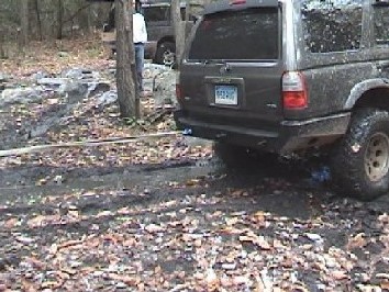

Even got to pull out a stuck FJ40 with it.
Attached Thumbnails Pics from 3rd gen 4runner rear bumper build-fj40_rescue.jpg
