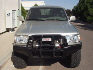

Here is our new prototype front bumper for 3d gen 4runner.
Fits any year 1996-2002.
For the best aproche angle, grill has been removed.
No frame modification. Bumper-one init bolted on original points. Turn signals and the grill will be added latter after testing.

Lookin' good. Have you figured out a price yet?

dang that looks real good, im sure your gonna get some good sales on that...if the price is right of course.

Awesome looking bumper, how much does it weigh?

very interesting to see that he grill is completely done away with.
That takes some getting used to.

Nice looking bumper. I'd just like to point out, though, that the bumper mounts are different for 95.5-98 than 99-02. To mount that bumper on the later model 3rd gens you would have to cut off the lower part of the factory bumper mounts on the front of the frame. Just wanted to make sure you were aware. Great looking product!

No harm meant...The bumper really does look bomb-proof. It's nice to see more companies getting in the mix for the 3rd gen bumper market.
