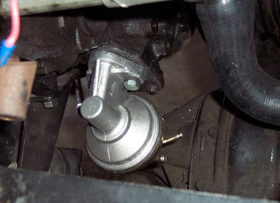

Okay, time for an status update on what I've been up to. First things first, installed new mechanical fuel pump for the 350 v8, uses a push rod from the cam to pump fuel. Its more reliable than the electric, though I'll keep the electric for a trail spare:

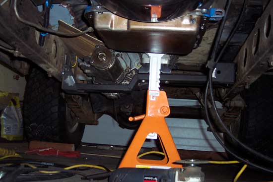

Installed transmission support brace from Advance Adapters, had to modify the brackets a bit so that I'd be able to remove the brace without too much trouble:
Attached Thumbnails My FJ40 Buildup-fj40buildtranny1.jpg   My FJ40 Buildup-fj40buildtranny2.jpg

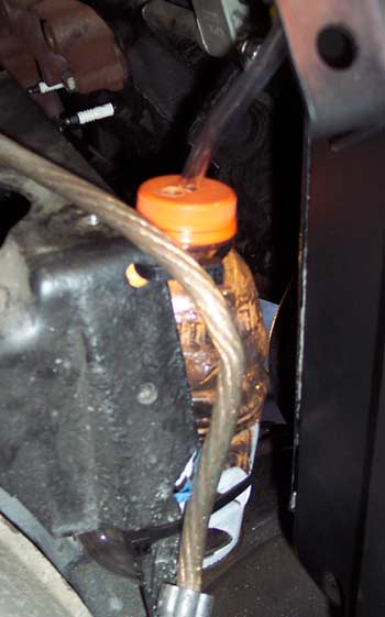

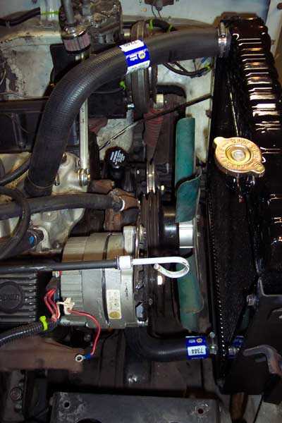

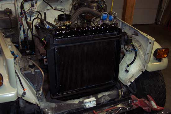

Picked up new radiator from Cool Cruisers of Texas, 4-row, compared to the stock 3 row. I want to make sure I've got plenty of cooling power on the trail. Made a real fancy coolant reservoir, cost about a dollar:
Attached Thumbnails My FJ40 Buildup-fj40buildrad1.jpg   My FJ40 Buildup-fj40buildradhoses.jpg   My FJ40 Buildup-fj40buildradres.jpg

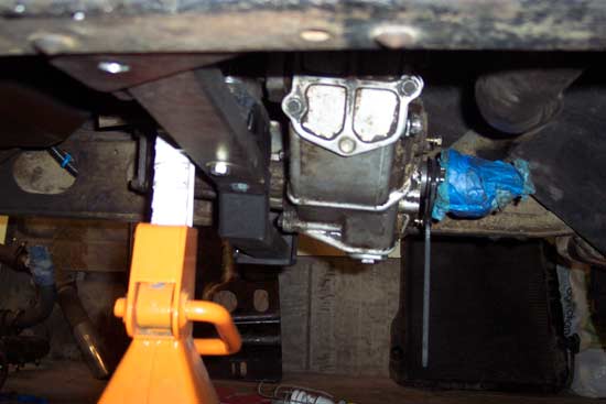

Installed a "transfer case saver" which is a safety precaution with the older style Landcruiser transfer cases, which have a split case design. This bracke helps to hold the two halves together:

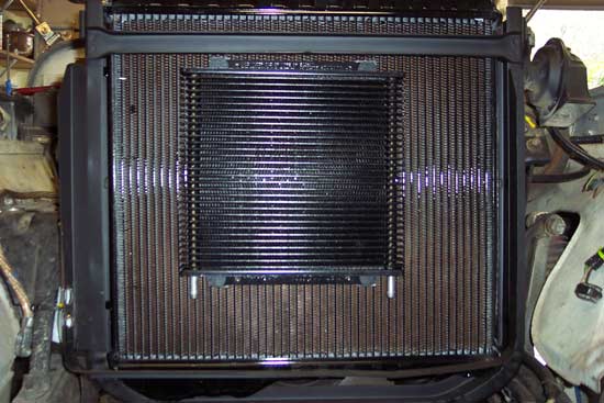

Installed a Hayden tranny cooler, gotta keep that th350 nice and chilly:

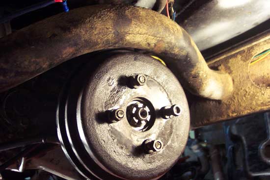

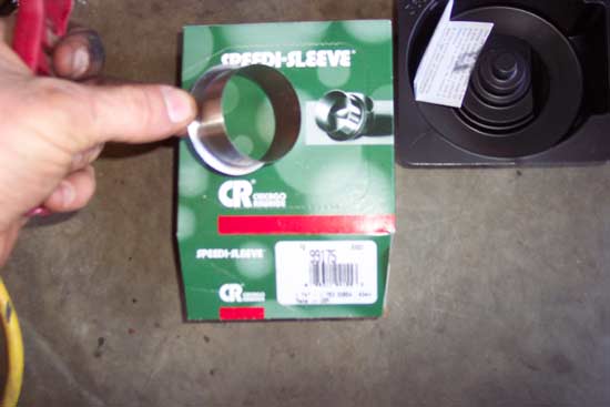

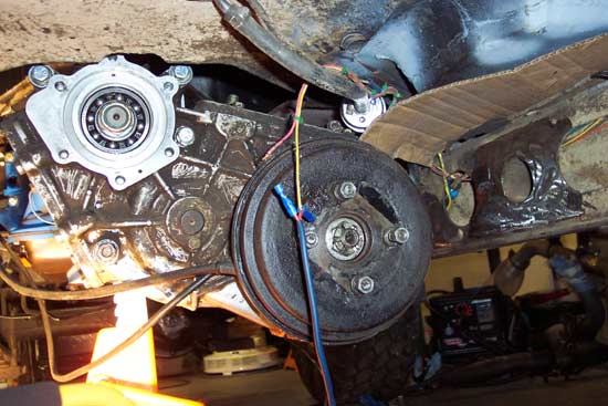

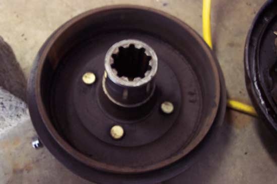

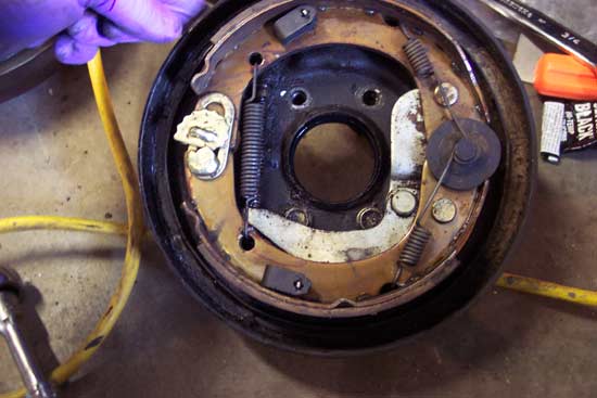

Common problem with the cruisers is the output shaft for the transfer case, that goes into the emergency brake drum has a seal that goes bad and leaks gear oil into the brake drum. Picked up a speedi sleeve that taps onto the shaft, increasing the diameter just a tinge to give a better fit with the TC seal. The seals on the front and rear TC output and the front and rear pinion were also changed while I was at it.
Attached Thumbnails My FJ40 Buildup-fj40buildtcseal.jpg   My FJ40 Buildup-fj40buildtcseal1.jpg   My FJ40 Buildup-fj40buildtcseal2.jpg

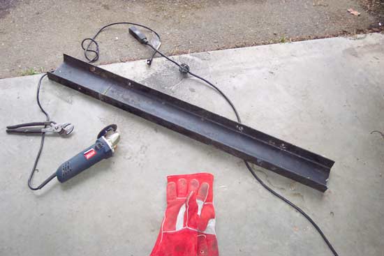

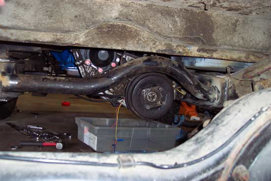

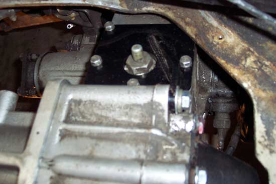

So...went to reassemble the tc brake onto the tc, and realized that I wasn't going to have enough clearance between the drum and the crossmember that runs between the two frame rails. I had to spend some time with a cutting disk and an angle grinder to cut it off. Had a bit of steel lying around, was actually the old front bumper that I've been hacking pieces off as I need them. Got everything welded back into place, and the braces will serve as a mounting point for a skid plate, eventually...
Attached Thumbnails My FJ40 Buildup-fj40buildcross1.jpg   My FJ40 Buildup-fj40buildcross2.jpg   My FJ40 Buildup-fj40buildcross3.jpg
