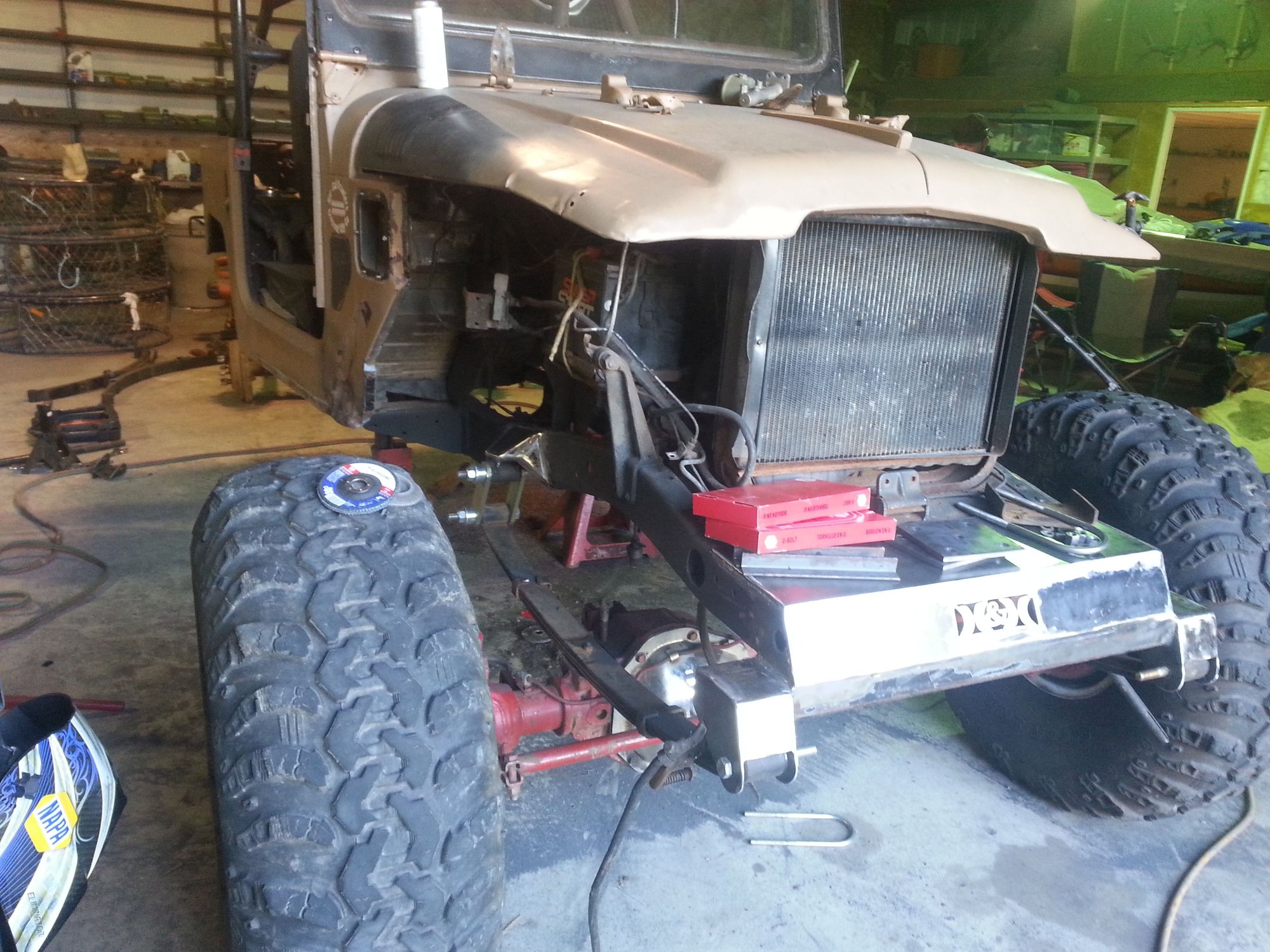

The shop it is at is called H&H Fabrication in crescent city California. Two really cool brothers who know how to build stuff! The front axle is a king pin dana 60. rear is a dana 60.
finally found some tires! 39.5 iroks
had to lean the tires up to see the stance... lol
ditched the old hanger and winched and built a new one.

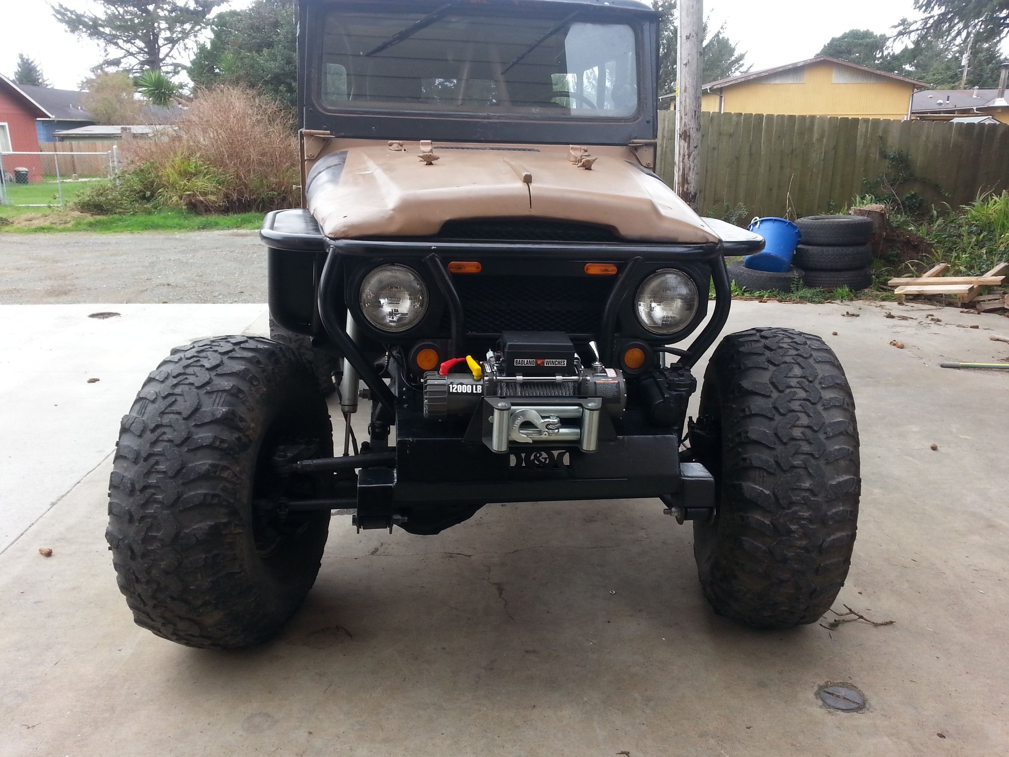

new 12k harbor freight winch
