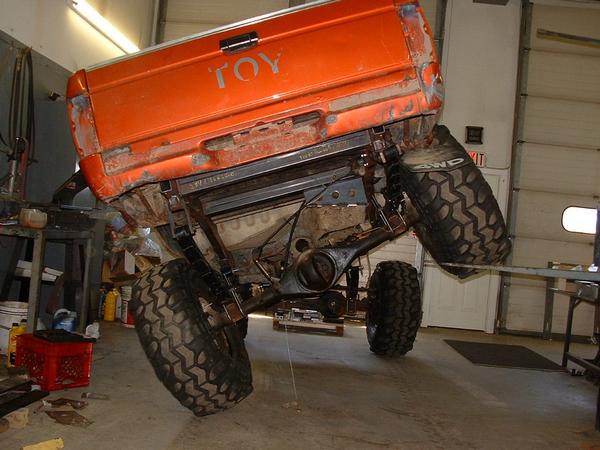

Just don't do anything like this:

oh god... that picture again?????
repairs look great dude

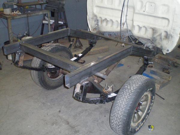

these are a fiew pics of my build. i had a similar problem with rust. i live above the rust belt(in new hampshire) and the bend in the frame at the back of the cab was pretty thin. so i decided to not patch it but to cut it off and start over.
Attached Thumbnails massive frame rust repair!!-l_a5dc9a58174845e2df35da8b0a7cfb28.jpg   massive frame rust repair!!-l_d3db83e1fe1c1f9248dfd629622ca037.jpg

i used 2x4 1/8 wall tubing. i dont know why the pics are so slow to load( probly cus i suck at using computers) but if you want to see pics of the end result i can email some to you. it came out real nice and it is super rugged

Wow! thats ambitious. How is the new frame section holding up?
Any more pics?

its real strong. the new rails are sleeved 8 inches into the old frame. they are plug welded in 6 spots on each rail. the frame is based off the stock measurements and somehow my friend and i got everything square within 1/16 of an inch. i will have more pics of the k member and bed mounts when i figure out where the cord to my camera went.

What's the wall thickness of the stock you used?

1/8" i was scared it might be a little to conservative but it was just right. it does not flex or bend and i am pretty hard on my trucks

1/8'' is thin but, will work because its boxed. you can always add reinforcement plate to beef it up. the main stress point would be the angle joint where the welds are, coming up to the rear level part of the frame.
What leaf pack are you running?

i have the all pro 5 inch long travel leaves. i have the all pro 6" in the front and for some reason i ordered 5" for the back. so i made due and made some 2 inch "leveling shims" for the rear. i will make a trac bar also

Did you do the SAS?
If you were running the 63'' Chevy leafs in the rear, frenching the front hangers, for the rear leaf spring into the new frame would be real slick.
The All Pro leafs... the same would be possible but shortens the wheel base. You should build some hanger protection for the front hangers in the rear, like a ramp, to protect the hangers from rock rash.
