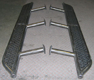

This is the set I made for my wife's 3rd gen 4runner. I most likely will never build another set again!!! That slider is 100% TIG welded, and the weld on time makes these cost way to much to reproduce. The only reason I did it was to keep all of the winter time road grime from getting all over the side of her 4runner. If I did not do this she wouldn't have been to happy with me.
The design shown in the first picture would not have solved this problem for me as the holes would have let to much junk through. As was said before you would have to have miniture feet to fall through most all on the market sliders!
Richard
PS- Thunder cloud (4runner's), and thunder grey(tundra) are NOT the same. $150 in disimilar paint to have it have a purple hue.........close but definately different.

Stubbs - those sliders are beautiful. How thick is the treadplate?
14 gauge. I like them but again the time involved to just weld them was crazy. There are sooooooooo many linear inches of welding in those. The other problem, and this is the biggie is you CANNOT continuesly weld around the perimeter with out warping the slider like a canoe. Not restraining not anything is going to prevent this. Therefore you must flame straighten after welding which is a pain.
I did make another set after i said I would not.......lol. This set was MIG welded instead of using the TIG, and 1/2 long (MIG) welds every four inches works well but still I dont see us making these as a production item. It comes down to benefit/time/cost.
Here's a pic of the MIG welded set.

Richard- what about "bolt on" tread plate? I'm considering putting some covering on my sliders, and was originally just going to use my MIG to attach them. As a newbie welder, images of canoe-shaped sliders has sufficiently scared me off. I'm wondering whether it'd be easier to just tap a couple of small holes, tack weld in some threaded inserts, and some allen-wrench head style bolts to hold the plate in place. Would drilling into the sliders compromise their strength if they were small enough?

i can make yea some if your interested..as for the mig welding..why not use some perferated plate??like 1/4 hole style that way your only welding 1/2 at a time..and only need to stich it..if your useing solid say checker plate and done want any rust seeping out then seal weld it but use a mig and run down hands would be fne..tig is way to slow for something like sliders...my 2cents
