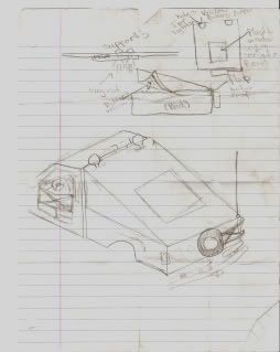

so i was pondering if i could make a tent that you could basicaly leave set up in the back of your truck for a weekend of wheeling but i came up with this rough sketch and idk i want to try and make it but still idk
just looking for a little feed back any would be awsome lol and i will take questions

Need to make it more see able can't really make out what you have there

lol i tried but ill see what i can do

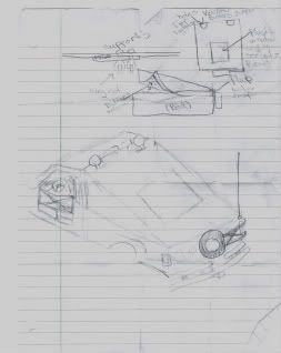

The ego i have quoting myself haha
Is that better?

Are you thinking something like this?
Maybe supported like a normal tent with fiberglass rods, hanging over the tailgate a bit secured with a bungie (The Green) of some sort to keep it from catching wind.
it is a good idea. just how to construct and secure it is a predicament

OK so bare with me on this
If you have a boat canvaser in your area you could have them bend the aluminum piping to make the frame and have it bolt to the floor of the bed like the black lines in the picture.
In front you should have one made to the bed floor as well that is flat bar and have it made to have snaps on it to hold the front of the canvas,
on the sides you could do the same thing and either have it snap to the side of the bed or to the floor as well like the front,
the rear depending on how you do it could be either snaps on the inside of the tailgate with a flap of canvas for once you are inside or on the outside of the tailgate for when you are outside it and you would still have use of the tailgate so you could crawl in and out and still button it up and have it as air tight as possible.
Along all the bars sewn into the canvas have ties sewn in to make the canvas solid to the bars to give it a nice tight fit on the frame work or better yet have a few small pockets sewn in for the frame work like a tent has for the rods and the ties so you can pull it tight. Believe me in my brain it looks a hole lot better then in the paint show here but of you think of a 4runner with the canvas top in place of the hard removable top then you can get a better idea of what I am getting at here.

but ya thats like exsactly it lol but i think i would make the outer supports out of like angle iron and maby have the tent portion have like those idk there like rectanglular and they fit in a hole and then spin to lock it in place
Really all the supports are suppost to be to be under the canvas so they are really not outside, I just thought it would not look right if I covered the whole thing because you would not get the (collapsible) frame work idea.
I do like that set up on e-bay but it seems like you would have to collapse it to drive around, my idea was with the design of leaving it set up while driving down the road so when you get where you are going you can either fold it out or have it set up already and then just jump in and take a nap.

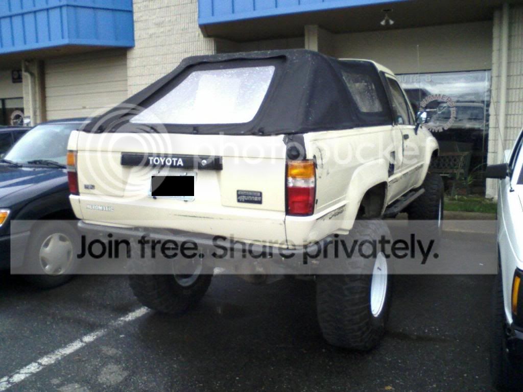

This is on my buddies 4runner. It was made by a guy who makes tops for yachts.
