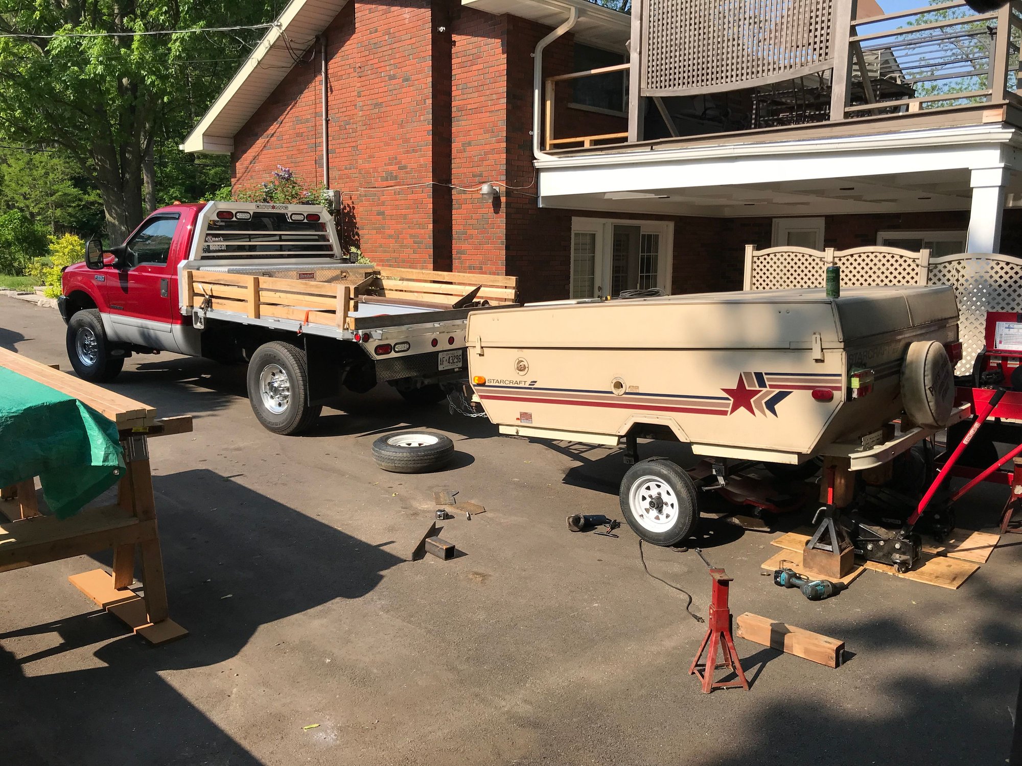

A few days after I got it home I started chopping it up. I found a used but never installed 72” 3500 lb leaf spring axle and I had a set of 5 bolt 14s and tires from a work trailer.

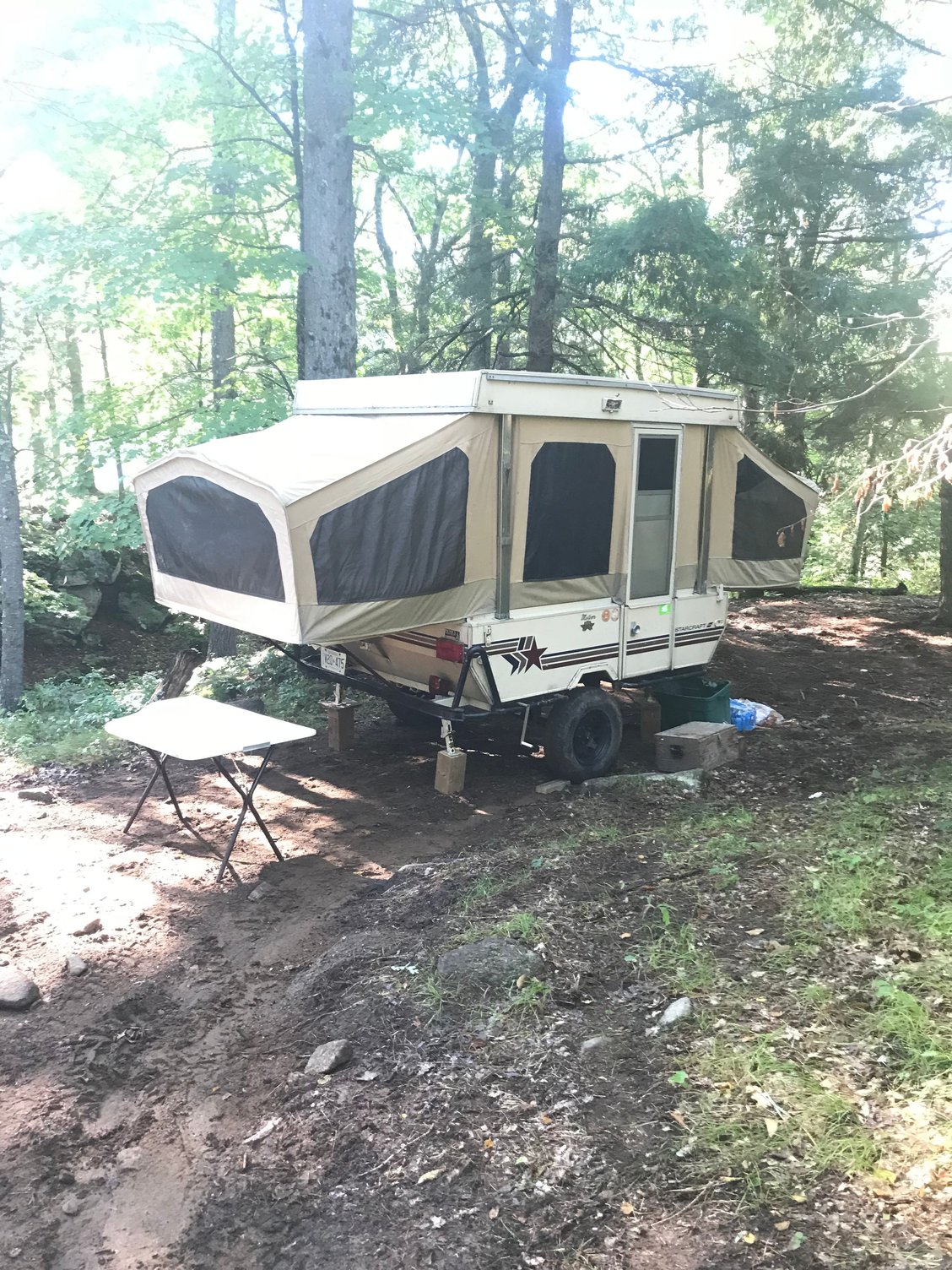

Painted her shoes black, dont love the brown canvas and body I find it makes it look old but it works for now. My wife loves it!

I knew I wanted to weld up some armor for the trailer but I was on a budget. At one of the jobs I maintain they have a big scrap pile so I picked through some light tubing that was pre bent and found what I needed. Plus I had two hoops bent up from my rear bumper on my Toyota that I used to protect the rear.

Does it seem any less stable when you're inside and its all set up?

I don’t find it any less stable. I need to get scissor jacks mounted on there instead of the spring type ones that I have because I need to use wood blocks as you can see.
But I chock the wheels and I don’t find it moves at all.

I've thought about doing exactly this for a hunting trailer, but was worried my big butt (260lbs) might tip it over if I stand on one side lol

I was wondering the same thing, but my wife and I sleep on one side and haven’t had a problem. And this is basically the shortest trailer you can get, 8 feet. Definitely wouldn’t want anything bigger if you’re hauling it through the trails.

It probably ended up being 10” of lift. The springs I used were just standard 1500lb springs
I did lift it a little bit higher than necessary because I thought eventually I would put in a 6 bolt axle and run some of my 31 inch tires with Toyota wheels. Right now they are 205-65r14 I think.
