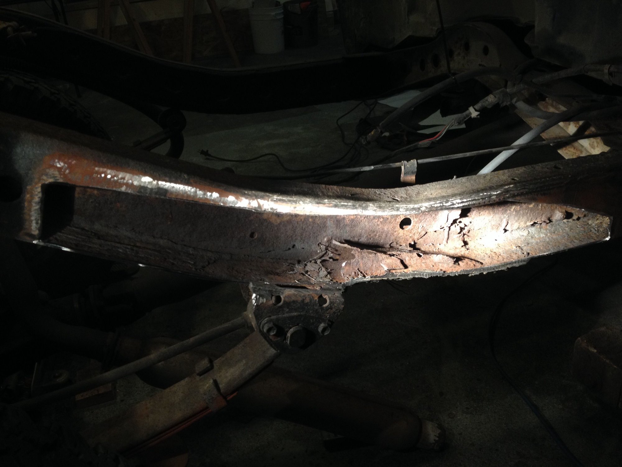

Picked up a cheap 82 and it's got a lot of frame rust. So after work I have been cutting out sections of rust to solid metal and replacing it with 1/8 steel. Then my plan it's to fish plate it.

You are doing a great job on getting that frame back into shape. Glad to see you getting another one back on the road. Welcome to Yotatech.

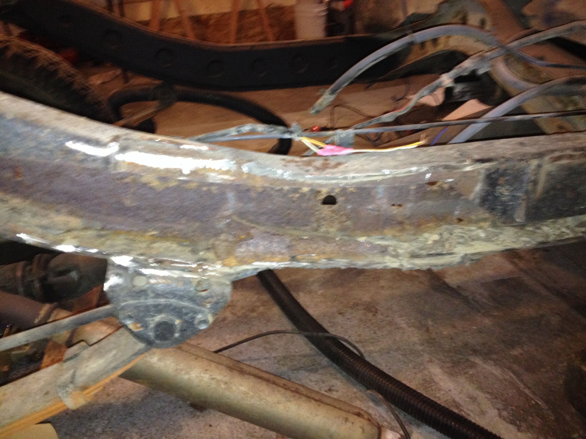

Let the fish plates begin

Almost done with one side of the frame! Man it's hard to get it done with limited time and duty cycle,

There is no reason that needs to be welded solid other then you getting carried away. Happens all the time!!
With the Plug welds A few stitch welds every few inches is more then enough for structural strength.
Quite easy to make your own spring hangers
Just goes to show any frame can be repaired if one wants to spend the time.
