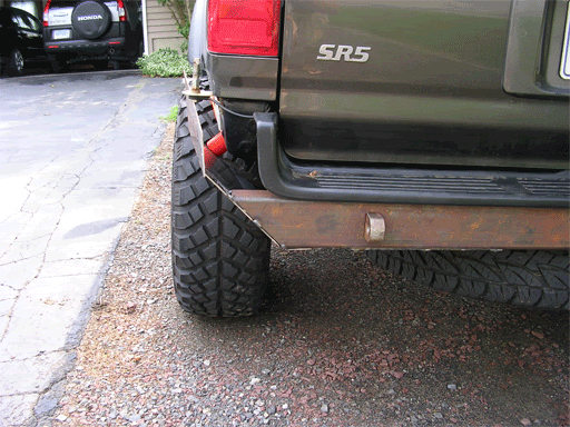

The bumper will be a mix of designs that will take parts and designs mostly from the Slee UZJ rear bumper, with a little bit of designs from BruceTS, FilthyRich, and a Rockware bumper thrown all together.
It will have a box tube for the main rear crossmember. It will be mounted to the frame similar to what Bruce did. I also don't want as much slope to the sides as Bruce has. I like the lines of the one TStango made a little better so far.

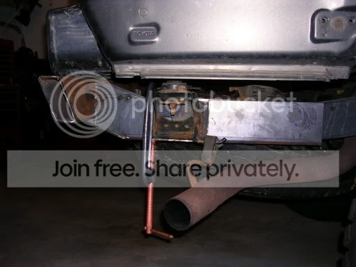

I like that a lot. Actaully makes me think twice about redesigning mine. I will be happy to post more (not fuzzy pics) for you. I can post them here or on my build up thread.

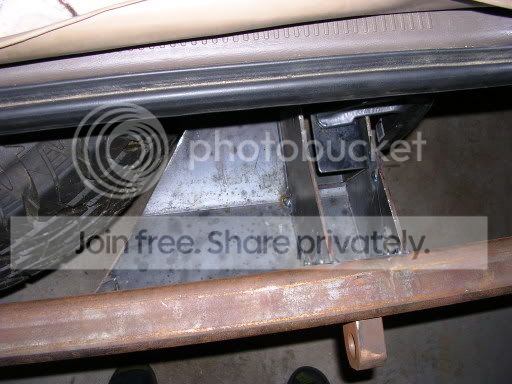

1/4" is overkill and 3/16" could be considered overkill, but since my factory trailer hitch was 3/16"(measured after powdercoat was removed). I went with it. The frame plates are 3/16" and because of the design, it is extremely strong. I've lifted my front wheels off the ground pulling out stuck vehicles with no problems. As for why I went with 1/8" was simple, I wanted my bumper to "give" during hard impacts. Attached is a photo of some damage that occured during my recent trip on the Rubicon. Driving at night I came off a ledge way too fast and landed very hard. You can see in the photo where the main tube didn't distort, but the wing caved in a bit. When this happened, the bumper did flex upwards causing the rubber weather stripping to come in contact with the body, but no damage occured, the top plate did bend downwards. I'll take a vew more photo's before I take it off to repair, which should take about an hour to do.
BTW the total weight of my bumper is between 80 and 90lb.
