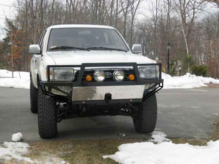

Finished
Finally got the skid plat done with a piece of 1/4" diamond plate. At first i wasn't crazy about the chrome diamond plate, but i think it actually looks pretty good.
IMG_0338.jpg?t=1201054785
IMG_0335.jpg?t=1201054841

Looks good. Came together nice. If you don't like the silver you can always paint it. I would have to see a wider, daylight shot to deceide.

here are some wide daylight shots
IMG_0339.jpg?t=1201193713
IMG_0341.jpg?t=1201193744

you should either chop off or paint the body stuff that ishanging lower on the sides, or you could put little "wings" that meet up with the tube you already have hanging out there, kinda like what the arb's have

Easier to see in the daylight. Looks good. If you just shoot the white metal with some flat black paint you won't see it and you keep the clearance. The wings also look good but I would still paint it.
