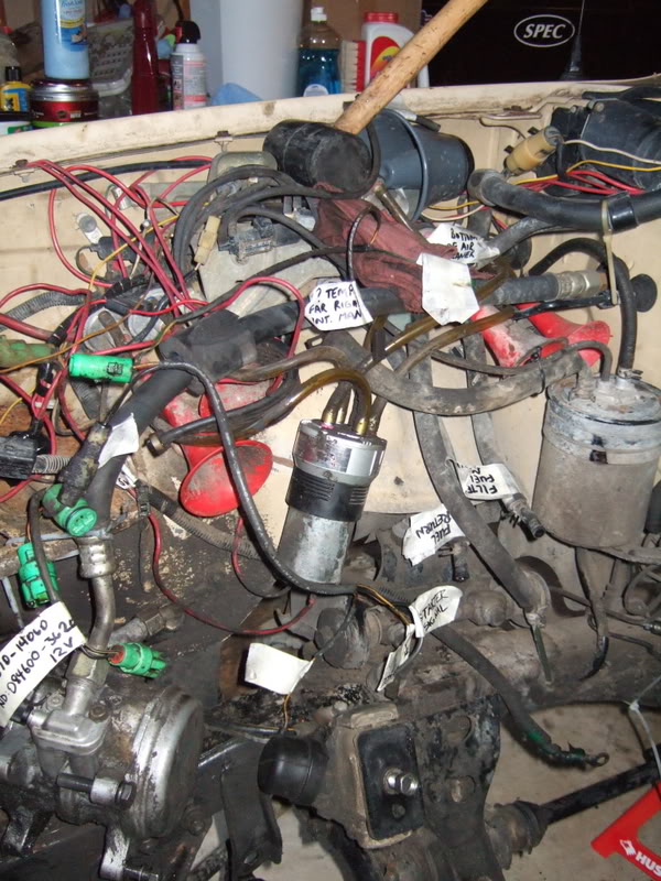

Everything labeled (bonus points if you can name that tune) :

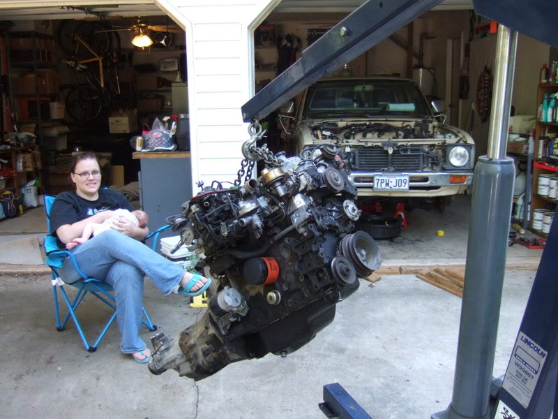

Engine out (and hungry baby) :
Casualty:

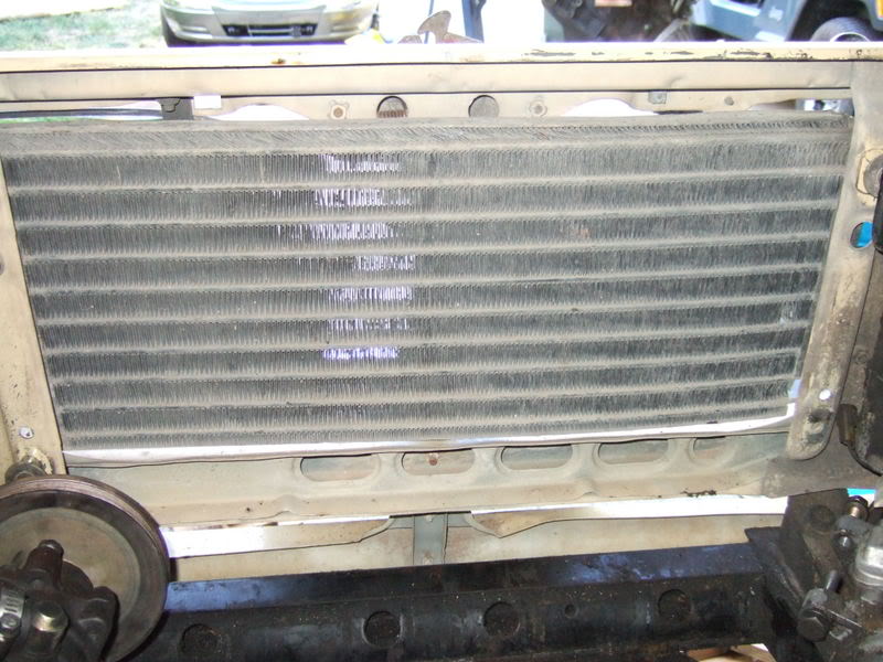

Didn't smash the condenser!

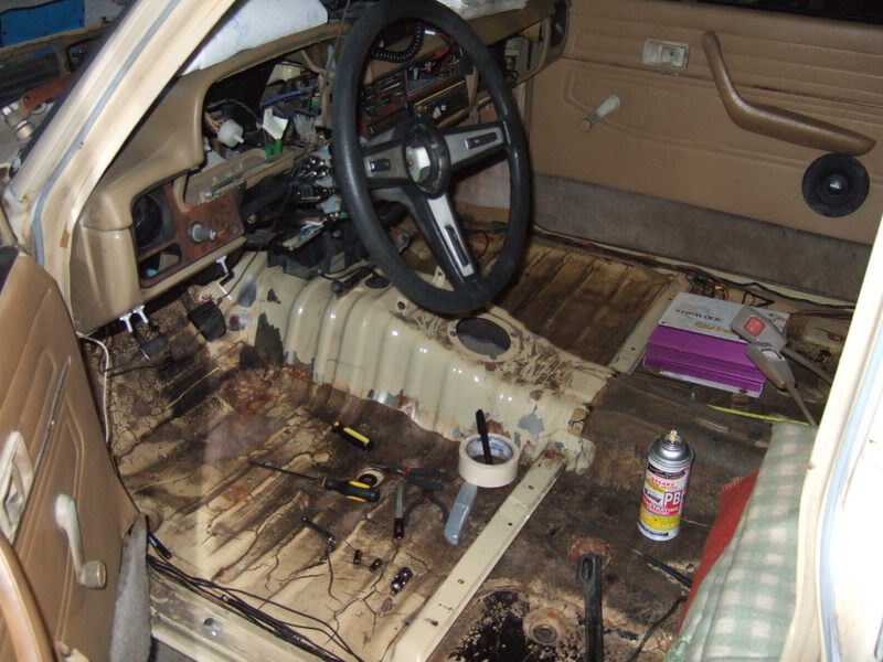

Interior in process:

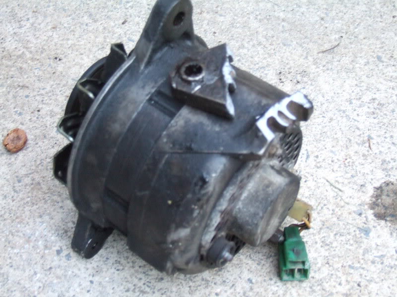

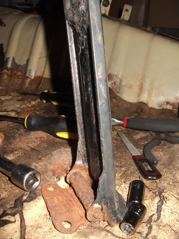

Why my throttle had been sticking:

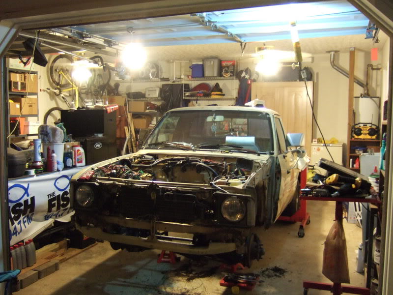

Until tomorrow....
