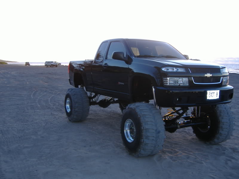

this 4 runner isnt finished yet. still needs shock hoops, driveshaft, and the other small things. beleive it or not, here in Hawaii, we do go wheling hard with our trucks, even if its lifted high. probably not as hard as you guys up there in the mainland, but....after all, we are an island.. LOL....not too much rocks out here on Oahu though, mostly mud trails and sand so i guess thats why we do it high. lol

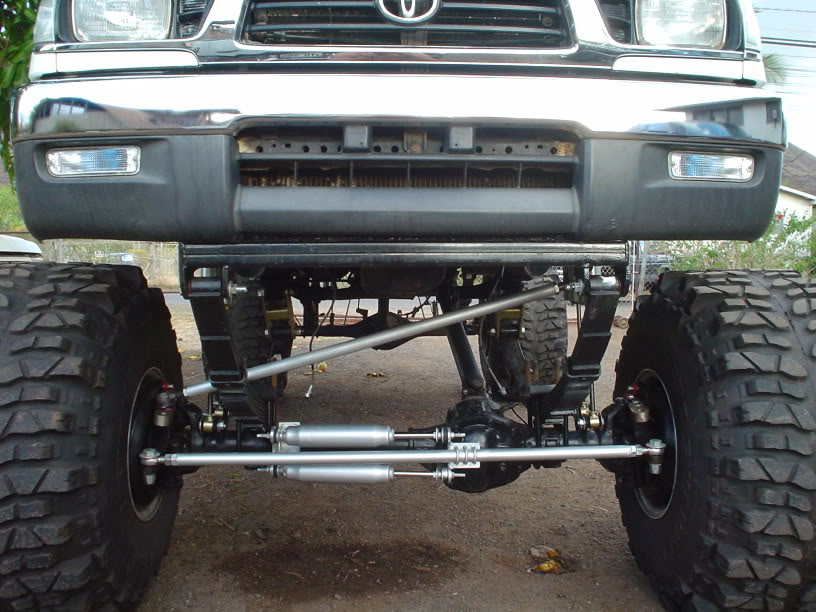

oh, BTW, heres a pics of my other friends tacoma thats finished with dana44's and a colorado that has recently been done by a friend also. hope you guys like the pics. and if you guys wanna see wheeling pics from hawaii, let me know and ill post.

That taco looks nice.
I think the Hawain trucks are a nice compromise. They are kind of a mix of the Socal "bro" truck that I see all too much of and a real crawler.
Sure, they have more shocks than needed and a few things that we feel are taboo.....but, these guys have many things that we hold dear. Solid axle swaps, good quality shocks, Big tires, and last but not least.....I bet they use them more than the ridiculously lifted full size trucks here in California. These things could actually fit on a trail.
