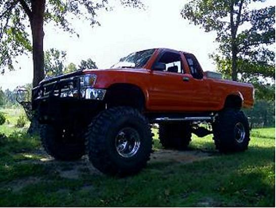

1994 ext. cab 4x4, v-6, 5-speed, k&n air cleaner, warn brush guard, 3" body lift, 6" suspension lift, rancho shocks, converted independant / torsion bar front to solid axle front with leaf springs, 5.29:1 reverse cut front with spool & high pinion, 5.29:1 rear with detroit locker, 15"x14" wide chrome rims, 1.25" wheel spacers, 15" 39.5"x18" wide tsl boggers, tow package, mp3 / cd /stereo, relocated antenea, reworked exhaust & truck nutz.
