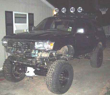

MY ass sagging SAS pictures
not broken in leaf springs + body lift that needs to come out + short rear coils = "holy ass sag batman" anyway, its not completely done yet. The shock mounts are getting welded on today. Ohh yea. . . and the guy i bought the axle from assembled the knuckles upside-down so i have to tear it apart and put it back together correctly. When you put the knuckles on wrong it points the top of your tires away from the truck instead of towards the middle like its supposed to be. Hard to tell from the picture but when i had the truck up in the air it was real obvious. And the calipers end up in the front of the axle when you do that, so yet another reason i have to flip them back to right-side-up

what is the measurements of that monster from the fenders to the ground

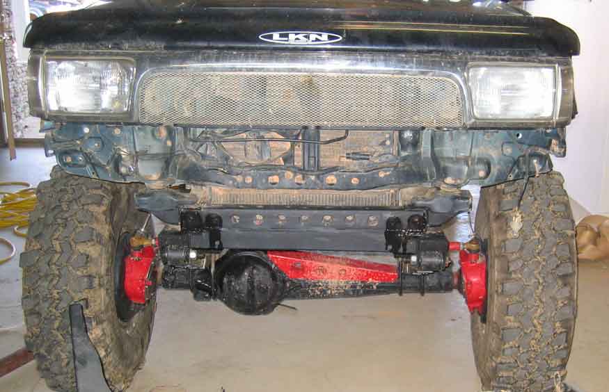

post pic of the knuckles it seems to me they are correct....... are the calibers on the back side
here is a pic of mine.......it would suck to take them apart and then reinstall backwards then have to teardown and fix again

Originally Posted by NCSU-4runner
Is your differential wearing a diaper in that pic?

there is no diff in it, trying to keep pollen/dust etc out. so i guess you could sorta call it a diaper I have a high-pinion 3rd im waiting on to get geared and locked
the knuckles are definetly upside down, the caliper mounts are on the front of the axle which is WRONG, they are supposed to be on the back. its not a terribly hard fix but annoying still

It looks good, how tall is it over stock. Did you enjoy grinding the old suspension??????

It looks like your gonna need bigger tires

Jermey showed me that last night, that is jsut crazy, he and Matt both are ass drag'n now, He has some lifted FZJ80 coils coming to level out the rear hopefully, and I think he said he was going with 35" Dunlop MTs. Hopefully after I get a 2" RB BL under the 85' I can do the same.
Jermey your rig is gona be so huge, and so bad ass after it's all said and done, just keep pluging away at it.

3in leaf springs, body lift is coming out cause i hate the sky'd look. If i coulda kept the same size and had solid axle travel i woulda left it. i have the downey coils and spacers, for a 3in total rear. I just brought the truck back to my place tonight, ill go measure it later
