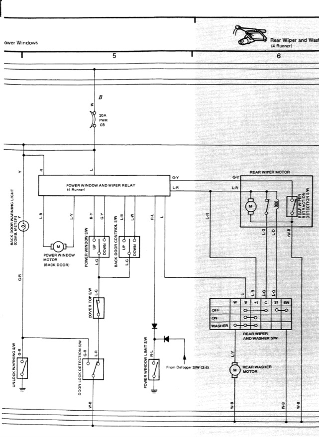

Thank you. Yotatech is a great site. I'm lost when it comes to electrical, and am having a hell of a time. I just bought a used tailgate for my 4runner, supposedly good motor for the window. Plugged everything in and nothing happens. Is there supposed to be power going to the window switch in the center console. Using a light tester with the key on I can't find a hot wire. Can get a hot wire off my ignition so in getting g a good ground. It doesn't make any noise when I hit the switch. Any suggestions. I've trolled around a few threads, top bolts are in to engage the switch, plug in the corner is hooked up. Wiper is all the way up but it been mashed up a bit.
I'm ˟˟˟˟ at electrical as well. Maybe a relay problem? I know that is common with these back windows.
Hope this helps.
