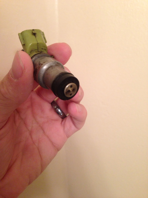

Looking at my 315cc green top injectors, it looks like it already has 4 holes. I guess there's no need for me to upgrade then?

Good morning guys. I setup a little home experiment in the kitchen this morning to see what the flow pattern of the green top 315cc injectors looks like. As you can see, it's super scientific, as I've basically just cut a hole in the top of an empty Powerade bottle, shoved a fuel injector in it, and then pushed Techron fuel system cleaner through the injector with a syringe.
What you can see is that this injector shoots two very narrow streams of liquid that, to me, do not seem to be very well atomized. I'd be very interested to see if Flame Thrower is able to post a video showing what the spray pattern of his injectors looks like. I'm thinking more and more that there probably is something to be gained with a more atomized injector spray.

they have the same 4-hole pattern that the orange injectors in the video above have. they are both of the same generation of Bosch type 3.

While it is great to test things for yourself a note on that test is that injector atomization is directly proportional to fuel pressure. Any injector tested with no fuel pressure will have bad atomization.
As a rule, the higher the pressure the better the atomization. This goes for any kind of nozzle. Like a water bottle, if you squeeze it real slow the fluid will leave in a stream/droplets. Pull it faster (aka, more pressure) and it leaves in a mist.
Those injectors that have split streams are usually designed to spray the fuel directly onto the back of the intake valve for optimal atomization as that is how the engine is tuned.
If you hooked the injector up to a fuel pump at 40psi+ it would look a bit different.
For the record his injectors work and they will have a better spray pattern, that is not up for debate. The effect said pattern will have on real world performance over a set of freshly cleaned stock injectors on the other hand is.
