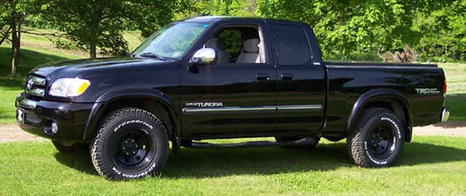

Splitz, The rims are from Wheelers Offroad. They are 16x8 with 3-3/4 inch backspace, enough to push the tire out even with the flares. They are powdercoat black, steel and heavy! I bought them used from a buddy who sold his Tundra and he had a hell of a time getting round ones! No kidding! He returned several wheels before he (I) got usable ones. Three are perfect and one you have to be careful with the tire mounting. And they have to be balanced with a lug adapter NOT the center cones. But I like them, I think they look sweet, although I don't currently run centers, I could if I'd spring the cash.
Jim,
Those do look nice!
