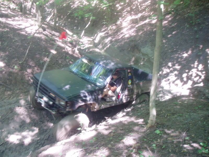

I did this to the fronts all day long without a single problem.
This just happened to be the only time i had stopped and gotten out when the tire was like this, i was harder on them in the ravines.
