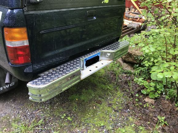

https://www.curtmfg.com/part/13086
This is the hitch I got with a coupon from Uhaul. You're right!-- I did have to drill a tiny bit for the exhaust hanger. Also, I mounted it under a Westin diamond step bumper and it fit fine and looks sharp.
Now I'm on to the headlites, grill and front bumper. The tow hitch is easy by comparison I reckon. Post a picture if you have the time.

Same bumper with the hitch.
