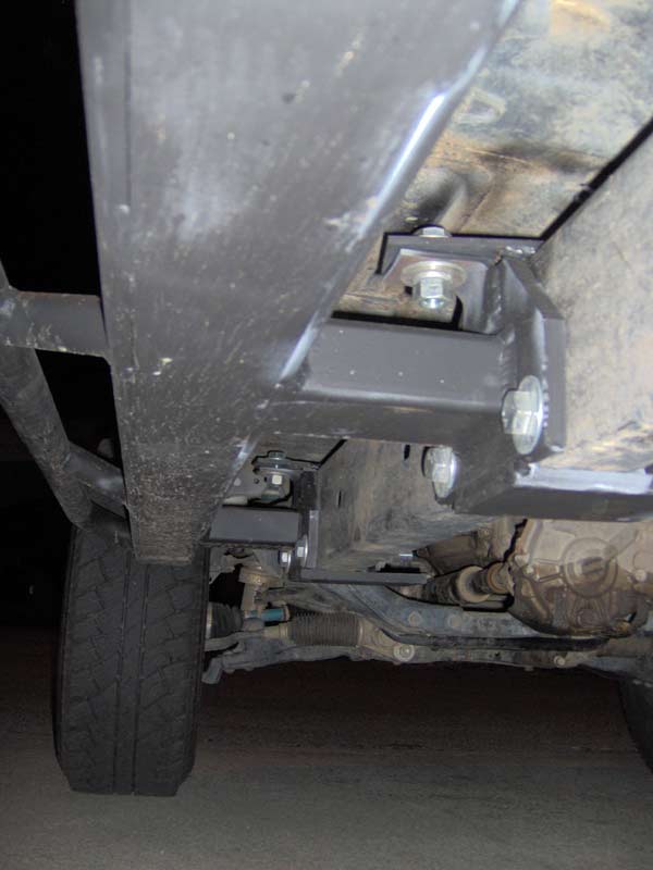

welding it is a hell of a lot easier but it also depends on design as for mine i made them from 2x4 sq tube, and theyre really heavy so i chose to make them bolt ons then i could take them off so it does slow down my truck as much, plus the way i designed mine it would have had a potential risk of warping my frame, as for me i prefer to do as little welding to my truck as possible
