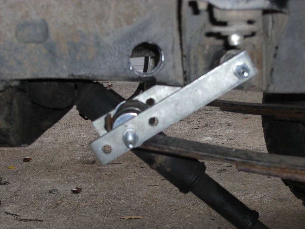

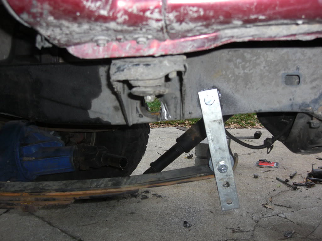

Old Mar 30, 2008 | 03:27 PM
martinpl's Avatar
Joined: Mar 2008
Posts: 36
the first one is how it was. so i moved the mount back. now the second is how it is now
sorry for the size. dont know how to resize.

TOYOTA 1's Avatar
Joined: Feb 2008
Posts: 2,799
From: oregon
what year truck is that??
Old Mar 30, 2008 | 07:20 PM
martinpl's Avatar
Joined: Mar 2008
Posts: 36
its an 89. with an 84 axle i will post a pic of the truck tomorrow.
Old Mar 31, 2008 | 10:29 PM
martinpl's Avatar
Joined: Mar 2008
Posts: 36
ok i found out how to resize. i finally got the shackle built and put the 3/4 ellp. on. hopefully this works out, if not i will be throwing somemore stuff together. i havent found out to much about it but do yall think 1 leaf would be fine for the 3/4 or should i throw another one in there.
