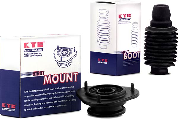

Well, here's a pic of what I was talking about. It's the thing on the left. Any and all pics that you can take would be fantastic.

Studs are integrated in to the spacer, so you won'e need that mount.

you don't need it. his spacers replaces the top plate. and depending on how much lift you're getting, it's either cornbred's gasket and then the stock coil gasket or just the stock coil gasket. followed by the coils.

my spacers didn't come with the studs on them. :wtf:

Really? Strange. I'm not sure why they would be integrated on 4Runner spacers and not on Tacos.

they should not. his new spacers uses bolts that your bolt down from the top.
