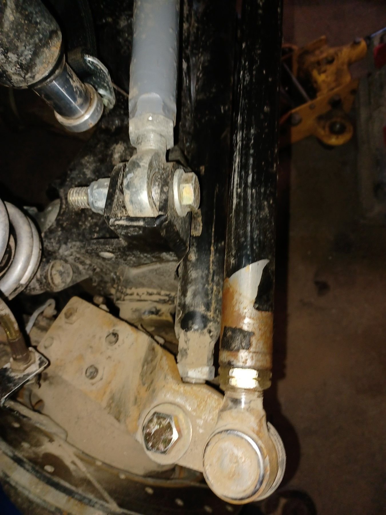

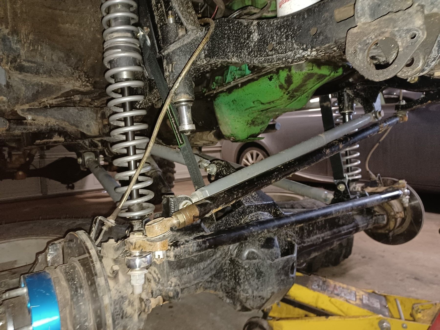

Due to installing a 4wheel Underground 3 link front suspension, I had to flip the tie rod to the underside of the arms (bored out taper bores to run hiem ends). Tie rod is interfering with diff cover a little shy of what should be full steering lock.
None of the various Mfgs of high steer arms seem to have any dimensions listed so I'm asking here: What is the distance from the centerline of the front studs to the center of your tie rod and drag link holes?
I'm hoping that someone makes arms that are a bit longer than mine. (Marlin, Allpro, FROR, etc.)
For the record, I'm running Sky's Offroad arms and measured as follows with my highly calibrated eyeball
Centerline of front studs to:
Tie Rod - 3 3/8"
Drag Link - 5 5/8"
Help a fella out and post up those numbers fellow Yotatechers!

I was messing with it a bit today and realized it's not as bad as it was before I got an alignment done a couple weeks ago (I probably had too much toe in?). I am still hitting the panhard mount and only a hair off the diff at hard right turn before I get to "max I want to turn the knuckle", but I'll live with it for now.
Offset rod ends won't work, it will definitely interfere with the castle nut for the drag link turning left.
Everything works fine, I just don't want to sacrifice any turning radius. Doing Austin Powers turns on the trail or in the rocks kinda sucks.
Building a thinner walled tie rod might net me just enough clearance. This one feels pretty overkill for my truck. It's the 3/4" rod end tire rod kit from Ruff Stuff.
All that being said, I am still interested in what the other high steer arm lengths are, especially the Marlin ones. The "bigger bearing" version makes buying new arms seem like I'm gaining more.
Anyone with Marlin arms, please slap a tape on your pass side knuckle!!
