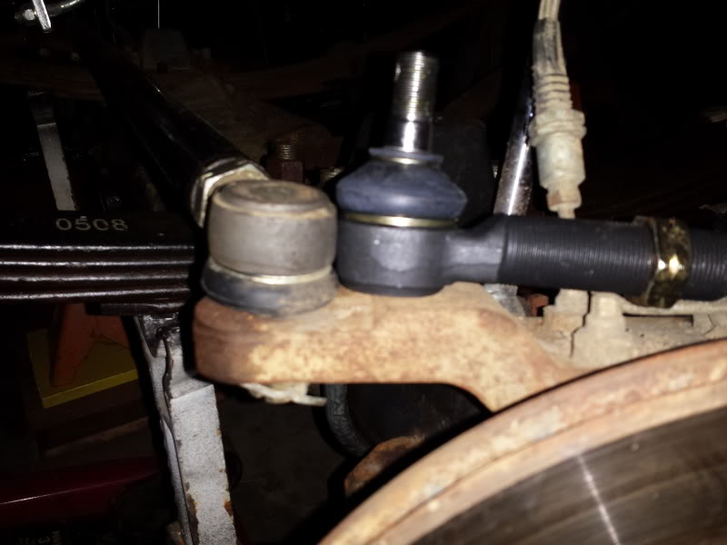

The arms are tapered for the 80 series TRE. Name:  20131008_210241_zps8f3cb11d.jpg
the steering rods are also threaded for the 80 tie rods
what rods were you gonna use?

No the T-G arms are tapered for the 80 series TRE.
Try putting a stock TRE in the trail gear arm and I bet it is smaller.
You have left and right threaded taps or just gonna cut the ends off stock tie rods and weld those to your bar stock? Or finding the correct threaded bungs?
