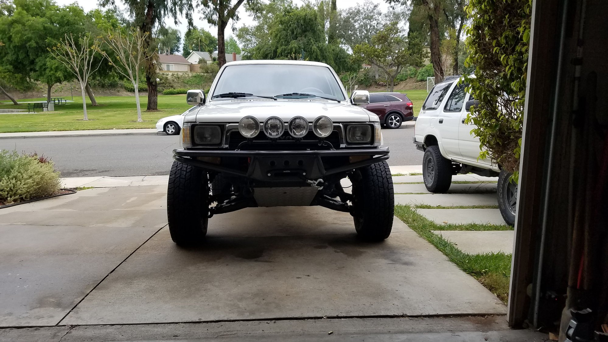

Load Capacity Comparison Stock to Blazeland with Various Torsion Bars
In my search for a suspension improvement I ran some analysis to see what was what for the front end load capacity on my 2nd gen runner. There are four pdf files attached to this response with the OEM torsion and and stock A-arms as a base line for a calculated load capacity at various ranges of the wheel travel over 8 inches. Then I did the same analysis with OME, SAW and Downey torsion bars while running modified Blazeland A-arms for the suspension with 10" of wheel travel. The holy grail is that the OEM load capacity can be almost re-created with the addition of the SAW 25mm bar with about an inch of lift over the OEM height when the A-arm are in fairly close angular proximity for a ride height setting with the addition of the Blazeland. The slight curvatures to the load capacity plots can be attributed to the foreshortening of the a-arm as it sweeps through the range of angles which make up the wheel travel of the suspension. I have OME's on my 4Runner at present with Blazeland arms and a T-100 anti role bar which is working fairly well. But I really am looking forward to installing the Sway-A-Way's when they come off back order status as that will increase the load capacity and perhaps tame the added weight from the All Pro bumper and X-Bull that are on the front end!
