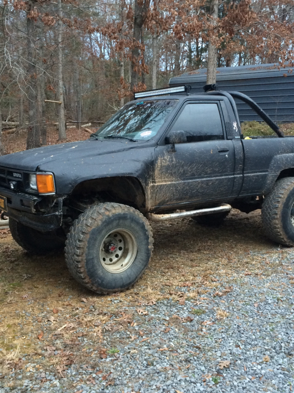

I have a 88 yota 4 inch lift on 35s needing gears bad should I run 5.29s or something different

Do you have 4:10s now? You could get away with 4:88s but... 5:29s are kind of commonplace for 35"+ tires.

Yes. go with 5.29s. Youll be very happy you did.

Yeah I have 4.10s now it was stock and I did all the lift is there a kit for front and rear that is available online?

Check out marlin crawler, trail gear, and there's others. You can get complete 3rd's already set up or just buy the parts to re-gear.

there are only a handful of companies that sell a geared, front 7.5" IFS diff, but there's at least double that which sell geared, standard 8" third members. you could buy the gears and master install kits to regear your differentials, it's up to you. for some people it is cheaper and makes more sense to buy the drop-in unit, but not all.
