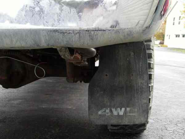

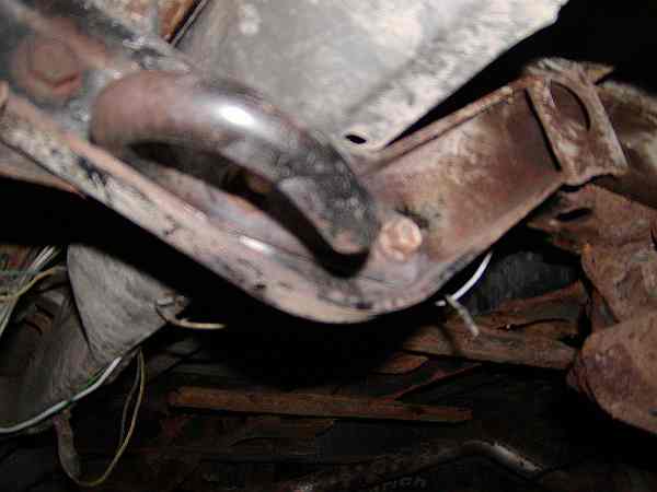

My buddy gave me some tow hooks that came from 85-93 4wd S10 Blazers and trucks. So I have no hooks in the rear of my rig but some factory ones in the front. Well most hooks are either flat, to small or really can't fit them in certain areas. Well if you are still using your factory rear c-channel bumber brackets then these will for you. I have attached 3 pictures to show you were I put them. I decided to put them on the brackets cause it is stronger and I dont have to worry about yanking on my bumper when I get stuck or go to pull someone out. They sit out of the way and can't really see them. You can get these hooks just about in any junkyard since their is abundance of these trucks in yards. All you have to do is drill two 1/2" holes. They have a plate on the other side that has two holes tapped for the bolts. These are part of the factory hooks.

Here is what it looks like:
James

Missed that one back in the day... looks good ... I'd be concerned that in a deep stuck recovery you might yank the whole bumper mount right off though... like a previous poster asked any report on how they actually worked for you if you had to use them?

I used them once pulling someone out. Did not have any issues. The truck the hooks I put them on is long gone and has been crushed by the junk yard.
