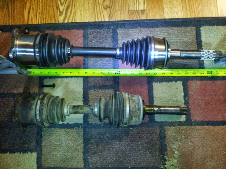

Lengths of axels are compressed.
Toyota Van cv axels: 19.75"
T100 cv axels: 24.625"
4runner cv axels: APPROX 21.625"

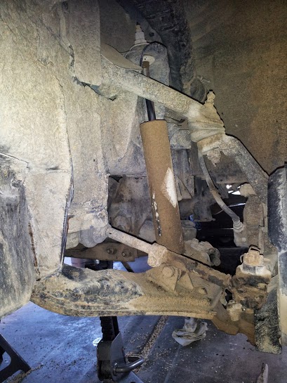

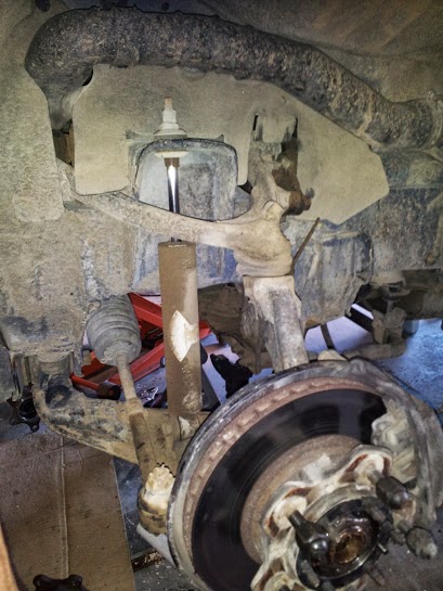

Here's My application.
I anticipate dropping the lower arm mount. To provide more range for the axel.
