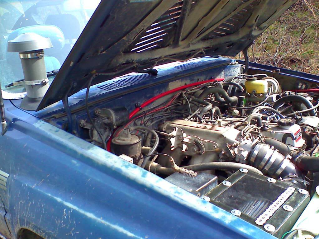

Guys, Don't hide your snorkels in shame. Show them off and be proud of them! jk
