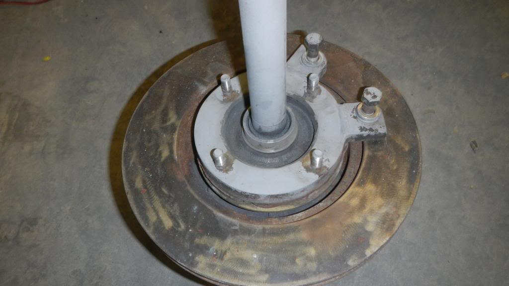

I bought some used FROR full float "chunks", with an 85 housing and ifs calipers. I have the housing ready to go, but before I bolt the chunks on I want to be sure, are there any seals or gaskets I have to put inbetween the chunk and the housing or do I just bolt them on with a bit of silicone in there?
For question #2, Are the factory aisin hubs strong enough to stand up to this much power all the time or should I be going with drive flanges?

I don't recall any gaskets there when I put mine together 4 years ago. At most I think there is an o-ring from the stock axle backing plate then add some silicone to the flange.
On the hubs, I upgraded mine to the Longfield heavy duty inner hub gear and also added FROF hub studs. I do also have a set of FJ80 drive flanges. I only run the stock engine though, but you might want to look into some flanges. There is less play in them as there are no internal moving parts.

I have pretty much the exact setup you do and the factory hubs have held up so far running stock boost, 4.56 gears and 33" tires. I put silicone on those surfaces and it hasn't leaked so far (8k miles).
