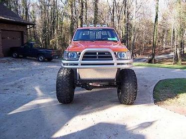

i recently performed a SAS swap on my 87' p/u using all-poo off road 6 inch front springs. This was performed in july this year... the springs settled and were doing great, until about 2 weeks ago when i noticed my truck leaning. BEst friend tells me truck is leaning and dog-trotting while driving down the road. So now my passenger side front end sits 3 1/2 inches lower than my right it is horrible, the arch on the spring is gone, i mean i can understand a slight difference of an inch or so... but i need some help. i plan on calling allpro and explaining the problem... but honestly i really don;t want to just get another... what about switching to 44044 rancho springs.. anyone know how much lift these offer, or length.. stiffness??

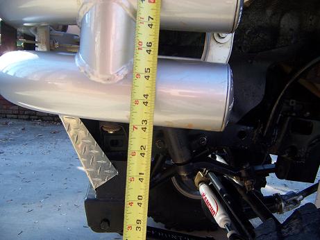

thanks for the help... i am gettin pics right now... but yes the bumbstops ... the spring isn't even completly flexed before the shock bottoms out, i took my dad's bob cat and flexed the front out until at full turn inside the tire rubbed the inner fender... then measured for the shock mounts that i got from sky's ord... then for shock placement... so now the shock bottoms out at full tuck, and made bumpstops out of polyurathane bumpstops for a 98' dodge "my brothers" which i had laying around. So it couldn't possibly be that i over flexed these. And this morning i ran up to Abernethy's shop to get it on the lift, and check my Geometry. The center of the bong is exactly 1/32 farther back than the driver's side when meseured off the front spring hangar, which isn't enough to make any difference i don;t believe. Thanks again for the help...

Attached Thumbnails HELP... 6" allpro spring collapse!!-100_0990.jpg   HELP... 6" allpro spring collapse!!-100_0991.jpg   HELP... 6" allpro spring collapse!!-100_0992.jpg

Can you get a pic of what each shackle and each end of the spring looks like on the passenger side?
