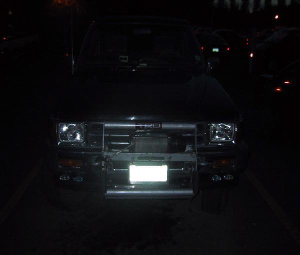

Well phaze 2 is complete...the winch has been rebuilt, new brushes installed, completely stripped and repainted.
Today with the help of a friend I got it remounted.
Next is the in cab controls which I am working on tonight and the custom cable controller that I am going to work on tomorrow and then wire it up.
Attatched is the picture of the winch when I got it.
