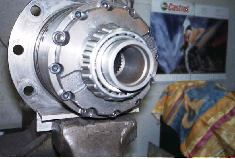

I'm off roading a few years now and bougt one of the first airlockers available several years ago. When you look at the unit you see it has two main halves. On one of them is a large ring which the ring gear attaches to. I believe with 10 M10x1.25 bolts with 10.9 grade. The other half of the housing attaches with only 4 M8 x 10,9 bolts and on a smaller diameter, so higher torque and less, smaller bolts. So if in use, 100% lock I mean, and used with a high torque turbodiesel and 33's it's quit easy to sheer if the 4 M8 bolts and the unit breaks in half!
It happened to me once and also to at least 3 people I know.
Her's a pic of my solution. Just add more bolts. The newer air lockers allready have more bolts standerd.
The OEM unit is much stronger than the ARB carrier. It also uses large bearings.
My lockers don't break anymore. But I still have to find a solution for the R&P failure I allways seem to have. I've destroyed 3 8" front, 7 8" rear and 1 8" high pinion R&P. Maybe it's time for a FJ80 rear axle with OEM locker?

The "older" ARB and R&P's must have been modified in France as I've never heard of an ARB breaking in half on this side of the Pond.
