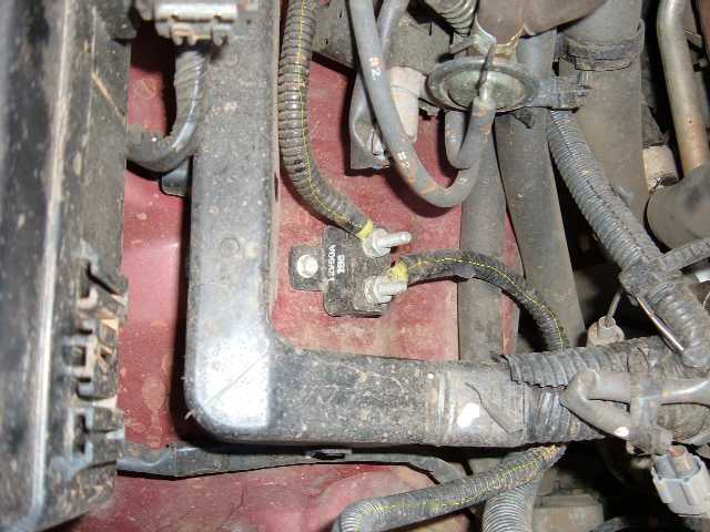

i bought this truck about 1 1/2 yrs ago, and the previous owner had done some wiring to it, i finallly got around to checking it out and was thinking about hooking up a battery or two any advice on the setup that is in there? does it look ok or do i need to modify it? it is a pickup and the wires lead to the bed of the truck, i was thinking of putting them into my truck
box. the yellow wire in the pics is positive and the green is negative, i have taken a pic of as many components as i can see.
thanks for all your help.........
