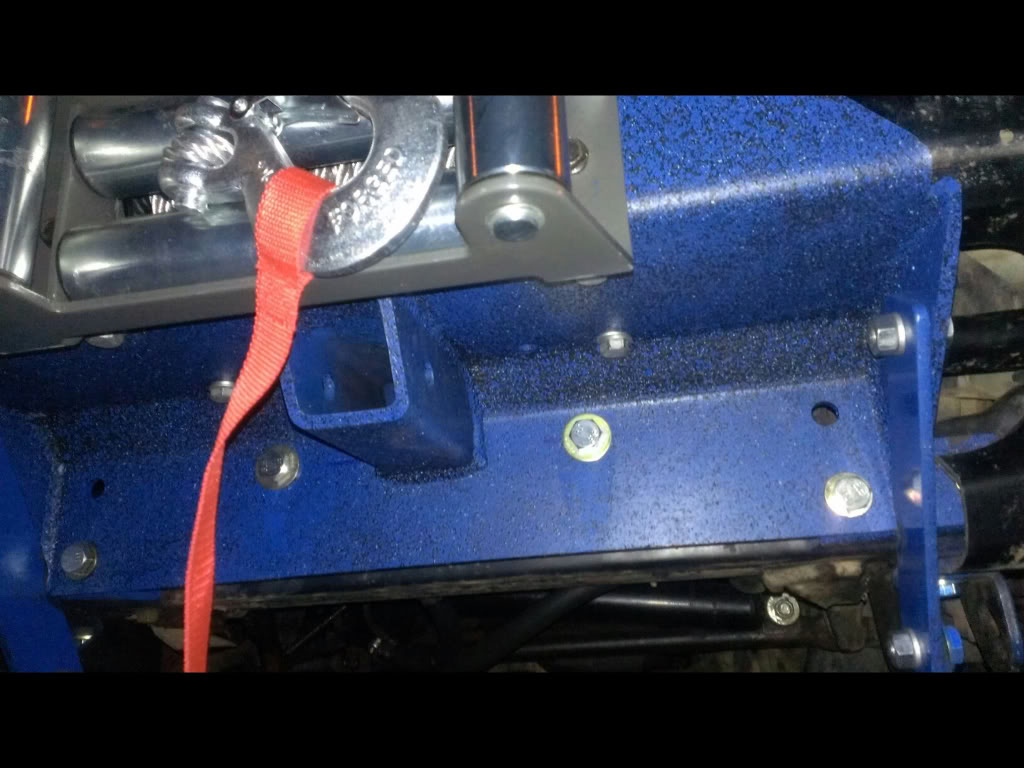

Don't know if this help.but this is how I did my winch Mount.I added some side mounts. For more Support.

^ is that the only mounting spot or is there more? (sorry im new to this)
