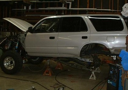

Just step it up some (see attached)
Attached Thumbnails Different kind of suspension question...-prerunner4runner1.jpg   Different kind of suspension question...-prerunner4runner21.jpg   Different kind of suspension question...-prerunner4runner4.jpg

In all seriousness yes you can achieve what described.
Getting new shocks (resevoir shocks ie king, sway a way, fox) and getting them valved for your 4runner would be a huge improvment. These resevoir shocks are night and day compared to say, bilstein 5100 or 5150 series, rancho, fabtech, procomp shocks. Definetly worth the money.
Next thing you could do Is maximize the travel you have now. Note..without putting any strain or excessive angles on compents such as steering etc... Get better bumpstops and maybe even get some limit straps to stop the harsh dropping out of the suspension. Get good straps like beard, pyrotech, etc NOT procomp shoe lace limit straps.
Another thing is to remove the front sway bar...this will make your suspension truely independent but will sacrifice body stability. Maybe look into getting a detachable sway bar setup for offroad, this way you wont get the body roll on road.
All these things mentioned will really help with on highway and off highway ride!
