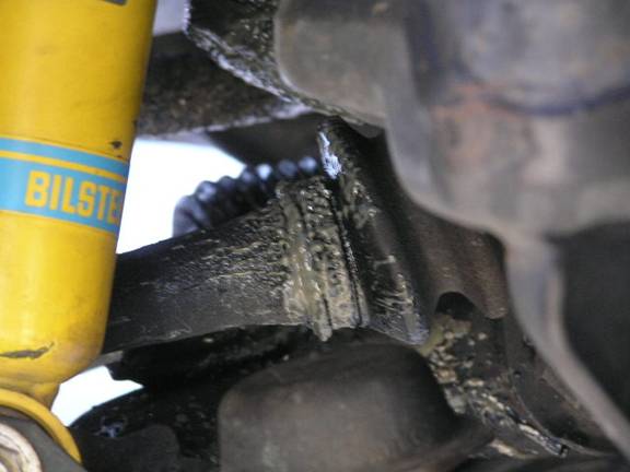

My CV boots are now throwing grease after I got my Cornfed spacers installed...It's quite a bit of grease actually. Not sure what I should do about it...
I've attached some pics to show whats goin on.

Common problem...zip ties or hose clamp. Try searching.

I had the same issue... not as much grease came out though... I pryed off the stock clamps... Wiped it down and used a hose clamp...

Clean it with a rag and get some hose clamps. Careful with the clamps though, I'd think that the edges might want to cut into the rubber...

I 2nd the diff drop and they make clamps without the slits in them to cut into the rubber.

Well, your cv boots were spinning at one height for the last 6 years (assuming they haven't been changed yet), and now they are at a new angle. I would imagine the rubber may have tiny stress cracks, or like others have said, the clamp is loose. I would suggest just replacing the boots, and make sure the clamps are tight before you put the cv axle back in, it's a cheap fix.

And, if you decide to replace the boots (seconded btw!) then get the replacement kit from the dealer. They're like $40 (per side), come with inner and outter boots and the correct grease for each.
