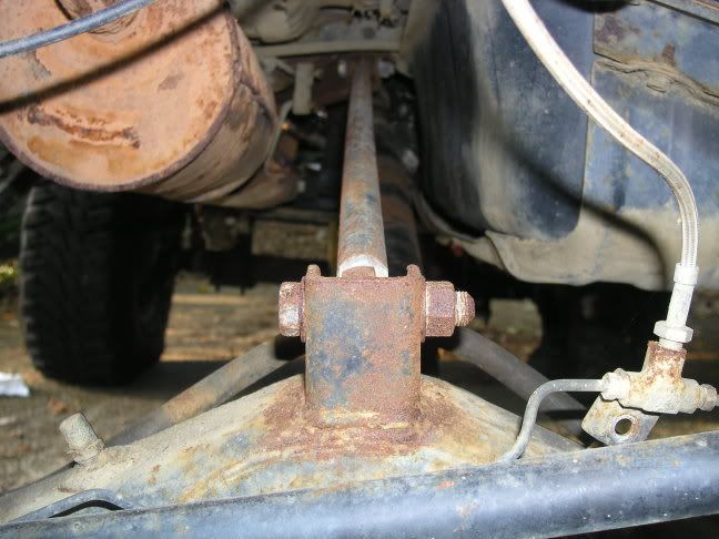

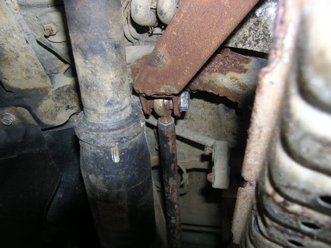

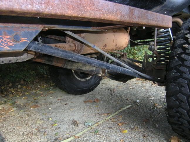

Although some of the problem with the links is twisting and breaking off the axle housing, another major problem is the overal length of the link. If you plan on doing much lift at all and on top of that wanting your rear to flex with the sas'd front, you're going to want to lengthen your links. On my 4runner they are lengthened to about 42 inches witht he new mounts being on the bottom of the axle housing and on the frame below the rear doors. you can see in the picture the stock link location compared to the new ones.
another thing you may want to consider is a 3rd link in the middle of the axle, welded to the top of the dif and to a custom mount somewhere behind the transfer case.
im not saying the all pro links wont help, but this is most likely the best route. Takes some time and money, but will save plenty of headache

90 have you had any problems with the long upper link? It looks mighty thin for the length.

its about 8inches above stock. the rear coils are rustys jeep 9inch lift coils, the added weight of the runner give it about 8inch of lift. i forget what grade steel the center link is, but tis pretty beefy, never had any problems with it and the trucks been flexed enough that the truck lifted off one of the springs while the other was fully compressed. the springs arent conected to the frame by any means, they ride and steel piping wleded to the frame.
