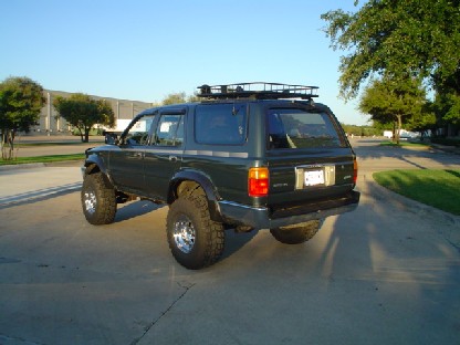

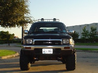

The OME 901HD in fact will raise it 1.5" over Factory Stock Springs. In my Avatar you can see my '91 with OME901HD springs and 33's on it. Here is the kits we sell.
https://www.yotatech.com/forums/show...96&postcount=1
Mine has Option 2 and the picture makes it look like it still sags but it is level.
Hope this helps....................
I'd like to use Rancho RS9000X Shocks. How much for just the BJ spacer and the coils shipped to 30534?
Do you have any larger pictures you could post of your rig?
