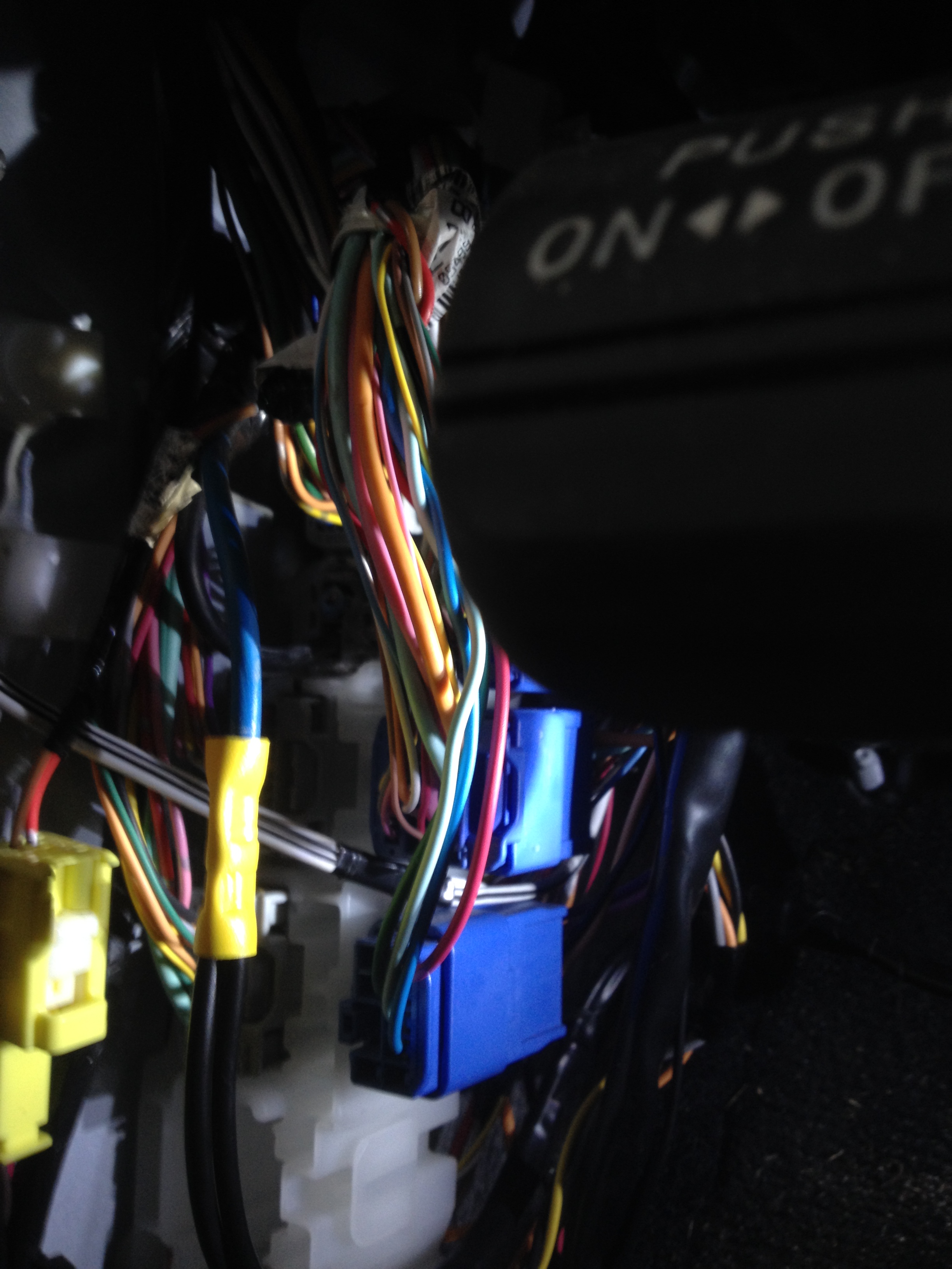

Fan problems fixed. Again blue wire was dead at fan -- fusible link was good under hood. Traced wires back to connector on driver's side. Connector must have got hot and was fused together. Tried to separate without success. Ended up cutting wire and joining direct.
All works now. Strange issue for a 2008. Toyota has these connector hub on bother driver and passenger side (pic included) -- must be how they manufacture - can be done in stages.

added pic
