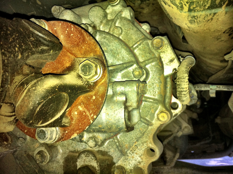

Old Sep 10, 2011 | 12:06 PM
Brule's Avatar
Joined: Sep 2011
Posts: 3
As you can see, I am looking at a different set of hoses here - any suggestions?
Thanks,
Old Sep 10, 2011 | 12:18 PM
scuba's Avatar
Joined: Jan 2008
Posts: 11,338
Likes: 120
From: Austin, Texas
Thats odd.
Check out the FSM for the exact location of the speed sensor
http://www.ncttora.com/FSM/00-03-Tun...Tundra_FSM.pdf
