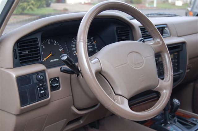

All 80 series have a center locking differential (91-92 have a switch, 93+ are automatic when put in 4lo, no switch), the FZJ80 from 93-97 had a front/rear electric locker as an OEM option. The front/rear locker switch is a rotary dial to the left of the steering wheel, on the dash.
