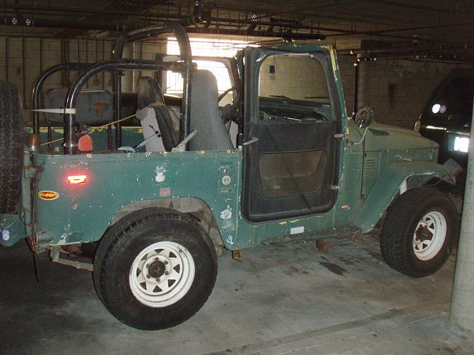

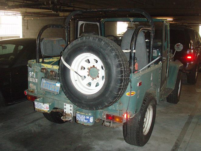

Well the truck is home...but It still requires gas being poured into the carb to fire up. Fuel filter seems clean and it runs like a champ once it starts. I was thinking of maybe using some Seafoam maybe because the carb is gummed up. Make sense? Any other advice?
