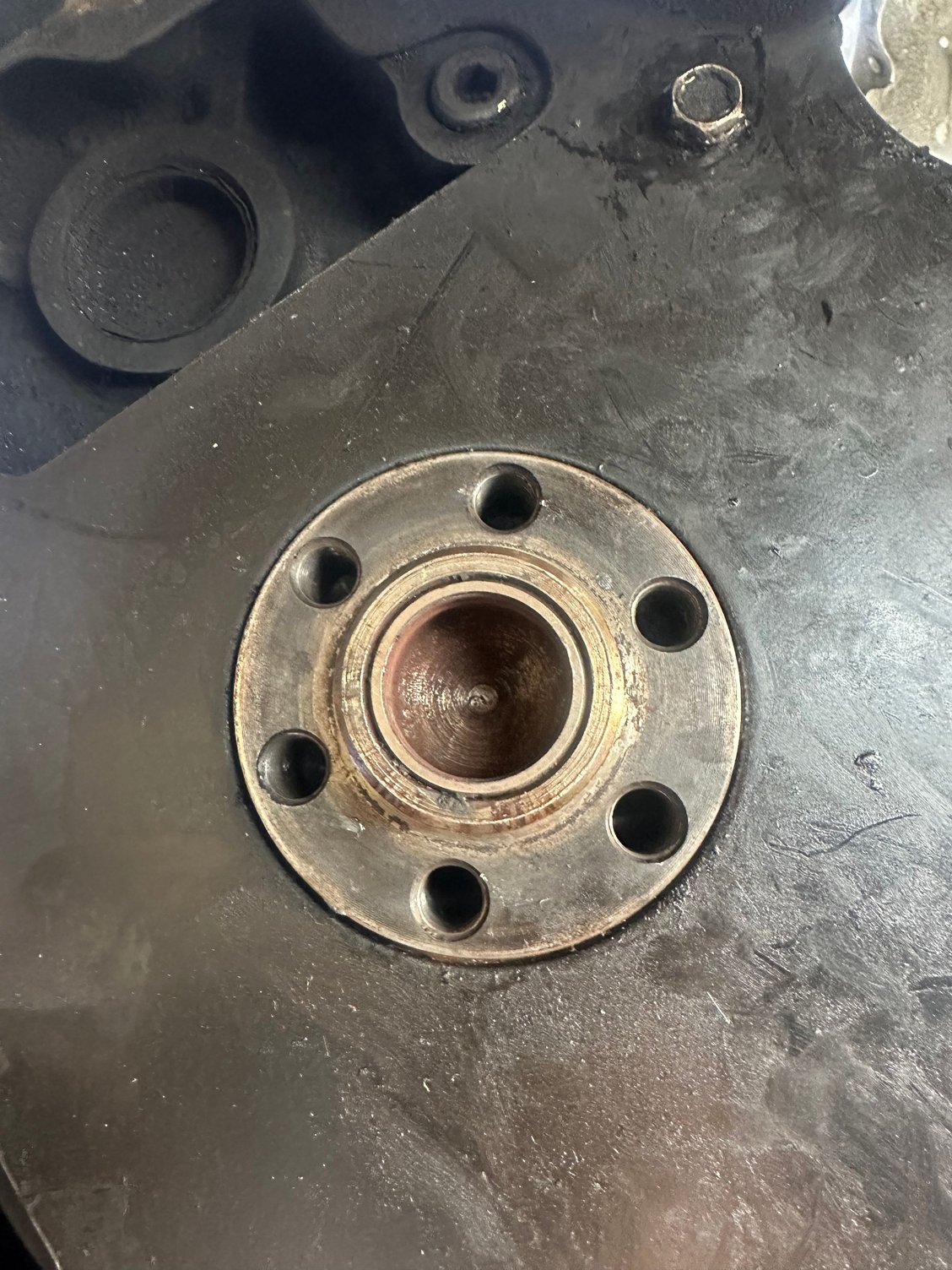

Hey y’all, so I’m installing a new clutch on my 92 pickup and when I took everything apart I noticed there was no pilot bearing. The clutch kit came with a pilot bearing but doesn’t fit, it’s too big. Anyone know the correct size pilot bearing??

Looks to me like the outer race from the old bearing is still in the end of the crankshaft.

Both the 4cyl and v6 use the same size pilot bearing. Rock auto says the factory bearing size is 12mm ID center hole, 32mm OD with a with of 10mm.
what size is the bearing you have? What brand clutch kit?
